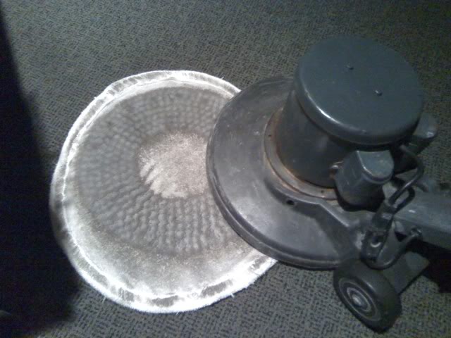

Dirty and Abused Olefin and Nylon Glue downs.
Cleaning Step One.
Pre vac the hell out of all areas. Pay attention to entry areas, pivot points and around plastic chair runners.
and get up the cob webs paper clips and dingle berry from under the computer cords and cables.
Two.
Pre spray with a well formulated juice that contains a degreaser and some peroxide. Don't soak the carpet two light passes with a HF will do. and scrub it in with a broken in REd Fiber pad and your 175.
Three.
Use a pimped out TM with as much 2.5 hose as possible. Ditch the 1.5 pussy whip.A 2" wand with four to 6 jets and a glide is the most effective way to wow them. Those RDMs and Rx 20 do clean up against walls and under desks for squat.
Four.
Dry stroke till you puke.
Five.
Most important step. Use that same 175 and some cotton or cotton blend PADS to go over and over the heavy traffic areas until you once again puke. No matter what pre spray you used or what toxic rinse you purged it with you'll be amazed at what is still hiding down there.
By post padding heavily used CGD you'll pull up soil that no single method alone can get up. You'll run into some areas that will never come clean. Use at least six sides in those areas.
Creating Michelins is the insiders name for this step. use both sides of the pad.
Hurby, Vac A Way and Guerkink have these pads for sale
Six.
Use an Airpath if you have one.

"Don't soak the carpet two light passes with a HF will do"
Isn't that statement an oxymoron? HF are soakers.I haven't used one in years,wastes too much water as well as product.
#2: A dampened op pad works just as well if not better because you are actually picking up soil.
#3 is optional,not necessary.
Other than that,your post is old school but on the money.

My wife and tool are just fine thank you.If you have to get a light mist then obviously the your tool is putting out too much.
HF and electric sprayers are like everything else,tools that are subject to opinion.A hf is definitely more convenient but in comparing both on the same job,in the same rooms, quite a few years ago, I noticed that there was no dramatic difference in the level of clean.
More does not always equal better.
