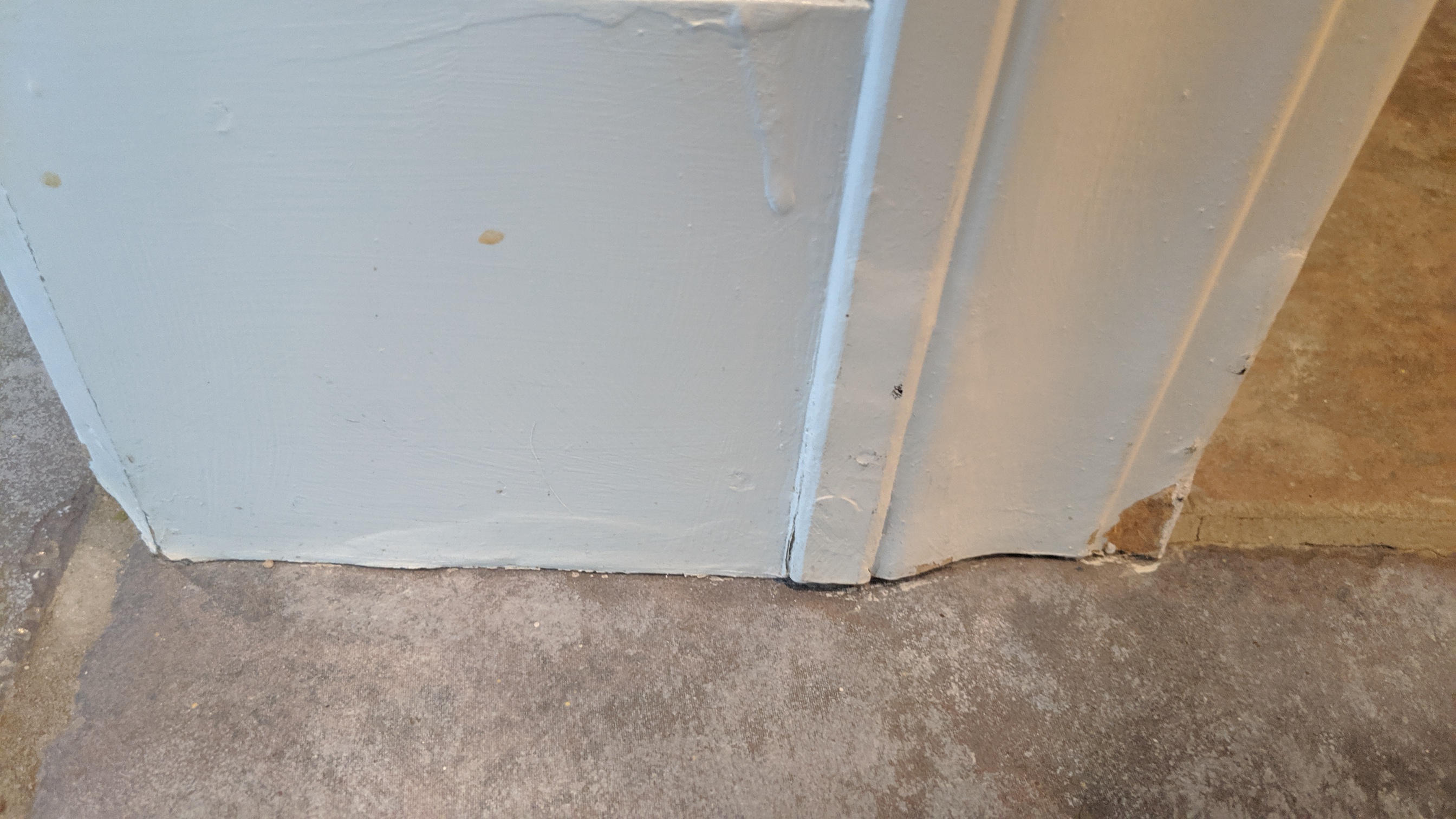

Swollen MDF Baseboards

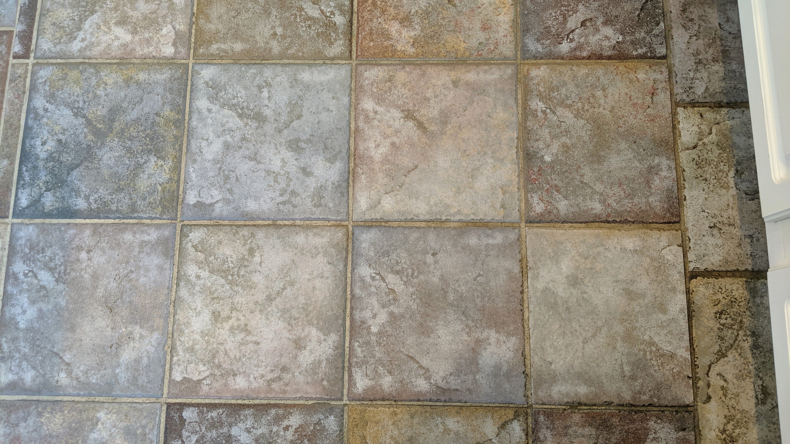

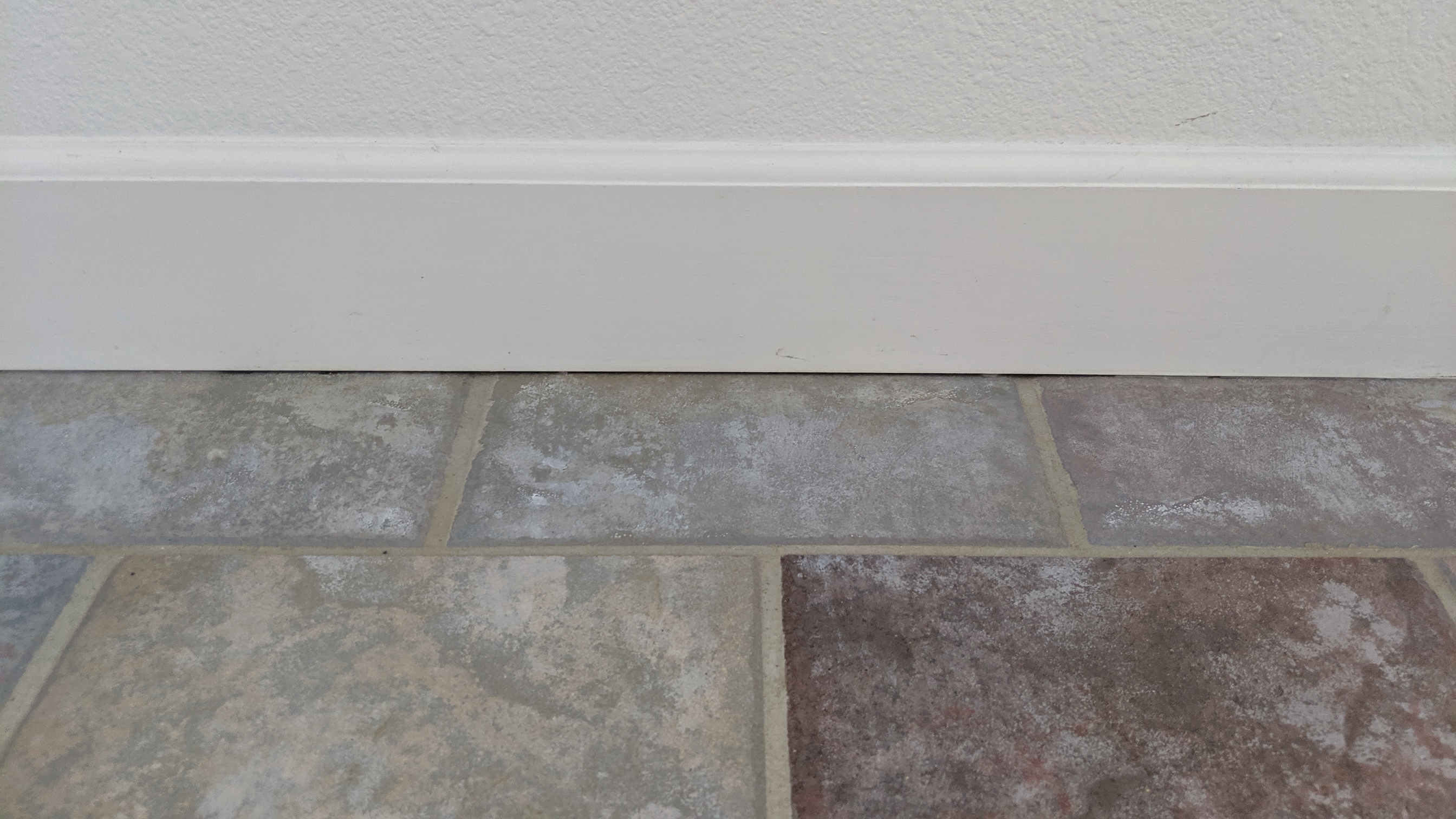

take a look at this picture,

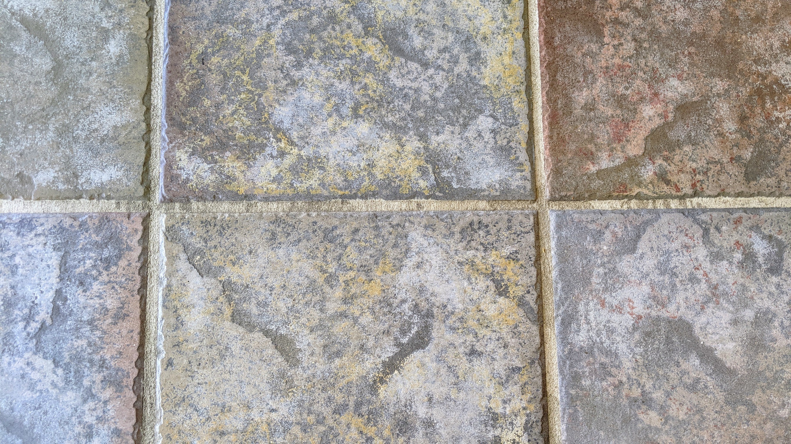

this is after I cleaned the grout with just stripper by hand. One layer of some crap product was removed leaving behind at least two other colorseals, which neatly enough creates a very cool faux mottled look that actually works well with this tile...
so my next visit will be to apply clear silicone under the baseboards..
then in two days I'll return to clean the heck out of the floor with a stripper.
if the topical comes off in the process, that's a free perk, at their age they can't see it. They just want the grout clean looking.....
this is all they see... fugly grout.. IMG_20190806_142352.jpg IMG_20190806_140836.jpg

doubt it has been color sealed, if they were that bad there would signs on edges of the tile. looks more like natural grout shading and/or the coating sealer turning white
