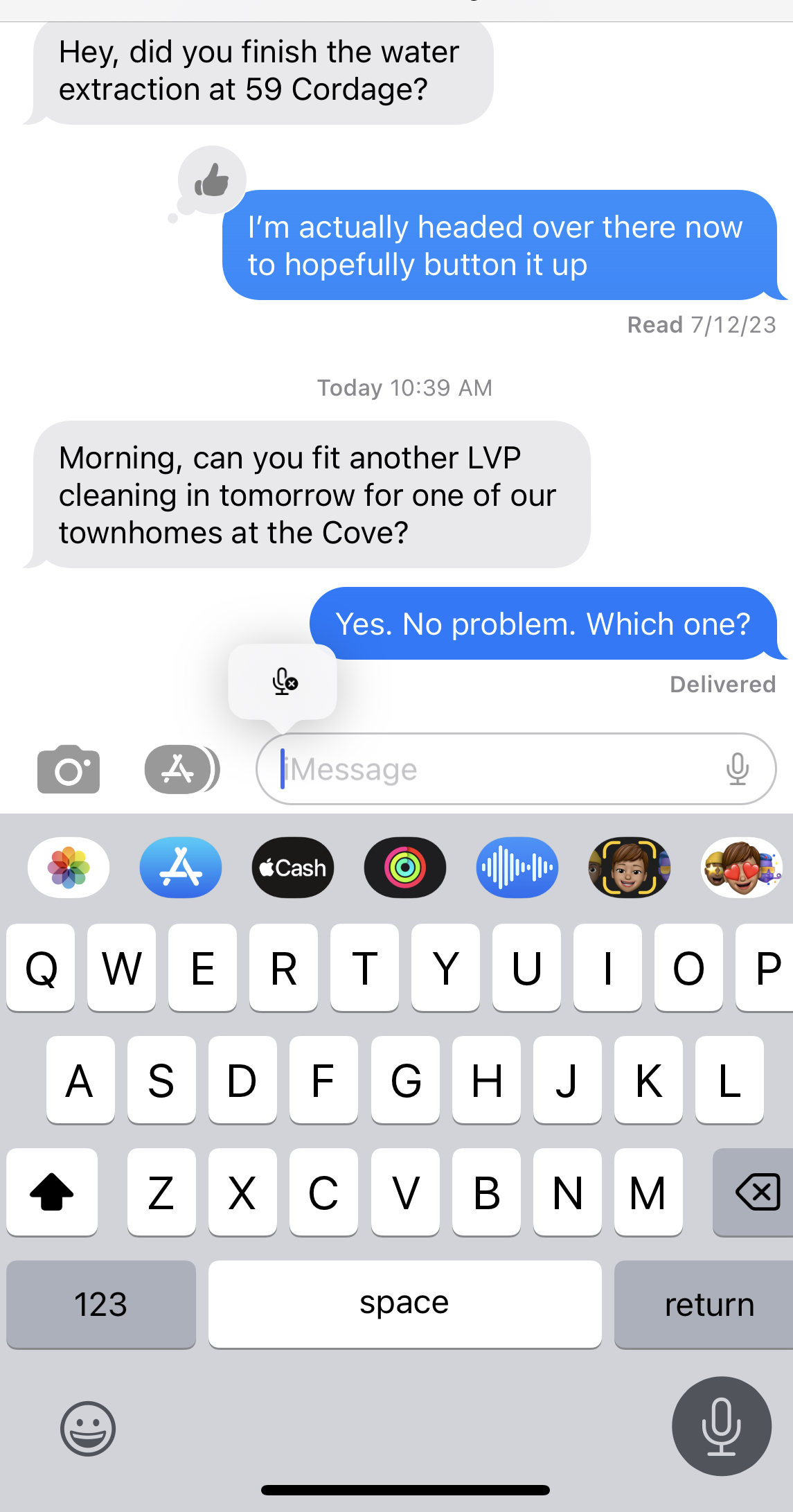

These PM’s are starting to get hooked on this Brush Glide

Haha. No thanks. I not sure this thing will ever wear out. You should’ve charged more for it.
