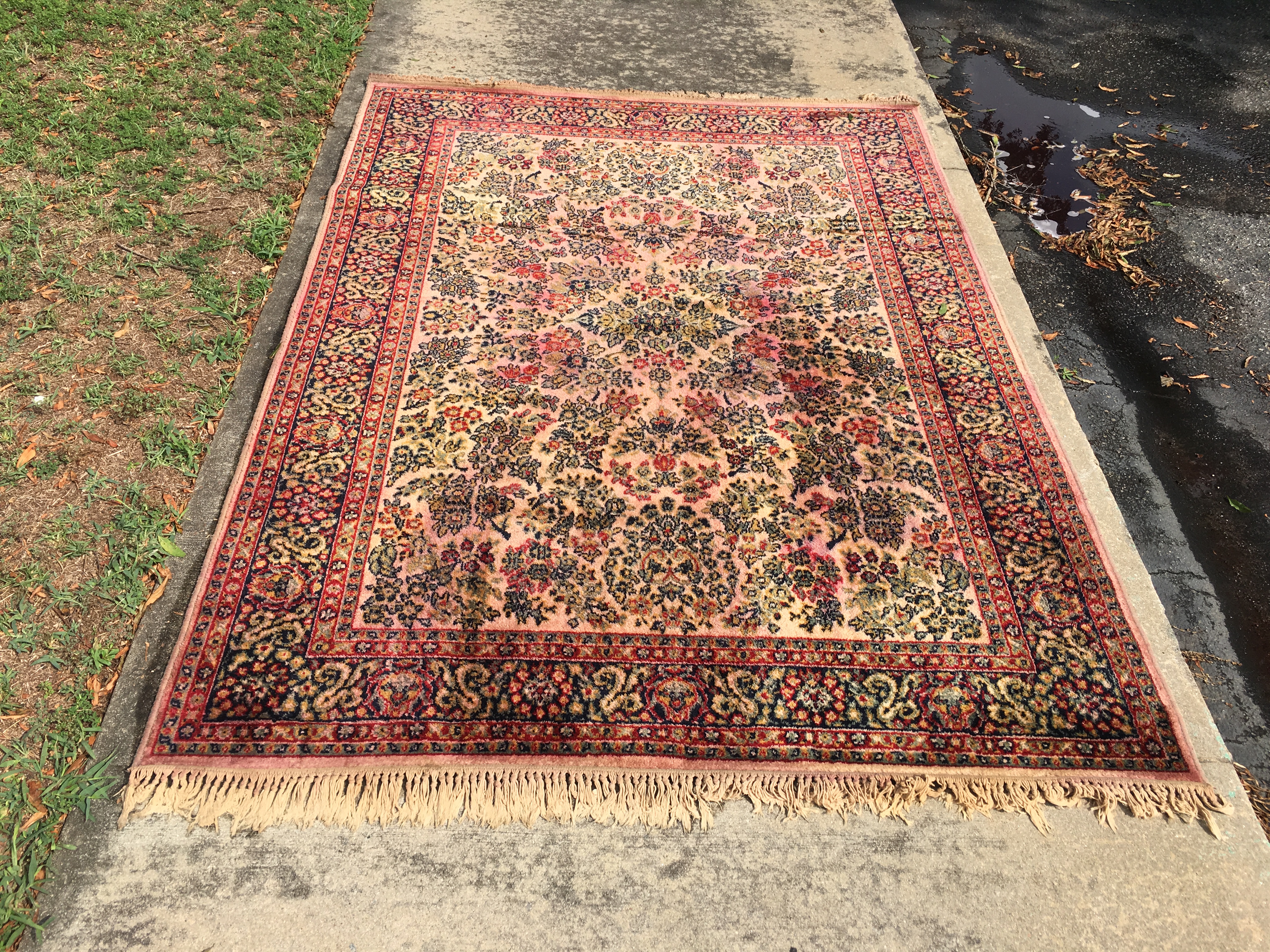

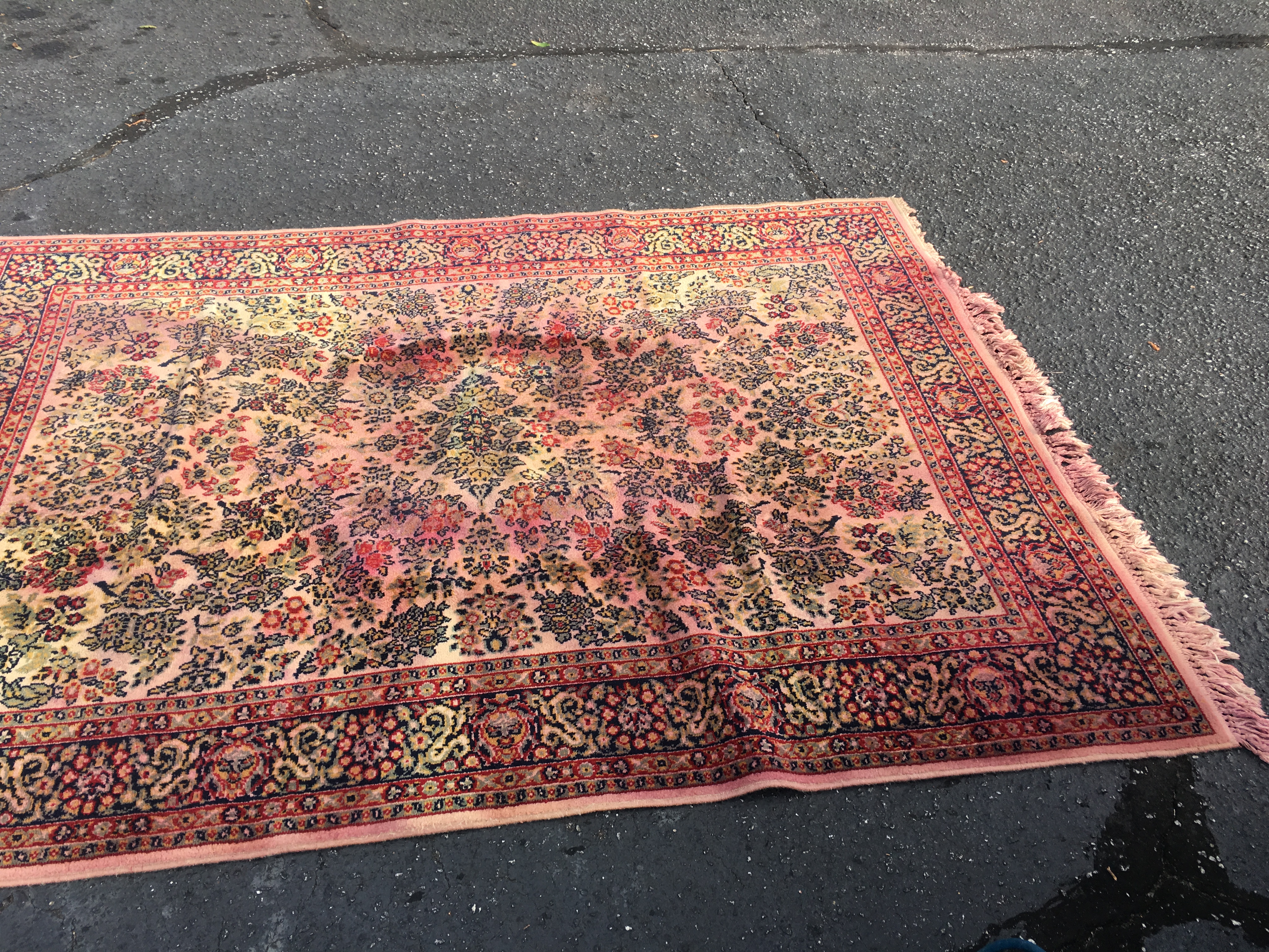

They throw this in front of you and you have 30min to clean it
14,129
What would be your steps? I cleaned it and I want to see if my steps were the same as you driveway rug suckers
I gave myself 30min because I knew he couldn’t pay a rug shop price at this govt apartment I cleaned at today.
E2456C35-7AE0-4306-A0E2-12A4D7FA7318.jpeg 000C896D-614B-46E5-A7B7-E0772733D882.jpeg

You're not going to get the dye bleed out. Nobody is going to get it out, period. Especially on a budget. I usually advise customers to put their trash in the trash.
Don't forget the type of place I was at. Budget government apartments. They just want their place to be unique from all the other apartments around. He asked me if I could do anything to make it better and I told him I'd try but I won't work any miracles nor make it look new again.
14,129
The whole rug looks brighter, even though there is a pink around the border still, and the fringe is back to normal

If I seriously wanted to improve it in a driveway
prespray heavy with a not safe for wool prespray (still wouldnt go nuclear)
175 it (it will bleed more)
pressure wash/blast it until it looks "ok with your good eye closed" then dry stroke

Oh I see now my brother. Looks great. Have a blessed day.
Once again, I only gave myself 30min on this rug for a reason. I had 5 other jobs after this one today. I think it would've looked much better, had it flushed it for an hour later.
