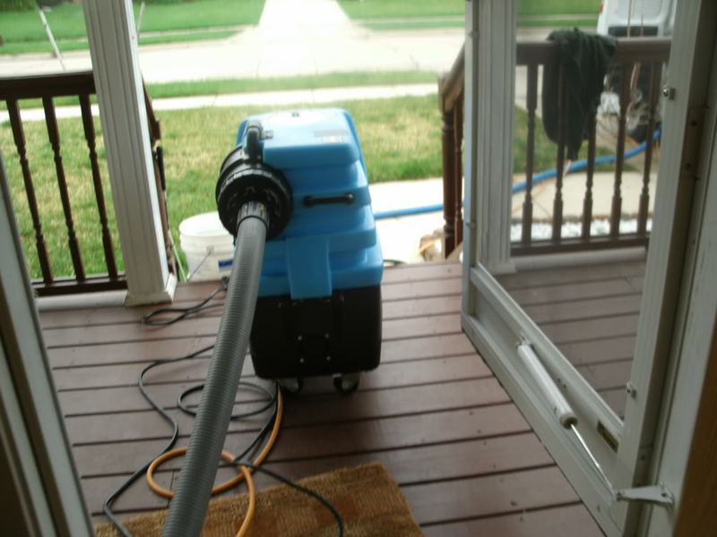

Tried it out today for the first time on my last job. A stairs and four bedrooms of dirty white saxony. A real hump job to finish a long Friday of work. Kept the Pro1200 off. It would normally take two hours to do with the TM. Took off a faucet aerator and put on my adaptor and hooked a 50' 3/8" water hose that was over thirty years old from my porty days. Snapped it to my HF and sprayed it all down. Plugged the two 50' electric cords to the Air Hog and it made a beep indicating I was on two seperate circuits. Pulled out 65' of hoses off my reel that have Cool Cuffs that fit right on the Mytee Cuffs on the machine. Kept the machine in the driveway and closed the garage door so I didn't have to hear the whine of the vacs. Excellent vac at the hose end, hooked to my 360i and cleaned two rooms. Went outside and drained the machine as it has a 6 gallon capacity. The pump worked fine (I hadn't tested it) and just left it on after that for auto dump onto the lawn. Kept cleaning the rest of the rooms and ran the 360i on the stairs to finish. Went back upstairs with a 1 1/2" whip hose and wand to finish up the trimming and remove the swirls. Everything looked great, custy said "you always do a great job Art". Wrapped up everything. Took two and a quarter hours. I'll go faster when I get the system down. The van was nice and cool even though it was 80 outside (it was off the whole time).

So Saturday morning I used the Air Hog again, whole house and furniture:

Just find two seperate plugs, hook to a faucet connect to the Air Hog:
