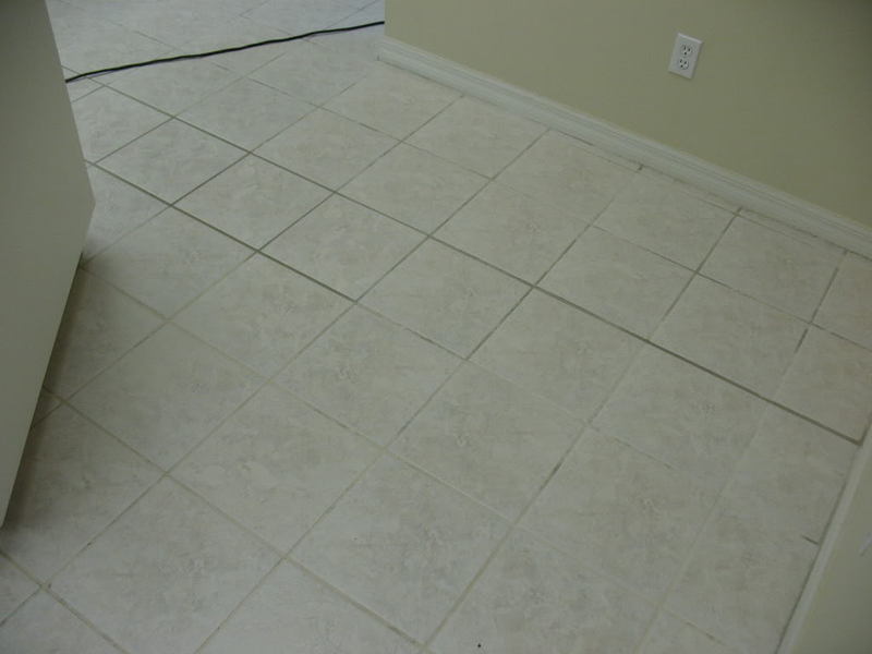

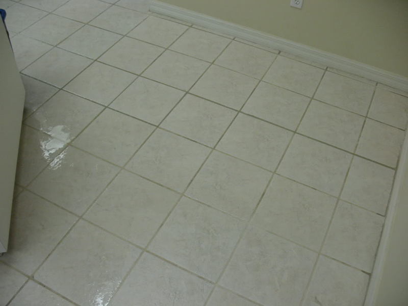

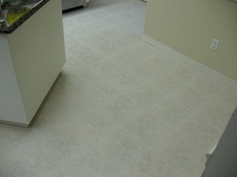

this is why you color seal
B
boazcan
Before
after cleaning
after colorseal

did you try acid etching when you got the uneven results? i just wonder because I can usually fix that with acid but I did have one floor that ended up like that and acid made it worse.
117,335
Jay DeLaughter said:
Where do you find out more about colorsealing?
Does it come off with the next cleaning? :?
Look around in the Hard Surface room Jay, loads of info and no it does not come off.
B
boazcan
We clean with an acid and citrus boost mix. It degreases and etches. That grout was stained beyond help. Did a demo clean and a demo seal. Highest price but only one who did a demo. Sold!
