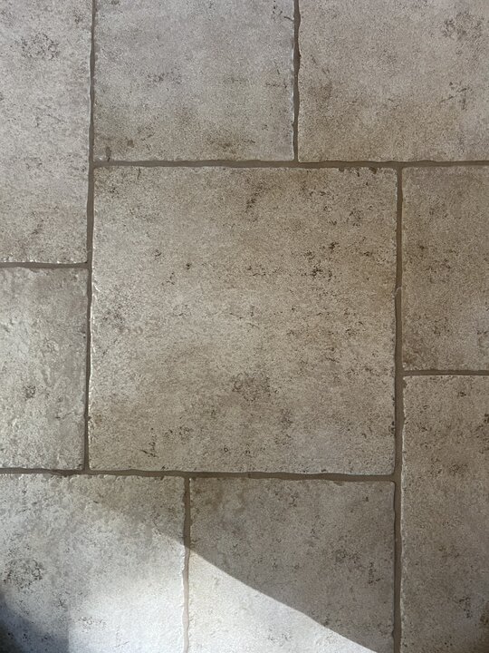

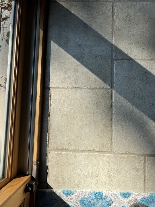

Sep 8, 2025 #1 Rob Grady Member Joined Jan 31, 2016 Messages 634 Name Rob Grady I am no expert on tile identification. I did an onsite evaluation of 1130sf of this tile today. What procedure would you experts recommend? I have the Turbo Force, 175 machine, truck mounted unit and the Mikey Grinder handpiece.
Sep 8, 2025 #2 BIG WOOD The Timminator Joined Feb 4, 2016 Messages 14,627 Name Matt w. It looks like a travertine wannabe that's ceramic. Just a normal alkaline treatment will clean it up nice Reactions: Rob Grady and MarkieMark
Sep 8, 2025 #3 Rob Grady Member Joined Jan 31, 2016 Messages 634 Name Rob Grady Okay. Our cleaning solution is 7.5 so should be good Reactions: BIG WOOD
