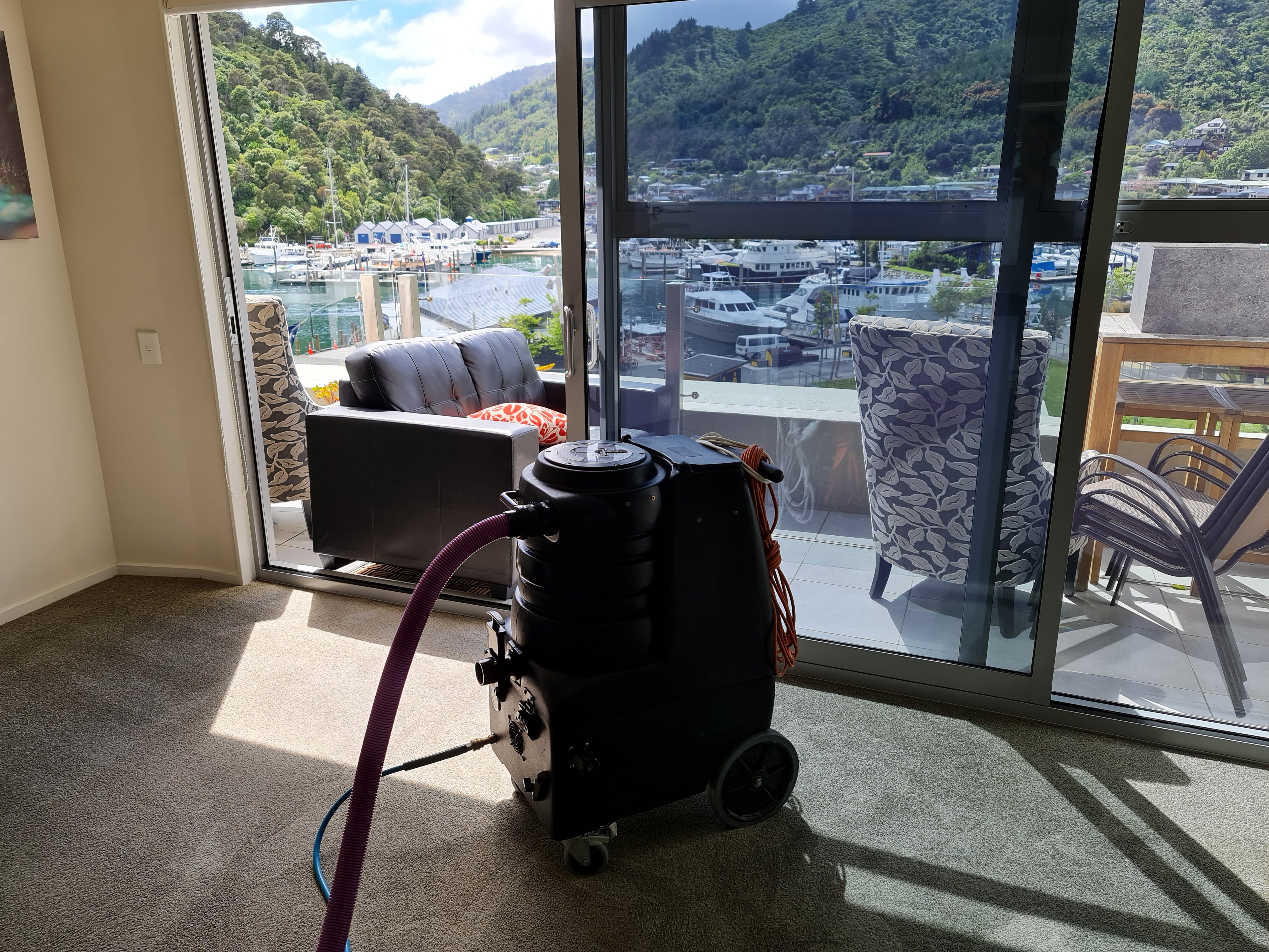

my porty grossed me $500 today and will gross another $250 tomorrow
right tool for the job, admittedly I hope not to roll it out again in a hurry
My op's grossed me over $600 today in a little over 2 hours. Still I wouldn't trade in my truck mount. Made another $200 with my porty as well today

I figure (not including trailer/vehicle) that I can start my carpet cleaning business for around 5K if I do not use a truckmount.
Yep. A sharply lettered minivan (doesn't have to be new) will let you park in high-rise garages where a portable is needed anyway. You need to have a good quality portable; the Hydramaster PEX is a good example of an all-around unit.
If the bulk of your work is in the suburbs, I'd recommend starting with a used truckmount (sharply lettered) and skip having to deal with the extra time involved in portable work.
