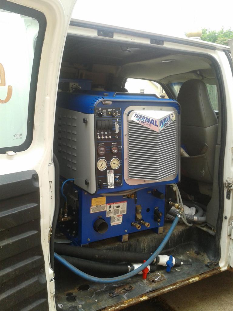

Just curious.....do current TM's still have throttles that turn? I had figured that with fuel injection, everything was button or switch controlled.
Even my "new" 2010 Thermalwave Vortec II has no throttle, or choke.
A
Able 1
Instead you have lots of wires.. I'll take a carb!:winky:

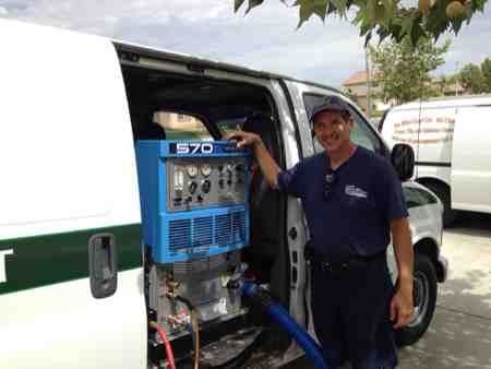

Tom Meyer
Gentleman,
Sorry for the delay, I was camping with another BDCC.
So here it goes. I had my Powermatic for roughly 12 years. The waste tank was starting to implode on me as well as other issues. Just the tank alone cost me 2k in jobs in the two days I was out. My Steamway distributor is about an hour and half away. I decided to cut my loss knowing full well I was about to get a new machine one day soon. My actual nearest distributor is 20 minutes away and carries both Saphire, Prochem and Masterblend. I was really interested in the El Diablo but using Kero just wasn't appealing to me especially at almost $7.00 a gallon (55 gallon drum delivered to my residential house). The reason why I chose the 570 over the 370 because I owned a Prochem Legend prior to my Powermatic and it was really disappointing from a performance stand point. I regretted not upgrading to a Performer at the time. This time I figured I wouldn't screw around and wanted a machine I would be happy with for at least the next 7 years. I'm done after that.
My decision was based mainly on the close proximity of my distributor, having Jim Martin swear by the machine and having his direct cellphone number (I really respect the guy with his knowledge), having Rick Aranda's personal cell because I will bust his chops if something happens and other happy board members.
The machine cost me $24,500 plus tax. That included install and having my old machine delivered on a pallet to my house (free of charge). Total $26,700... As some of you know this is a part time gig for me. The money I make from cleaning is all gravy and I've been using the money to build passive income through rental houses and hard money loans. The 27k was definately a bump in the road but I paid cash. I figure 3 to 4 months of cleaning and its paid for itself minus labor and time of course. That's at a zero cost basis but I believe at the end of my run I should be able to get a few bucks for it.
I think sometimes we get caught up too much in the numbers. The return on the amount of money these machines produce are sickening. You have to look at the long term not just the immediate cost. Maybe that's why I'm just a part time cleaner and not a true self employed businessman, lol.
Now for the machine. Its definitely an ass kicker. Maybe the burner on my Steamway wasn't working correctly because the heat on the 570 is insane. I think it might even get hotter. I will admit I was a bit hesitant coming from an oil burner to a heat exchanger but my concern has been eradicated. I only have 18 hours on it so I'm still in the honeymoon stage. I will post again later down the road whether good or bad.
Cheers!

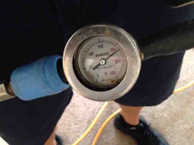

11,536
300 Cfm 220 ATW
Mind you the Cfm was after 50 of 2.5 inch hose and 50ft of 2 inch lots of suck and tremendous heat the machine was pegging out at 280 ATM in full diverter mode with it off it sat at 220.
Also tried the 360i on olefin carpet really easy to use a dream compared to a Drimaster and rx20
Thanks Tom for letting me play with your new toy
