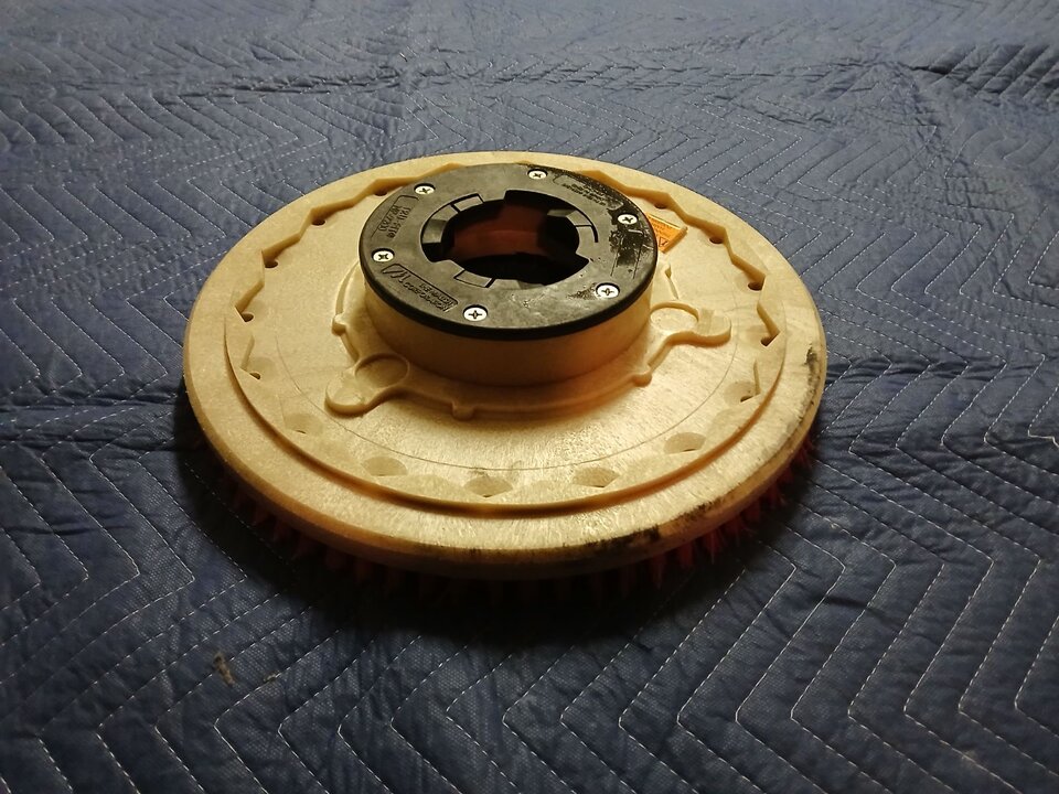

You need to put a riser on the driver to lift machine up so it doesn't rub
My Hawk is a 175-300 so it's powerful enough to use bigger drivers
If he has a small motor on his Hawk it might not be powerful enough to handle bigger drivers

I would always use a riser for my Clarke 17, so I could run a 19" black stripping pad. It was the perfect size for a stripping tool. It didn't take long
to upgrade from the 13šŸ˜‚
I think his is the 1hp. Might not be powerful enough.
