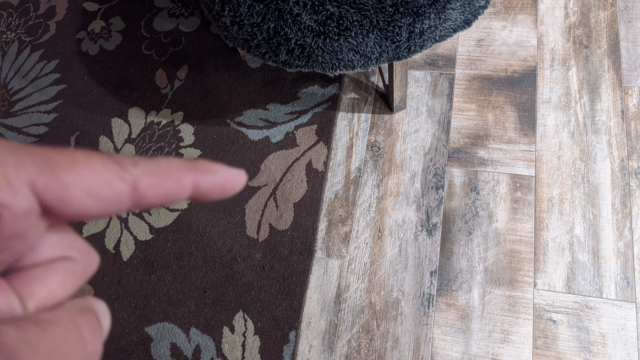

I poured an ounce on the leaf about a month ago undiluted with no blotting or extraction just let it dry....
The highest traffic lane in our home....
