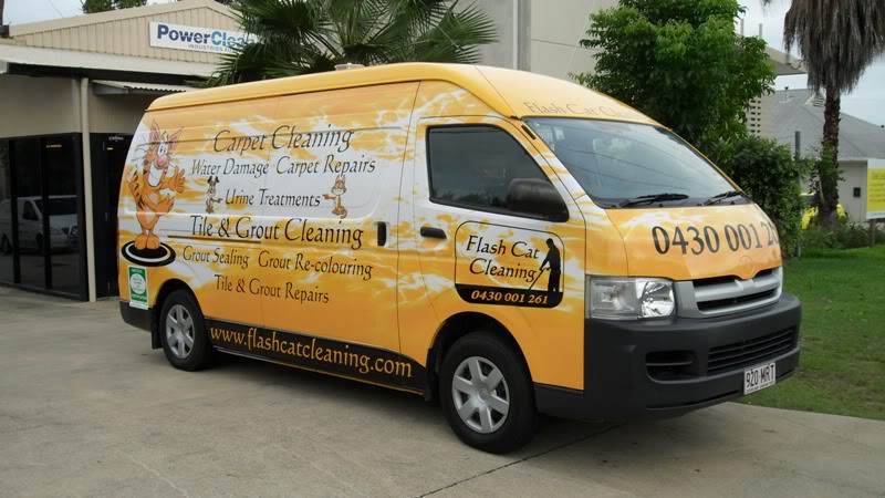

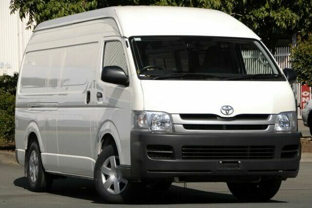

I know you guys over there don't have this van, but this is a Toyota van. This is a larger version of our standard smaller sized Toyota vans over here. This rig is owned by one of our Aussie Cleaning forum member. He purchased a second hand, low km, super long wheel base Toyota Hiace.

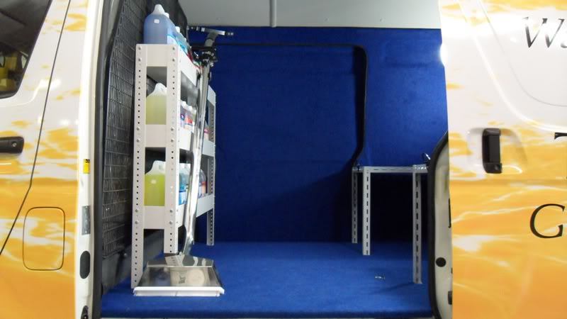

Side view showing chemical shelf and how much spare floor room there is available.

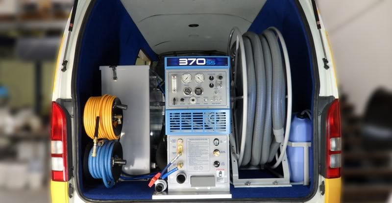

Looking toward the back of the van, the racks can accomdate 6 airmovers (above and below) and still room for a portable, scrubber, dehum or 2 between the two racks.

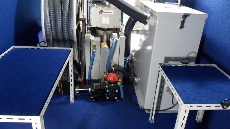

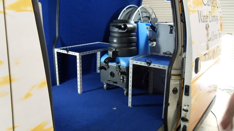

Upon removing cargo that would normally sit between the two racks, it allows very easy access to the APO and the rear of the machine for maintenance.

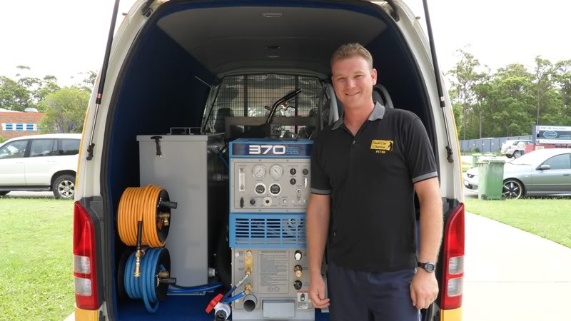

The Sapphire 370 SS. The vacuum hose reel can be removed in under a minute therefore allowing complete access to the side of the machine if it is ever required.

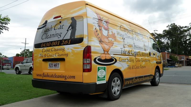

Then (with Pete's ideas) turn a standard looking van into something 'attention grabbing' :)

Surprisingly, we can get them ( and other cool vans) in Canada! These all can be had for under 10,000. TINY diesel motors though.

Over here, we wish we had the vans and vehicles that you guys run. Our vans are generally so much smaller in internal cubic size. The vans that are larger, like this one, all have higher roofs which then stop you from going in underground carparks etc.

Looks fantastic Jim. That machine looks incredibly small - have you had much feedback yet on the performance and reliability of the Sapphire range? Have you installed many yet?

Thanks Heath. Your right, and this has been part of the big attraction with the Sapphire equipment – the physical size is so small, and with our smaller vans this is very important as it allows us easy access to the vital components still. The owners who have purchased either the 270, 370 and 454 have all been very, very happy with them – and most of our client base are existing cleaners that have already had a variety of other brands of TM’s over the years. And yes, we have installed quite a few of the Sapphire units 8)
