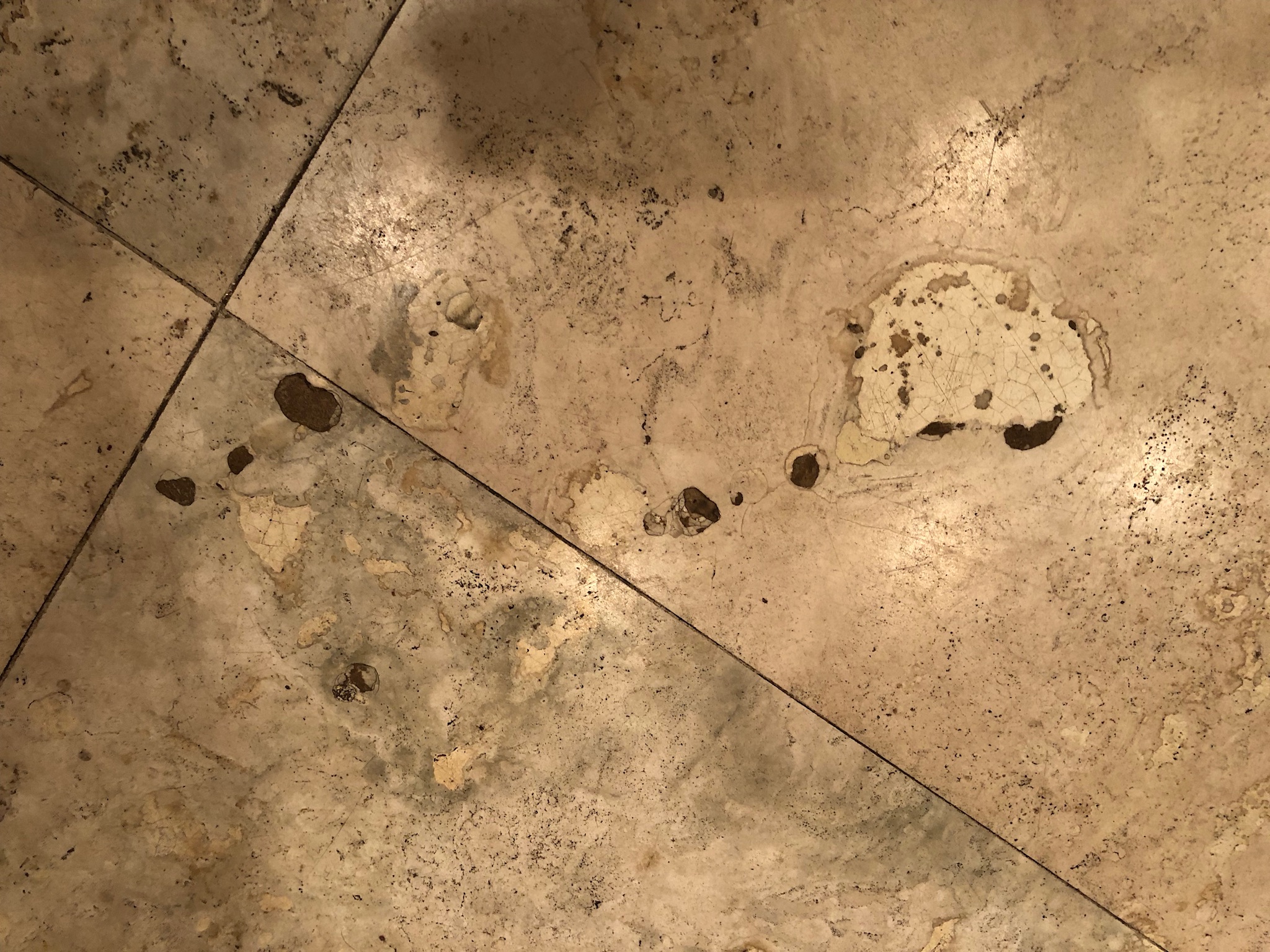

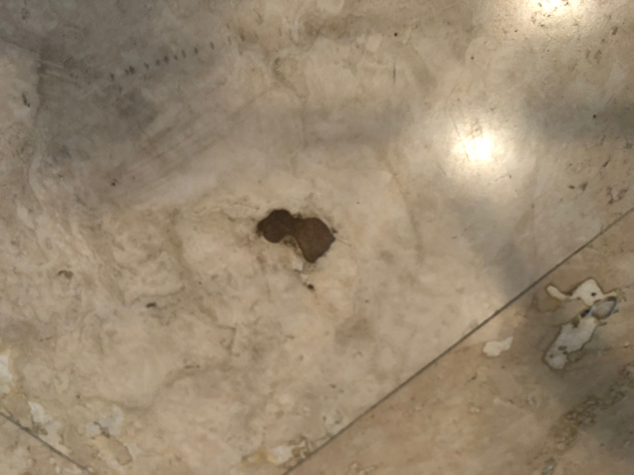

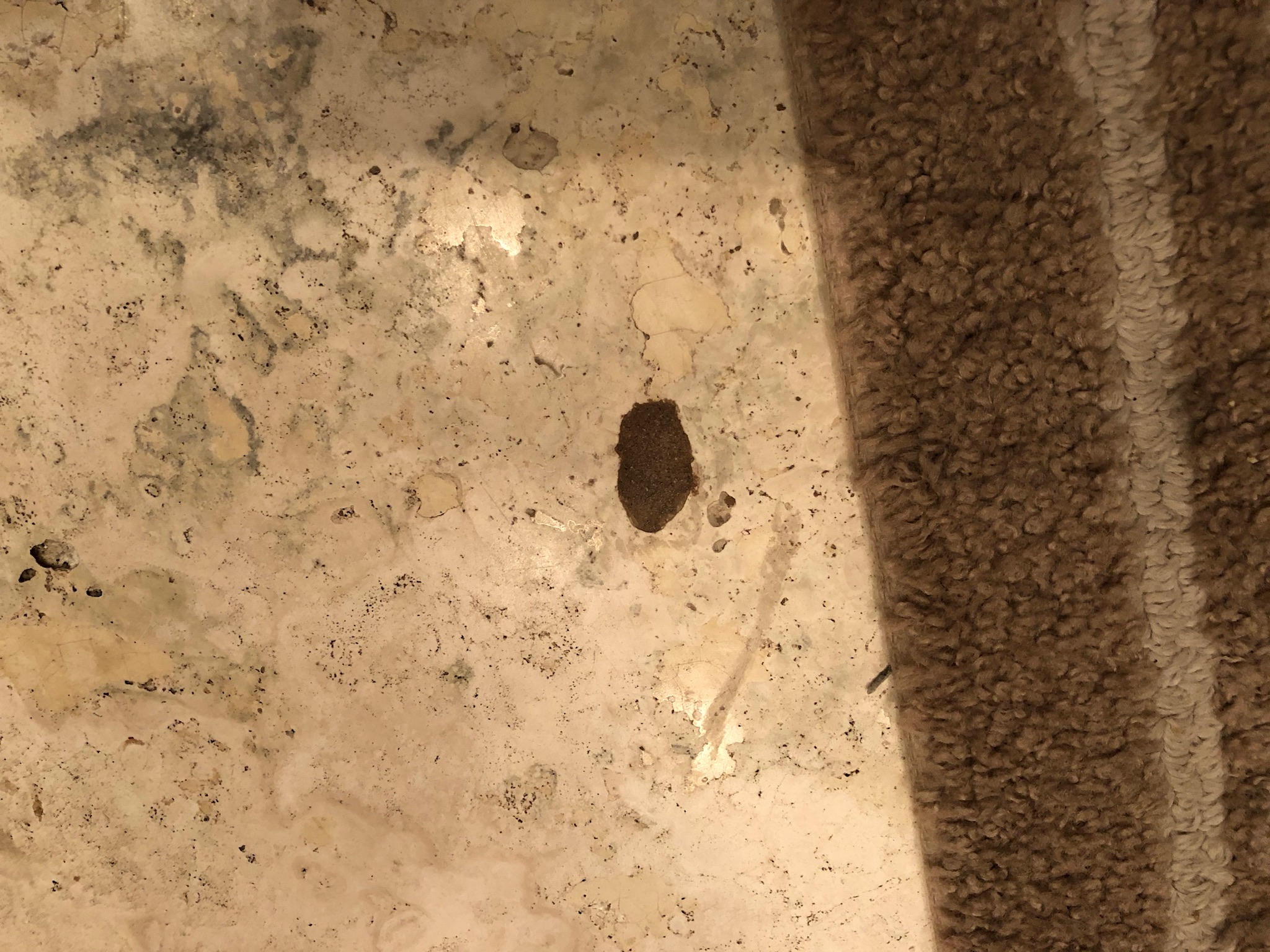

Looked at a travertine floor today for a lady that is a referral from a regular customer. She had someone come in about a year ago and fill the holes in the tile. Apparently the guy was colorblind and used a grout that is much darker than the tile. Anyway, she can't stand it anymore and is looking for options to fix it. Any advice on how fix, or is it not worth the hassle?
B
ButlerFrank
The floor was filthy when he matched the grout color.
Common blunder...
I'm sure it's gonna be a pain to dig out and fill. There are a bunch of those spots. Have to figure how to charge to make it worth my time.

Lol. That crossed my mind when I was there looking at. How long do you think grout perfect would last in that situation before it wore off? It's funny because she asked if there was just something I could paint over the grout to make it match.

Yes they are flush with the tile. That’s my concern with color sealing. I’m thinking the permanent fix is to rake it out and refill. I would guess that there are about 20-25 spots of different sizes.

It looks like a sanded grout. Hence it rough and attracting soil. Kinda like a sanded grout line.
You may be able to turbo that floor and have it look 80 percent better
Option 1 Dremel out and use the polyester trav filler. There is a learning curve
Option 2 use unsanded grout( basically traverfill). Custom linen..

It is a sanded grout. There are some areas that are out of the main traffic areas that are lighter, but it's still a good bit darker. The cust said she questioned the guy when he was doing it and he told her it would lighten to match after it dried. It never did and she couldn't get a hold of him after. I planned on using traverfill, but I'm not sure what custom linen means?

Carl had it. Use a Dremel with a rough diamond burr and lower the level. Leave it rough, then flush with acetone and use epoxy filler.
It can be color matched, but break her heart up front, because if you get a close match to the other grout first try, you are just lucky.
Charge a BUNCH!
