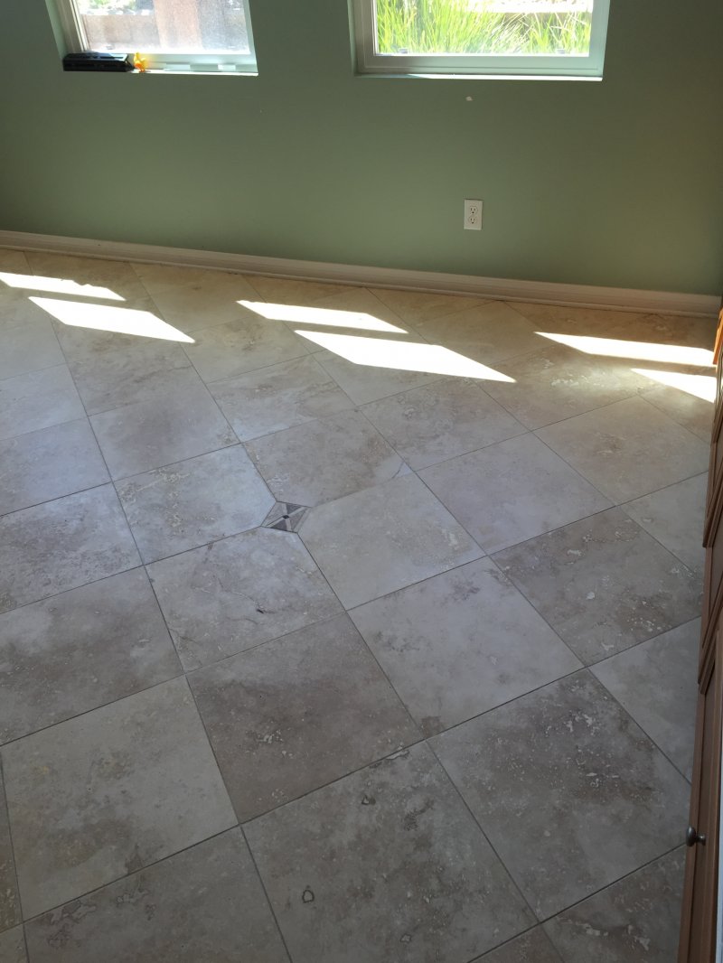

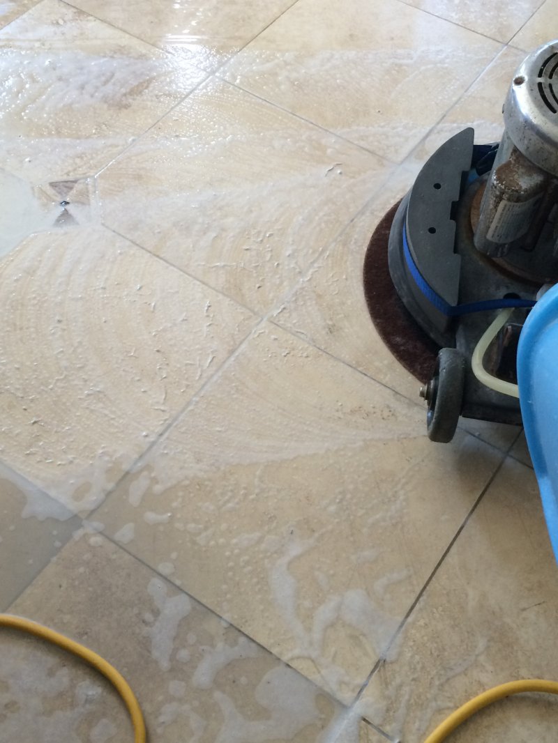

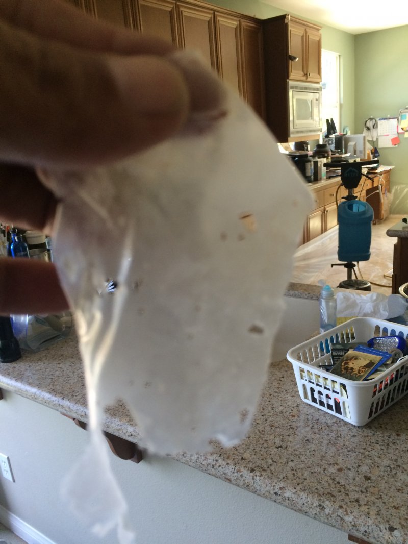

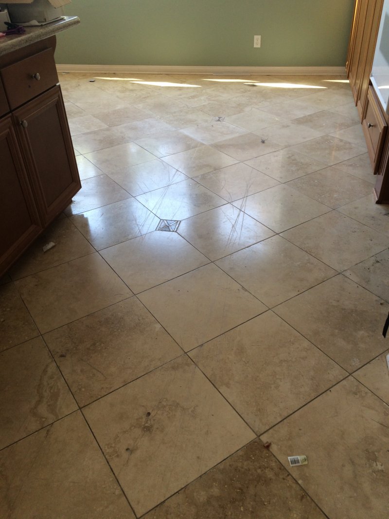

Three coats my butt!!! I scrubbed with the black brush, then I used the black pad, then I used an SPP pad, then black pad again with added weights, then on our knees scrapping the stuff. The tile installation was bad and there is a lot of lippage and the pads could not get a grip. At the end we used the makita with some 400 grit pads for the low spots. She is happy as a clam and promised that she would never seal her floor again IMG_4288.JPG IMG_4289.JPG IMG_4296.JPG IMG_4292.JPG IMG_4301.JPG and call us back next year. Three guys 10 hrs and $2750.00

That and worried about time, it was an hour away in San Diego and did not want to go back today. It would have not been as profitable.

It appears from pictures that your stripper did nothing to emulsify the coating.
This is evident of the sheets of topical sealer you razored, and even as you mono scrub, there is no dissolving going on, just "bunching".
Basically you used a mechanical means to remove topical from surface. Unfortunately, this does nothing to clean grout.
I would recommend you always test small area first; often it is either is going to dissolve or it isn't.
