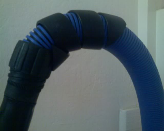

Well joining the darkside was great, I got my package from Larry with The 2" CMP jet angled wand with a GGlide and CobbsPowermax Free freight special and flex 2" hose. So I got to play with it on 4 jobs.
TM-White Magic Commander set at 14HG with 2" bullet filter:
1- flex hose was amazing ,very flexy and I didnt miss my whip at all.(we will see if its durable.)
2- vac difference was very noticable.
3- Wand was amazing, love the size,angle,feel,and 4 jets. clean exceptinally well I had my PSI at 700 and I felt the carpet and it was barely damp when I was done.
4-love the green glide big hole version (I guess you call it )and yes I have glides on all my wands.(slots)
4- CobbsPowermax(free freight & great price- 1 1/2 cups HF yellow tip) I dont know why I switched on this stuff I use to use alot 3 years ago but it worked very well on all the jobs with various situations. I rinsed it with JJ rinse and it mixed soooooooooo much better than FibermaxxPowermaxx and works better IMHO. Cobbs and Grease eraser are the best PS powders but Cobbs is more affordable.
If the 2" hose holds up I will switch the rest of my trucks to 2".
If you can afford it, I would recommend the switch.
Props to Larry on the good deal.
Will check back in a couple of months on durability.

Curtis;
I glad you like the angle-jet 14" wand with the Combo GG.
It works even better at 16" of lift.
The PowerMax is improved & up for any challenge you can throw at it.
Larry
