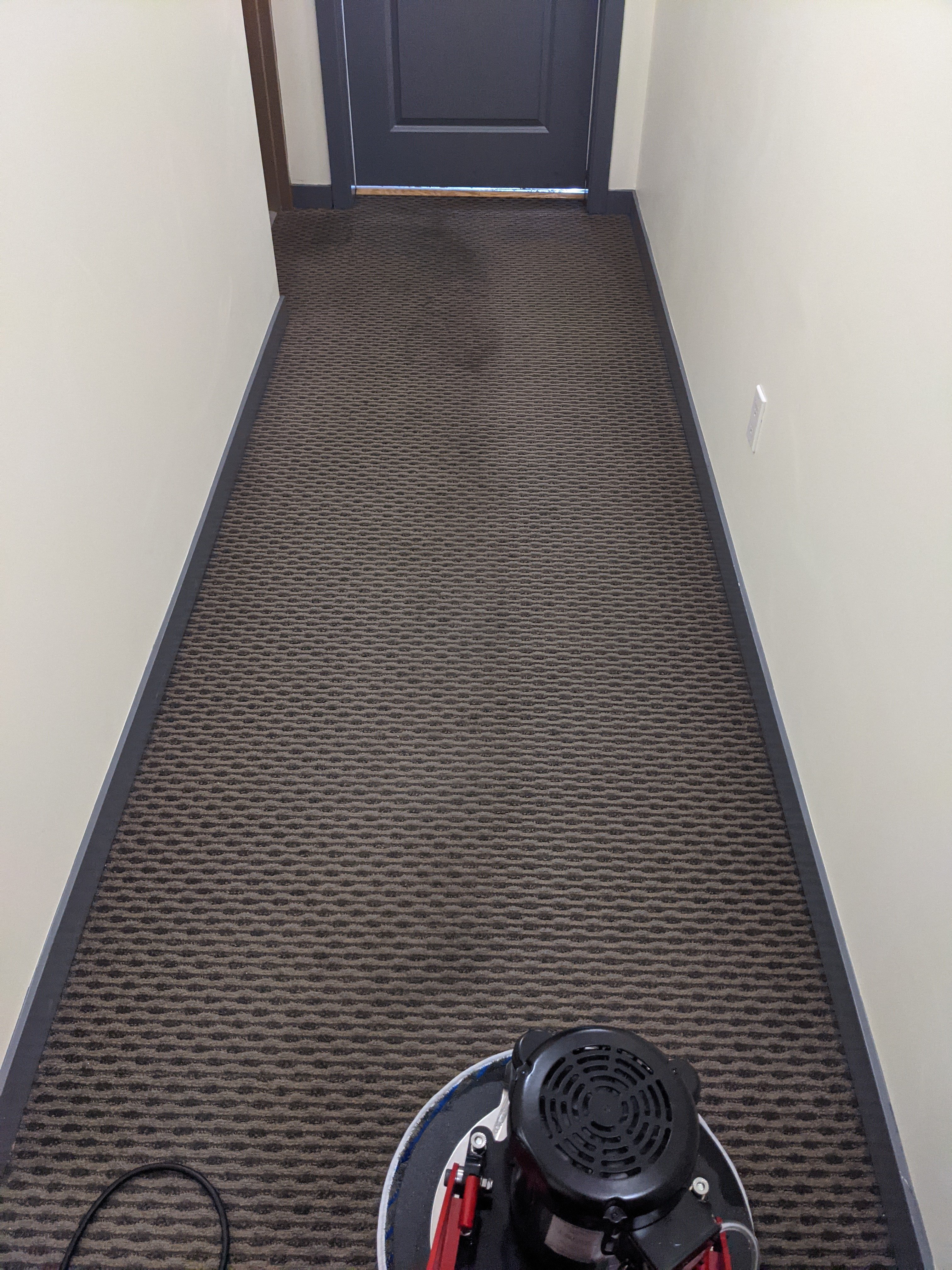

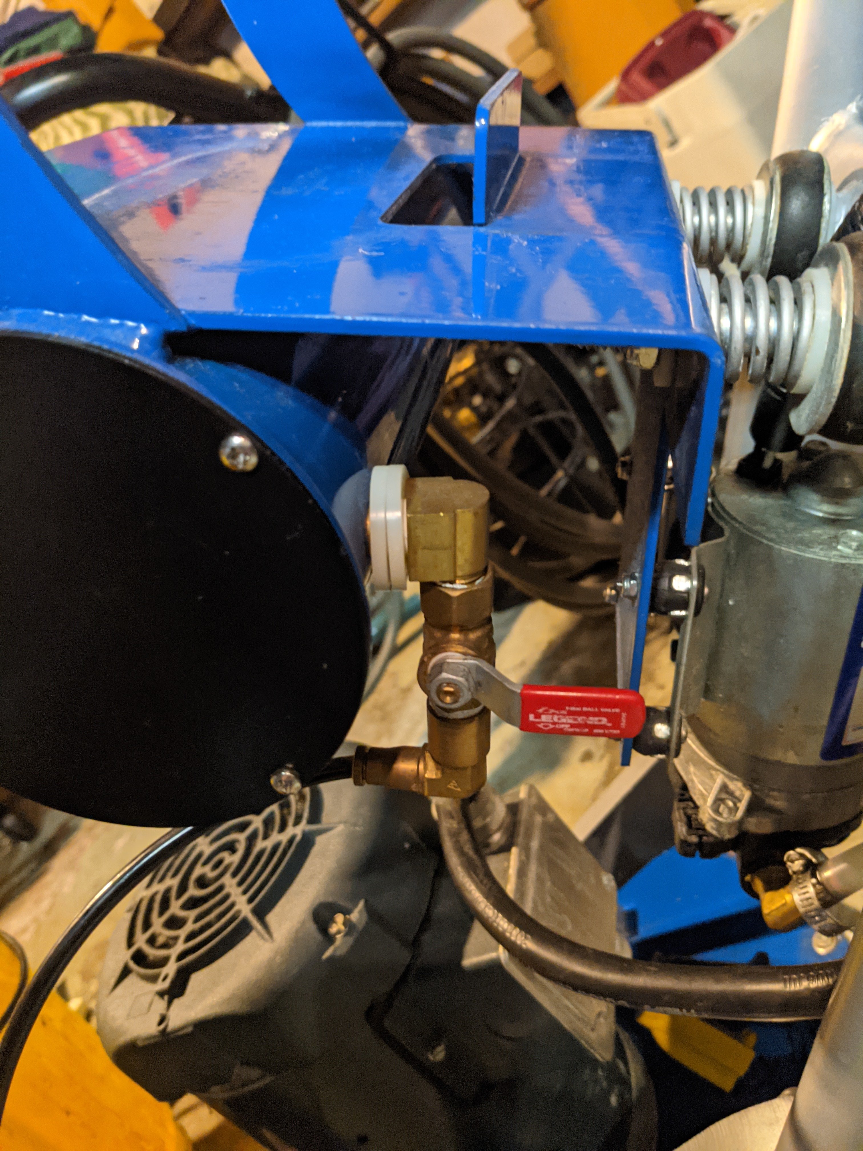

Used my Phoenix for the first time on a commercial job doing condo hallways. 28 hallways in 6 hours for $2000. In the past I have done this building with my Sprayborg. The Phoenix is still light enough that I can pick it up and load into my van but it could use some type of handle on the shaft to make it easier. The power cord is half the thickness of the one I use on the sprayborg but in use, it does not get hot and is sufficient for the amperage of the motor. The pad driver grabs the microfiber pads firmly yet they are easy to take off or flip. The pump sprays well but I would like to see a shut off valve to prevent dripping as it ages. The Sprayborg has one. The Phoenix seems to rotate faster than the Sprayborg and feels more aggressive when cleaning. Cleans somewhat faster than the Sprayborg. All in all, I am happy with the machine. I have a $4000 job in March that I will be using it on, that more than pays for the machine and I am currently looking for more similar buildings. Great money maker. I will give it a thumbs up.
117,255
A ball valve between the out going elbow and the pump?
I agree that would be helpful cuz if you let the siphon hose hang it drains out you have to regrime it I'll talk to Trinity about doing something like that but in the meantime I'm sure you have plenty of brass and a old Bob Foster approved ball valve sitting in your junk collection that you can splice in there
28,268
I am thinking of adding a quick connect with a spray gun attached with a short curly airhose so I can spray corners and edges and brush. Looking to attach a telescopic brush to the machine for those areas. Here's a pic of the sprayborg.
