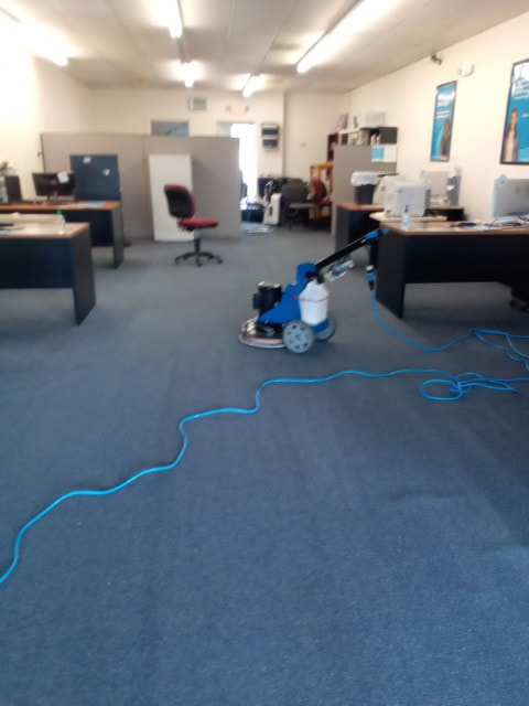

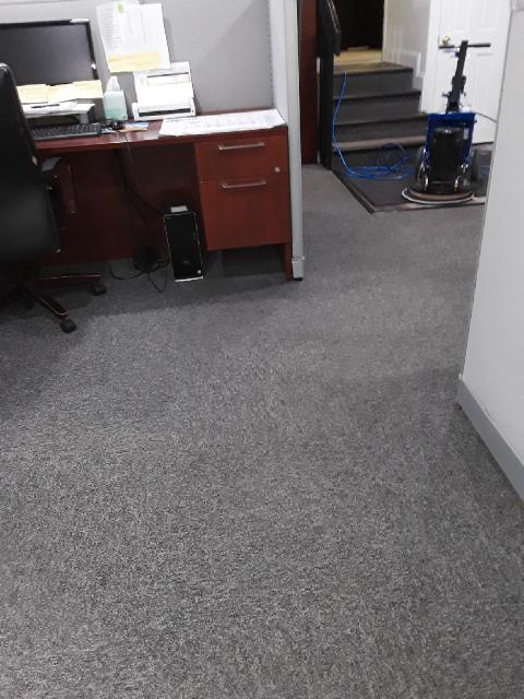

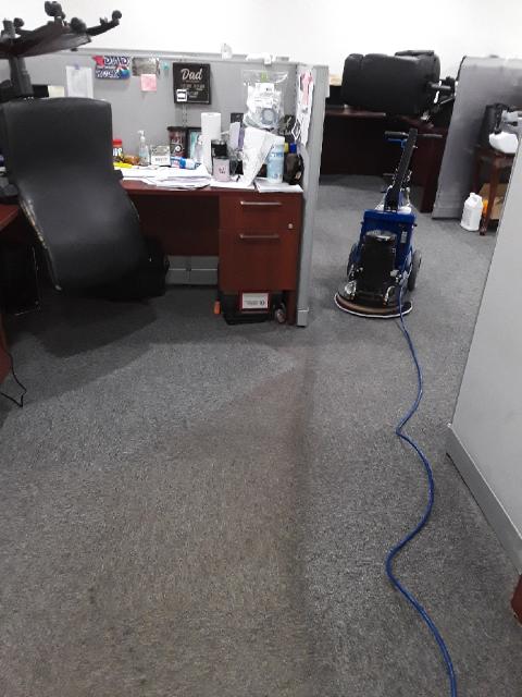

$1800 for a Trinity Phoenix in excellent condition is a STEAL. Buy it !!!
I never used Phoenix on Residential
I use a CRB to scrub and Trinity Odyssey to extract for most of my Residential
Releasit DS2 and Phoenix are used for Commercial Carpet Cleaning
Commercial is mostly just using a Microfiber Bonnet
But in some cases a Fiber Pad is needed to scrub before using Microfiber Bonnets
Those two jobs I didn't need a Fiber Pad
Cleaned easily with Microfiber Bonnets and DS2
115,920
I never used Trinity Phoenix on Residential
Releasit DS2 and Trinity Phoenix are used for Commercial Carpet Cleaning
