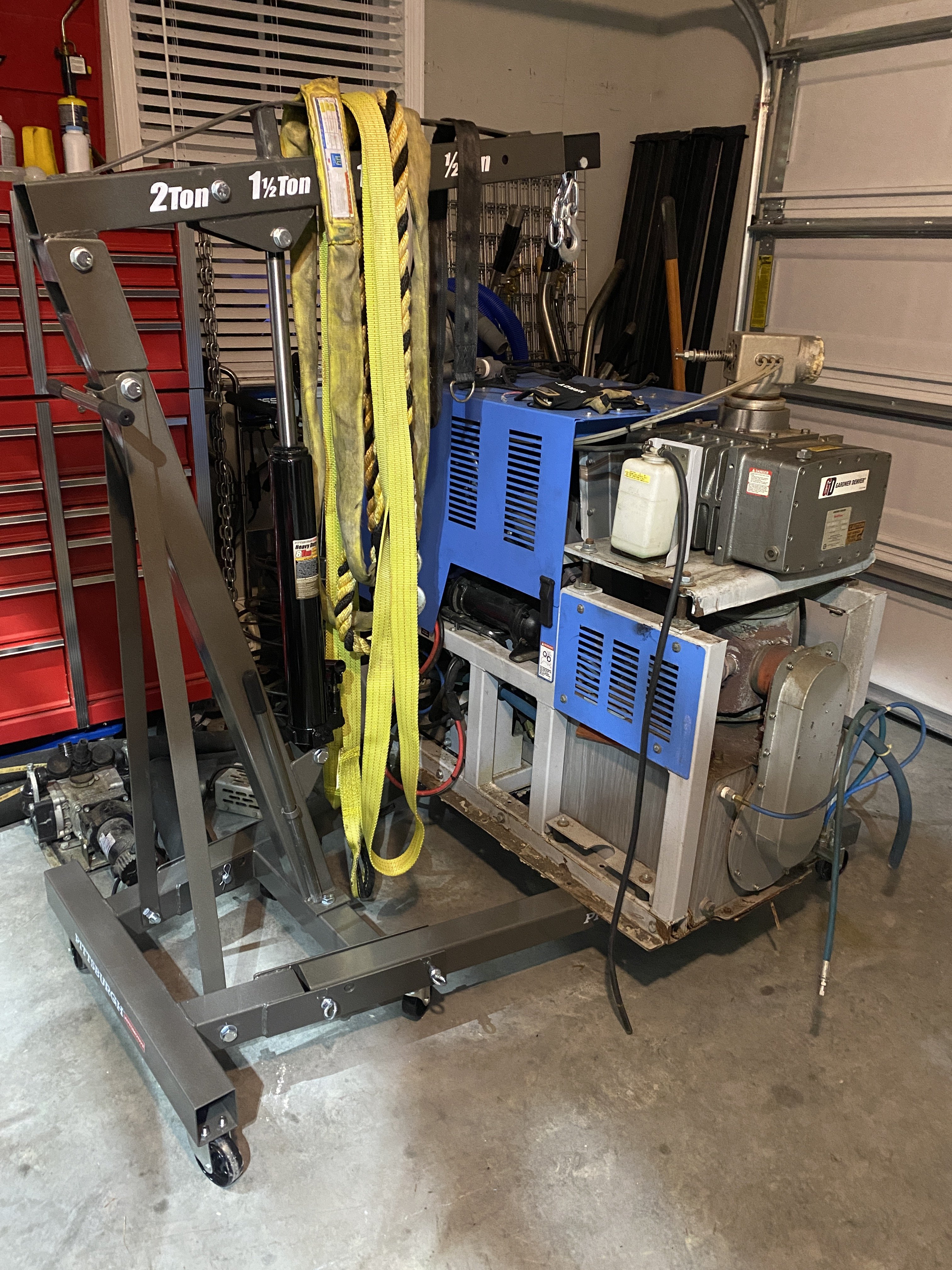

I'm going to start installing my Everest tomorrow. Has anyone had any success using a shop crane (Cherry Picker)? I just picked one up from Harbor Freight.

Depends on what it going in, normal chevy express or ford e350 cherry picker isnt going to go high enough without the arm hitting the roof. Box van your not going to be able to get it high enough. Transithugh roof or medium roof maybe.

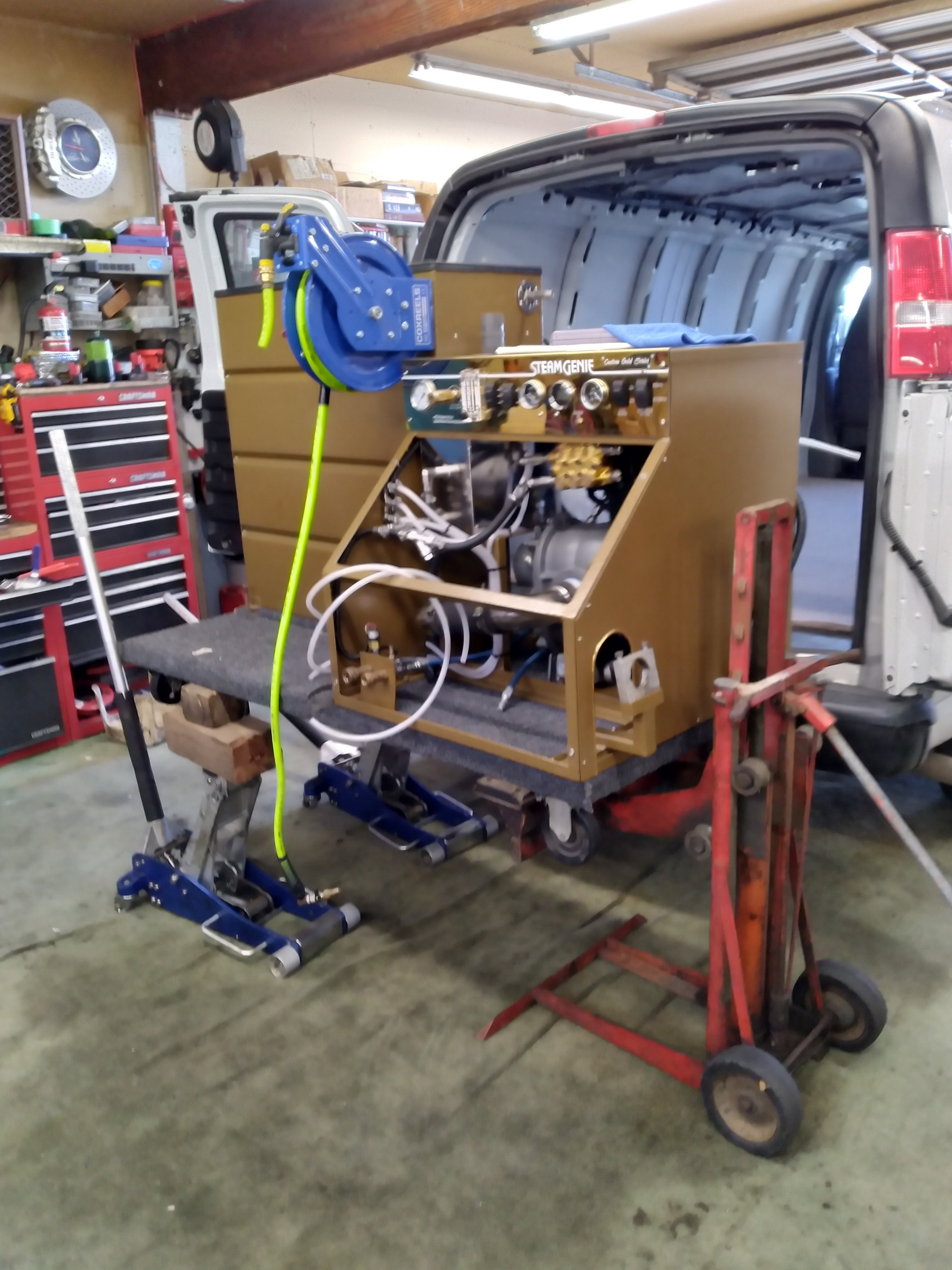

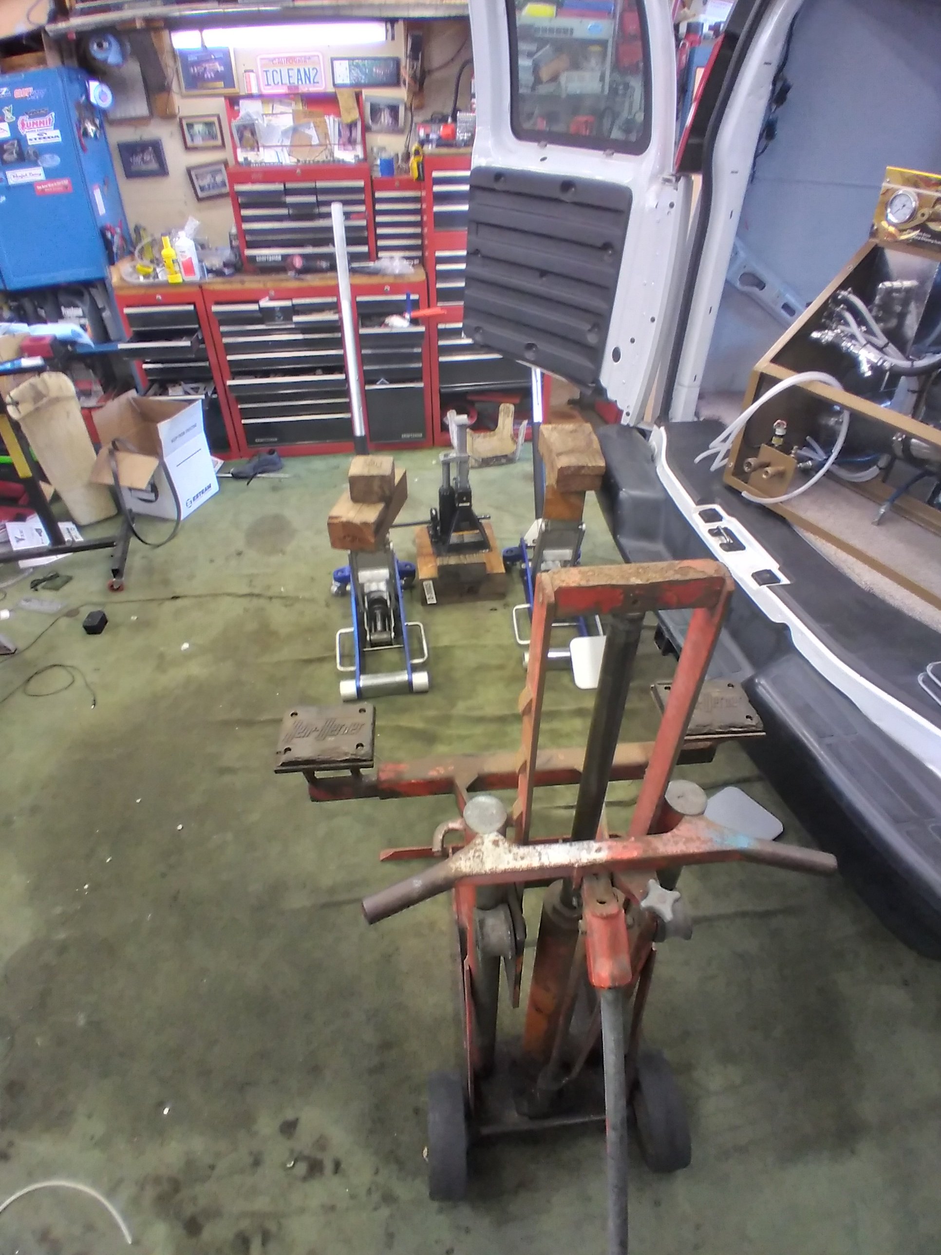

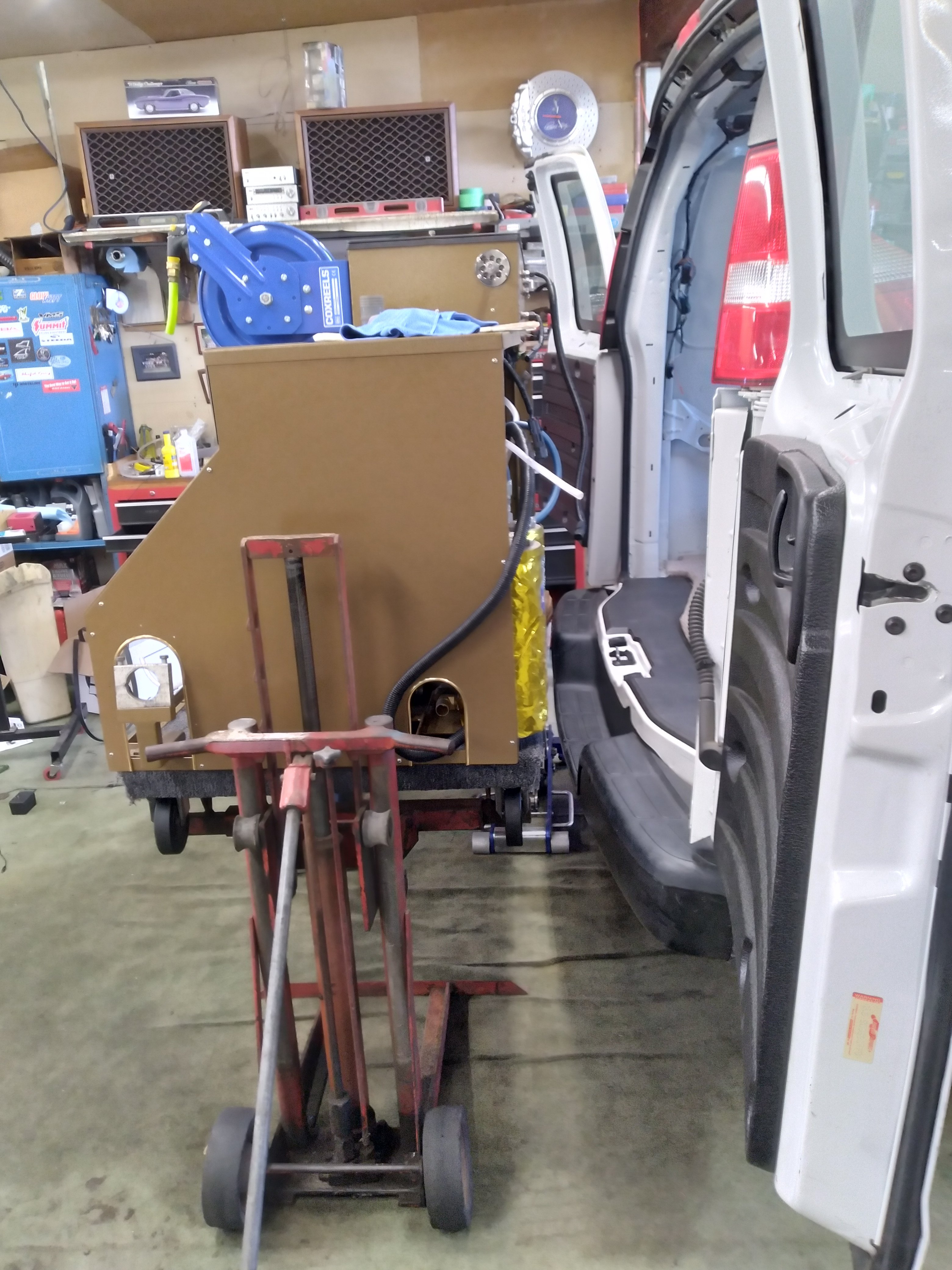

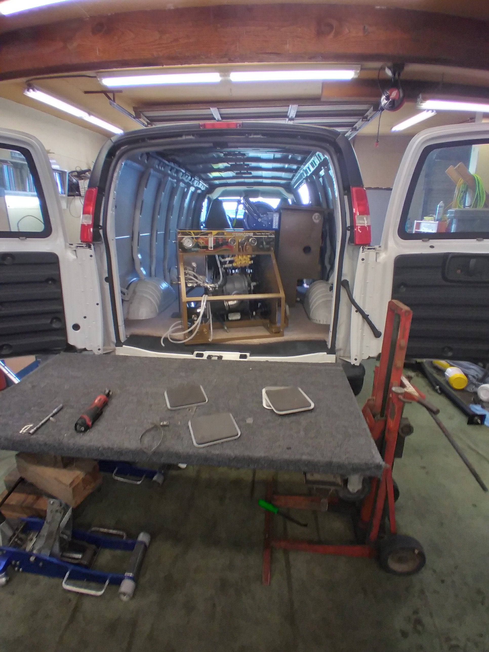

Lift it onto a stack of heavy duty blue skids with a sheet of plywood on top. Move the truckmount on skids with a pallet jack to the van. Slide the mount into the van with small diameter metal pipes acting as roller bearings. Think everything through before you act and it’ll work great.
Reactions: Living The Dream
