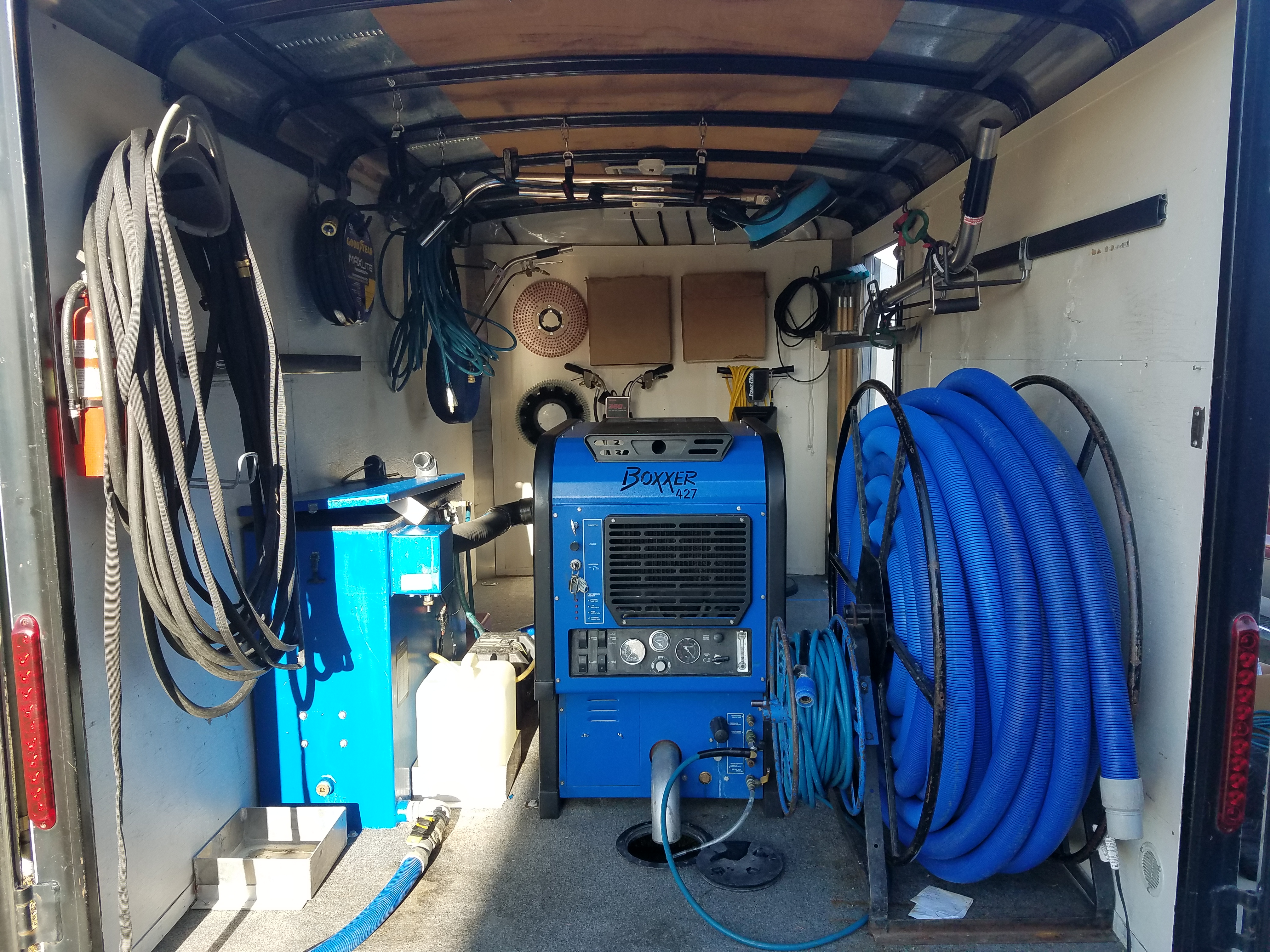

This is my trailer setup. I wish my machine was mounted out the side door and that I had a rear ramp instead of barn doors. Not sure what your climate is but insulate it if it's cold in your area. I also like this setup for my exhaust. I can leave it run with the doors closed if it's super cold but when I have it shut down I can just close up the exhaust hole and not worry about cold air going up the exhaust and freezing my heat exchanger. I hope this will give you some ideas! Nothing more exciting than finally pulling the trigger and getting your setup put together!
