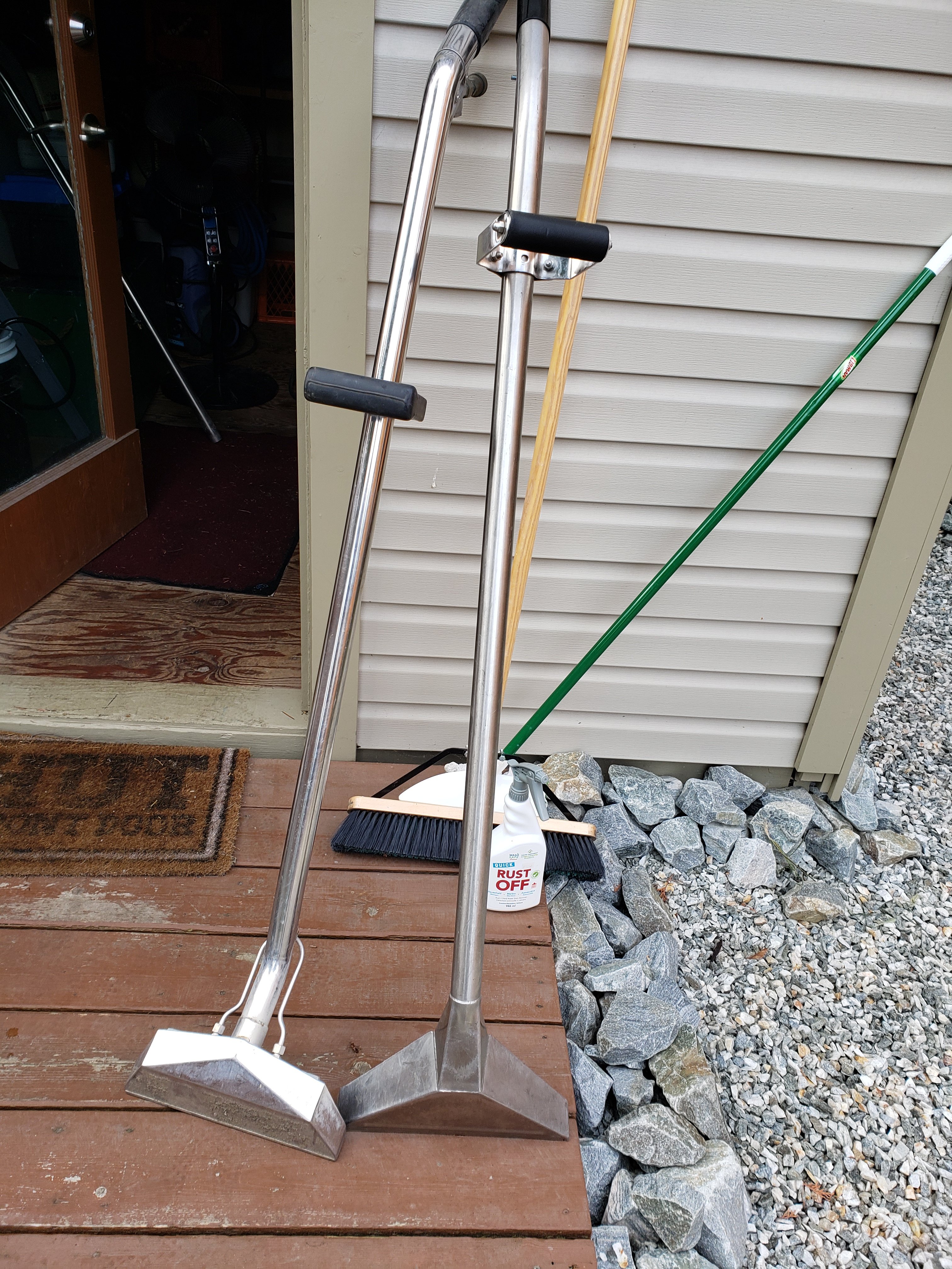

I carry a 14 inch devastator with a new hybrid glide love it, and a sapphire 14 open metal lips or brush glide.
I got options.

I have 2 wands and I'm retired.🪄
