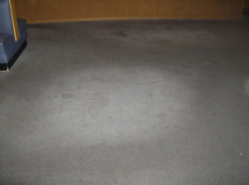

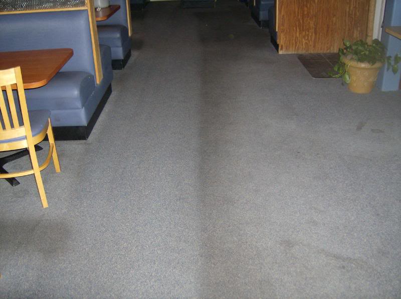

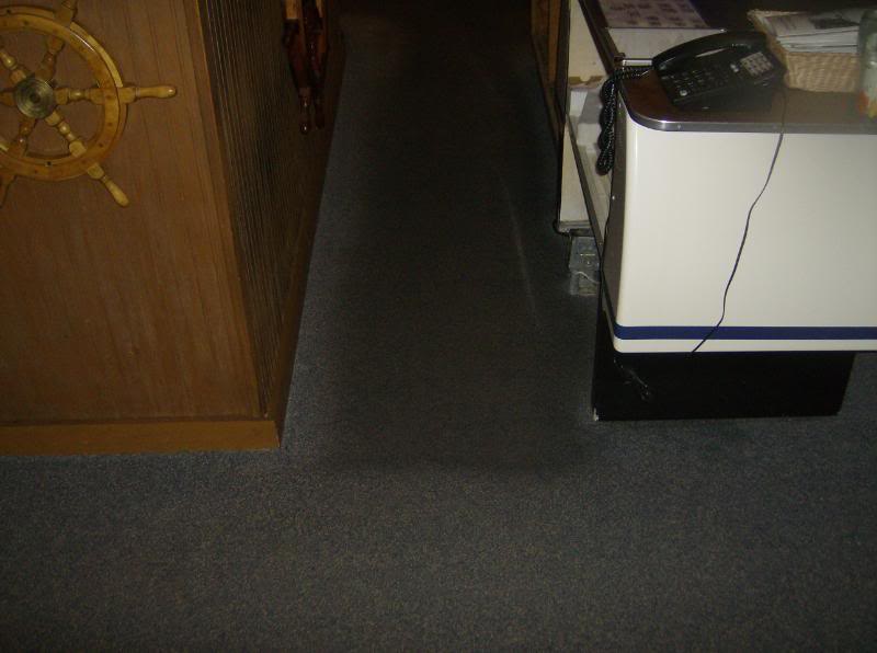

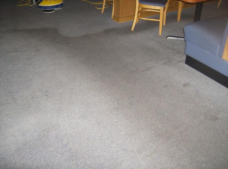

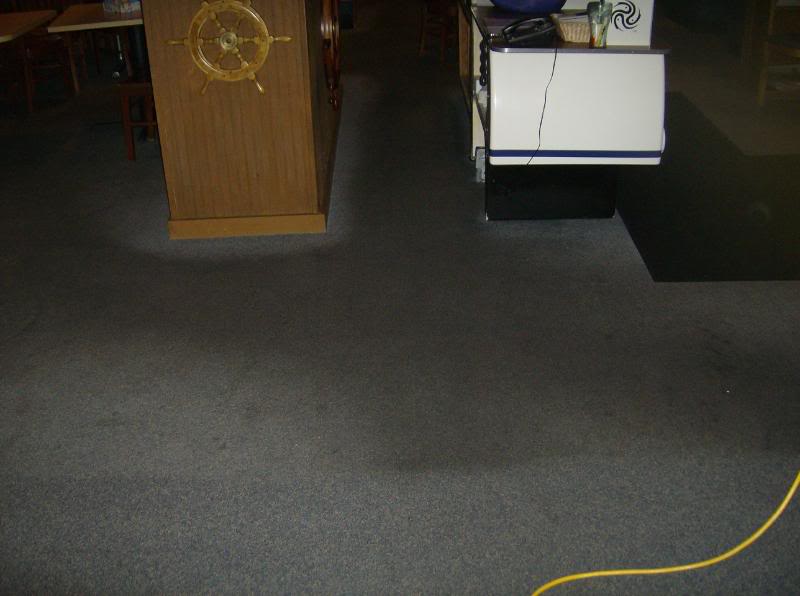

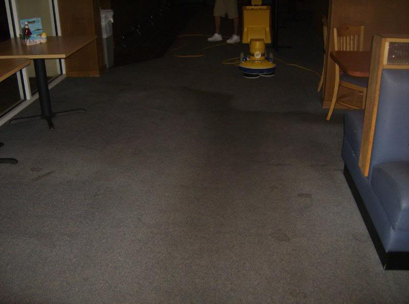

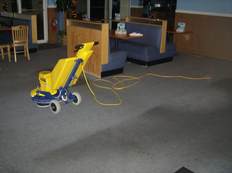

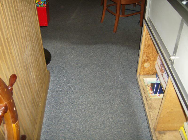

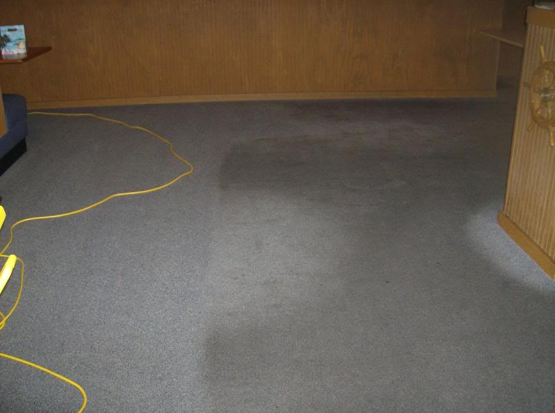

it is a seafood joint that i quoted about 6 months ago..i was too high so he kept getting it done by cheaper cleaners..it looked like crap, they had it wet for 2 days after the cleaning and it soiled back up in 2-3 days..he finally called.

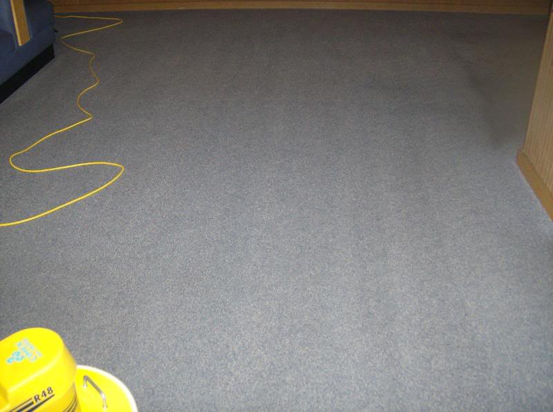

i decided to bring the cimex along for the ride just to see what it did. i was ready to stick it but a few passes with the cimex and bam!!! it was awesome.
i went a little heavy with the Releasit ds..instead of mixing 4oz per gallon i was mixing 6 oz per gallon. super hot water and away we went..
excellent supply was great with the tips and were dead on with their info..
here are the pics
i will try to put them in a before and after order..

not in my pocket with the money..the owner asked how i was able to get it clean when 4 others had not even come 1/2 that close to denting it..
i told him it was a old Chinese secret and i would have to kill him if i told him...he laughed as he handed me my check..i will be doing it every 6 weeks, i will have to figure out when and how often i will stick it to give it a rinse out..

i am pretty sure it was a lot of residue from the others..it was pretty black in areas but only a few times did it act like it was a solid surface..
the restaurant is 1280 sqft and it took us 2 hrs, but we moved all chairs and tables.
I have a cimex and use it for the same type situations, not trying to argue but it isn't clean. The more and more I use my cimex the more I don't like it.
looks like olefin probably resoil reguardless, good tool to have but olefin is olefin

All that black from the before pics is now down in the carpet. If you would have wiped the carpet with a white towel, you would have been scared. You got paid to clean the carpet and you didn't. I love the mex, but only were a tm won't go. I am not going to debate this and I am glad there is a new open spot in the top 25.
