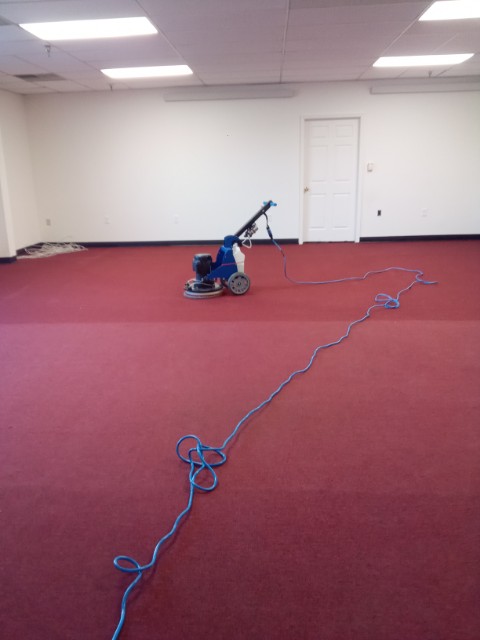

The only issue with running a shampoo tank with a bonnet is that the solution won't flow/disperse through the bonnet very well.
It slings off the top of the pad driver in 360 degrees so its always spraying where you are going.
You do have to back it up to pick up the spray behind the machine though. It becomes part of the routine. 2 steps forward while triggered one step back. A lot of overlapping.

A FiberPlus pad with a pad driver and shampoo tank showerfeeds the solution through pad. And the pad disperses the solution smoothly. Whereas, bonnets don't have the ability to showerfeed.
Comparing FiberPlus pads to a carpet brush: FiberPlus pads will use less solution than a shampoo brush, due to the pad's ability to spread the solution more evenly.

If you dip the pads in water and the brush you find the pads hold more water than a brush. Bonnets will hold more than the pads.
The solution still slings off the top of the driver on a 175 rotary unless its stationary.whenyou release the solution.

If you use the Malish Mighty-Lok driver on a rotary, you'll find that the solution flows through nicely through the pad, without slinging it over the top of the pad driver. That pad driver seems to do a better job than most.
And on the Cimex machine, the solution drains through the center of each pad driver. The solution then gets spun and spreads through the pads as you scrub. So there's no chance of solution slinging the juice.
