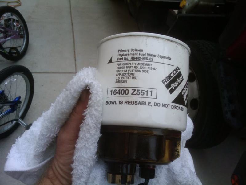

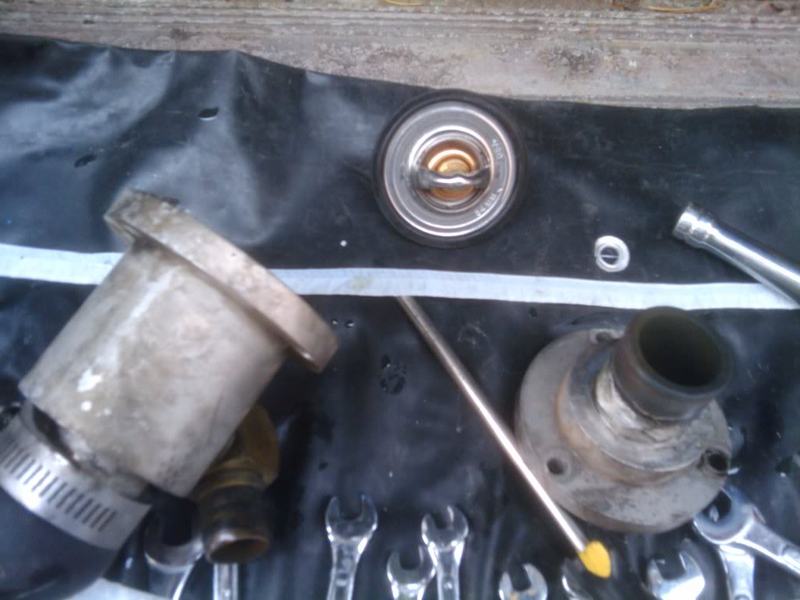

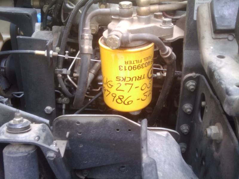

Thanks for the help everyone! Yesterday I spent all morning scrubbing rugs and all afternoon servicing the UD. Then last night went out and scrubbed rugs again. This is the first chance I've had to log-in and I'm overhelmed with the level of support. Thank you very much!
Decided to start with the easy stuff first.
I replaced the fuel filter. After spinning it loose I noticed a date of August 2005
Then, removed and cleaned the sedimenter
Also, replaced the thermostat
Then, dumped in a pint of deisel fuel additive (didn't see the Lucas so had to settle for Prestone).
Now, this truck runs better than ever!
It's smother, quiter, and the cab and fresh water tank heats up faster. Well worth the few dollars it cost for parts.
I haven't determined yet if it resolved the original problem will keep ya' posted.

Question on the sedimentor,did you replace or clean? If cleaned how?
Later
C
Carpet Cleaning Fool
Its been a couple days since I performed the maintenance and the V hasn't hiccupped once. It's running great. Haven't done any upholstery or 150' CGD but will keep you posted.
The driveshaft is out and goes into the shop in the AM.
Brad, I cleaned the sedimentor in a coffee can half full of deisel, put the lid on, and slosh around. Rinse and repeat.
When replacing the fuel filter its a great idea to fill it with diesel fuel first. Then, loosen the bleeder screw, pump the primer knob until air stops coming out, tighten the bleeder screw and your done.
