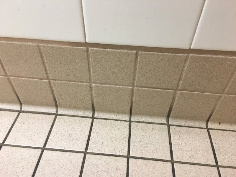

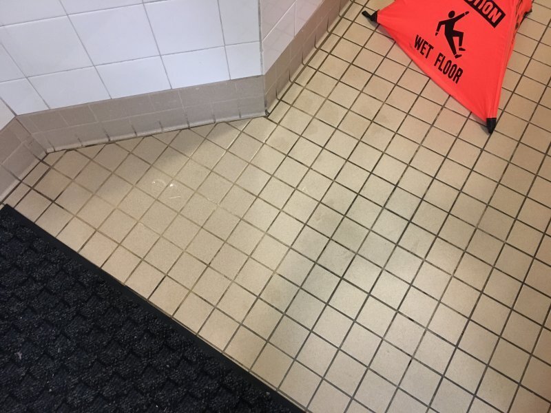

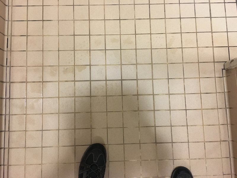

Here's a few tested spots. I only treated it with Saiger's juice, and a little acid after. I didn't let the acid dwell too long, so maybe...
They know it'll be blotchy, so I'm not gonna stress over it
