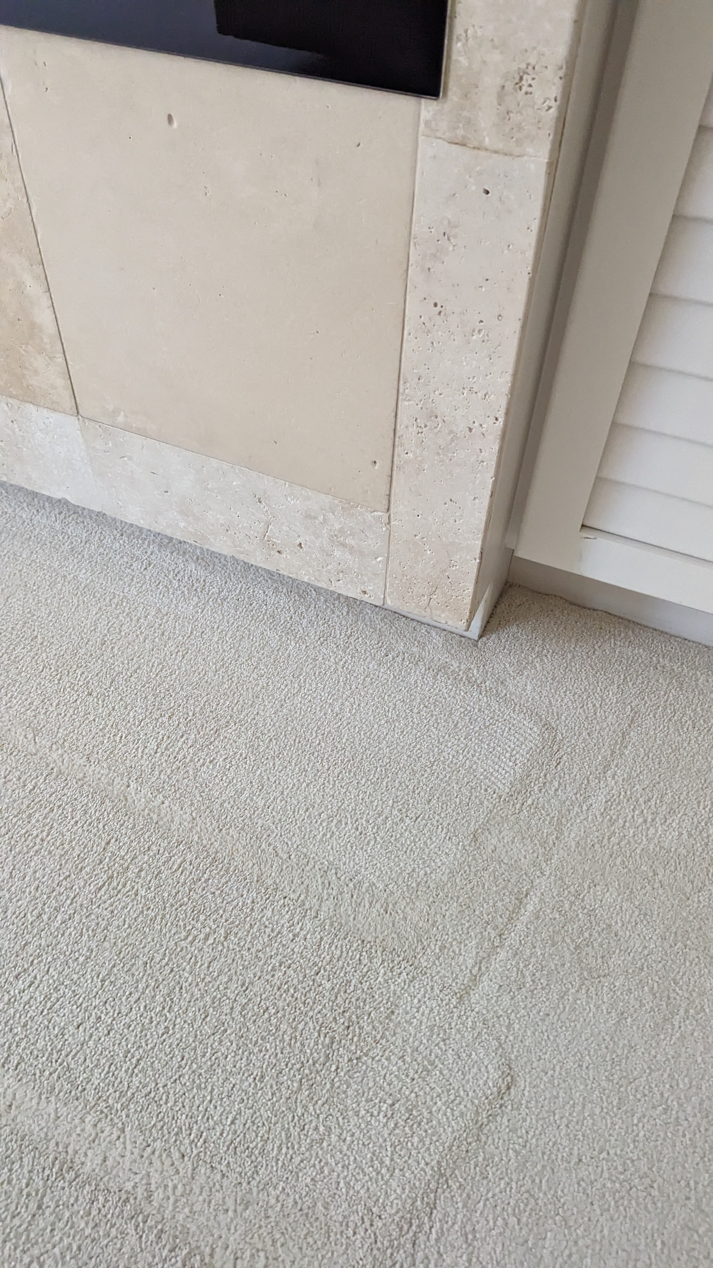

Not from over wetting. From not being power stretched in the first place, usually.
Carpet power stretched can loosen over time.
Some carpets usually the ones made of the same as poly rugs that curl do the same if loose the backing swells.
I've seen people with swamp coolers every summer complain the carpet swelled.
Fall comes and it goes back down.
But if the same carpet was locked in tight it probably wouldn't do that.
