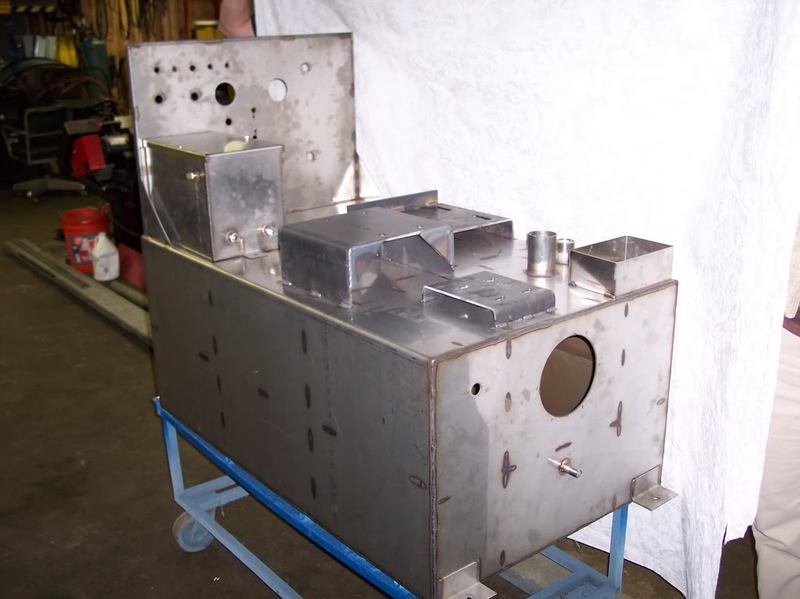

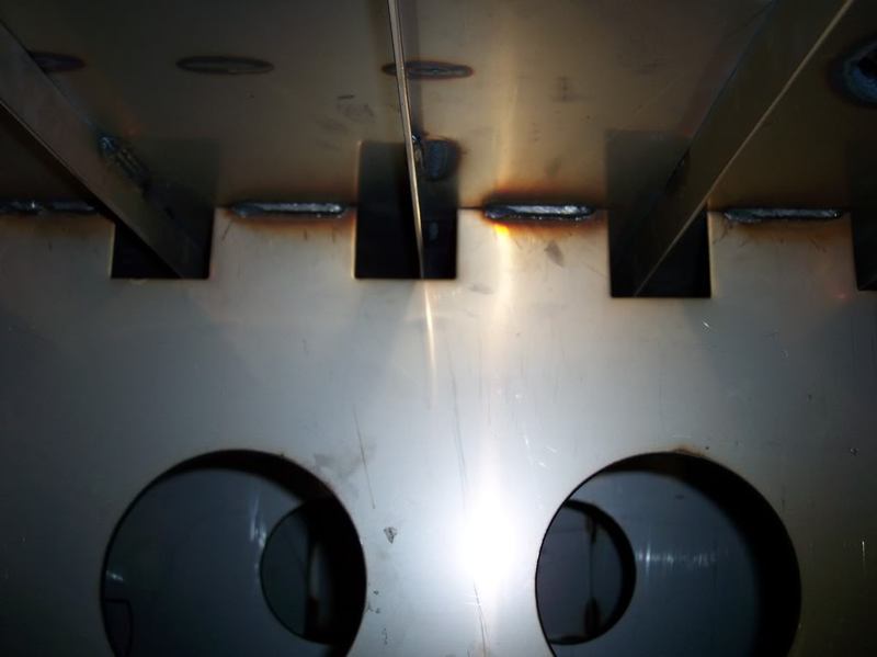

At Judson we do not restrict our vacuums in any way. I guess you could consider our baffling system in our recovery tanks a filter because it does not allow anything large enough to cause any blower damage to get to the blower.
This is a photograph of the inside of a TNT and this is the way it has been made since 1972. There are still hundreds and hundreds of the 1972 TNT’s running to this day and we’ve never had a blower failure due to contamination. The only blower problems we’ve ever had is from people not greasing them or changing the oil on a regular schedule.
By running the blower unrestricted, we allow the blower to produce the CFM it was designed to produce. A lot of truckmount manufacturers will give you blower airflow performance numbers of the blower specs, not the actual CFM being produced where you, the operator connect the vacuum hose. Running a blower unrestricted also allows it to run cooler and this contributes to the long life our units have. I would recommend an inline filter on your vacuum hose just to make cleaning the recovery tank out not such a hassle.
I agree with Mike on not removing the filter in your recovery tank because your tank may not be baffled enough to prevent something from entering the blower.

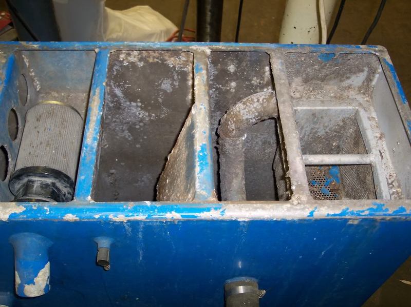

Leslie Judson Jones said:
This is a photograph of a typical waste tank with a filter system. Notice the extreme restriction of airflow with this design.
Hey, I told you not to post a pic of my waste tank...... :evil:
