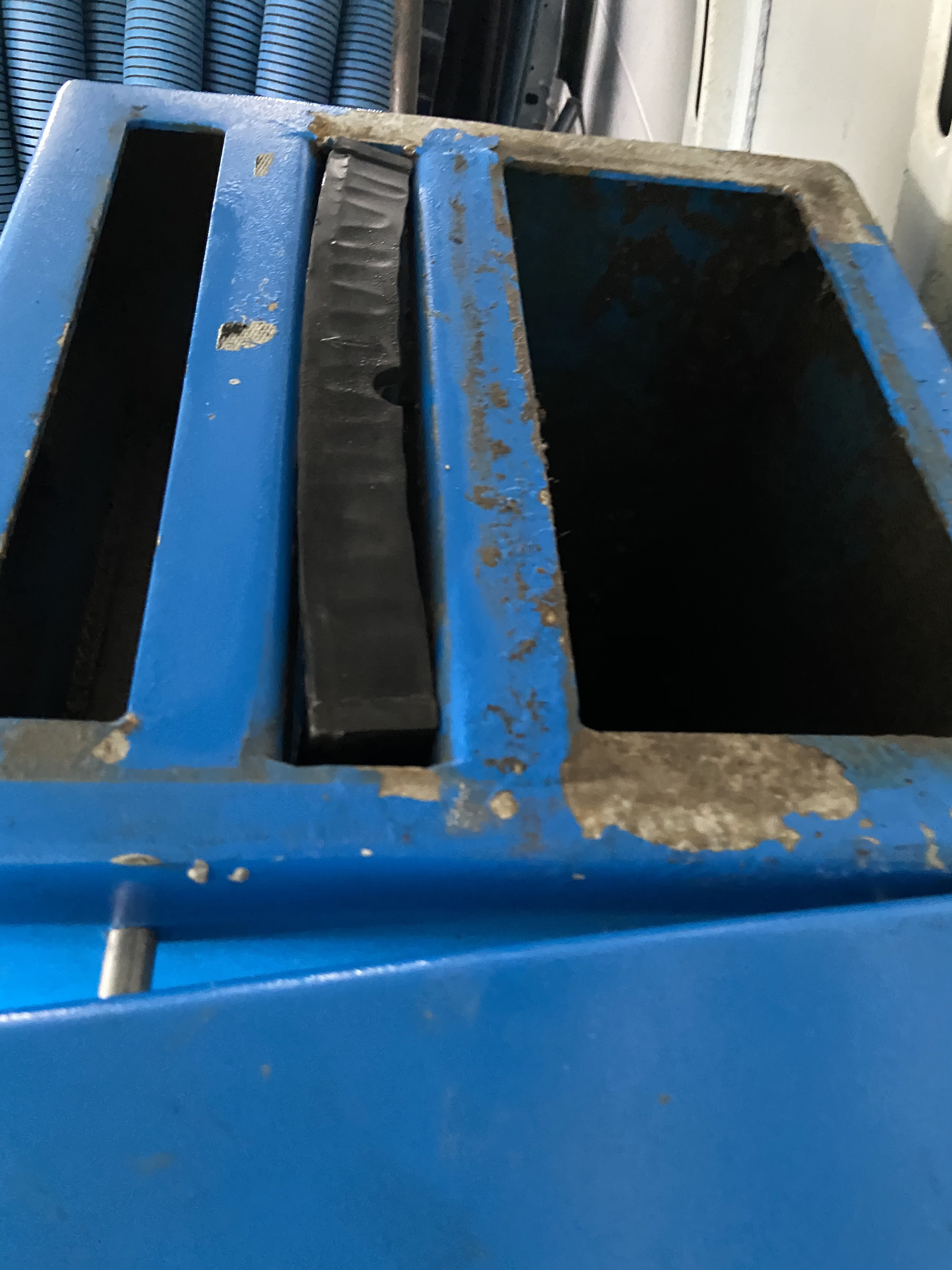

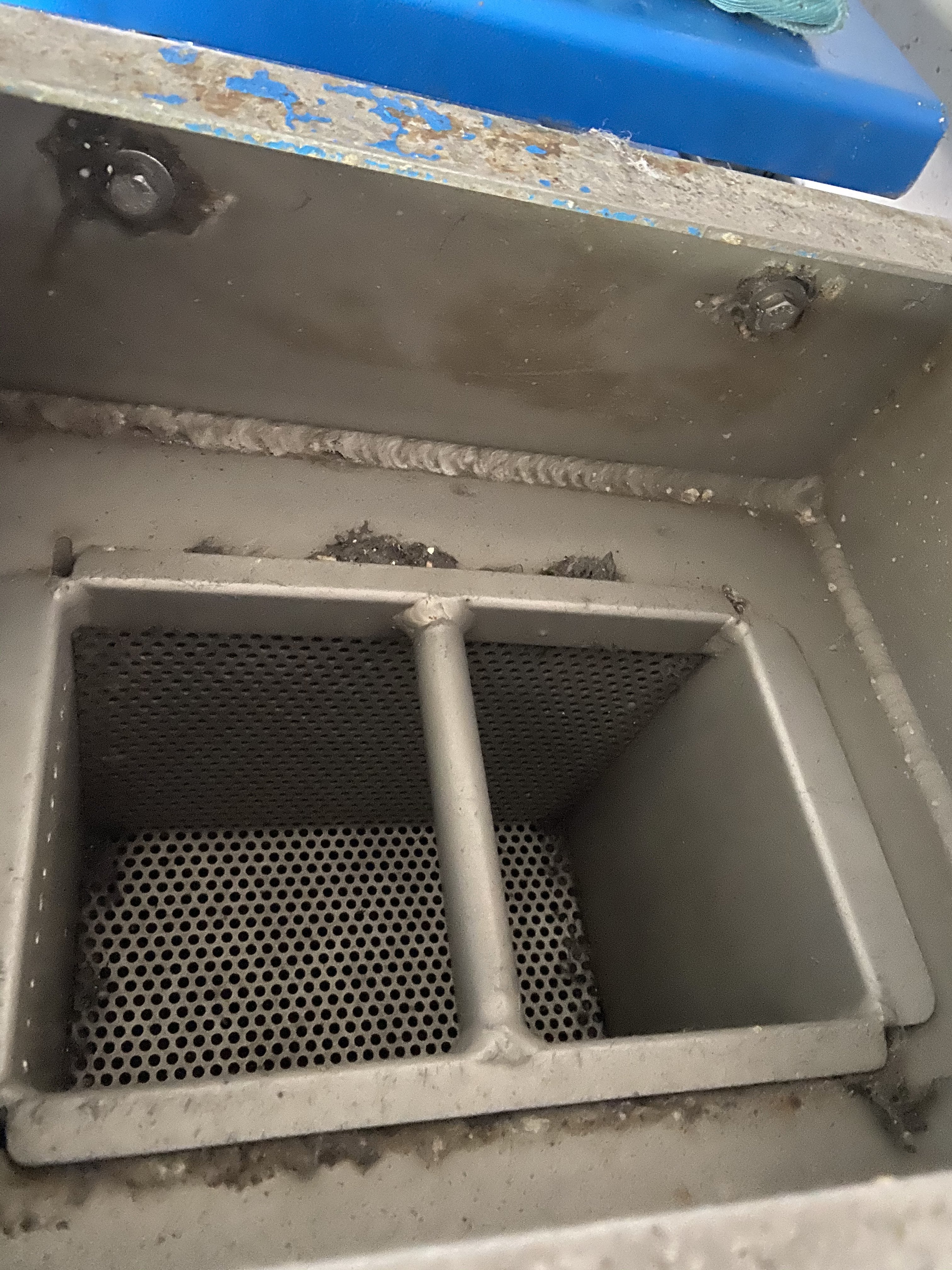

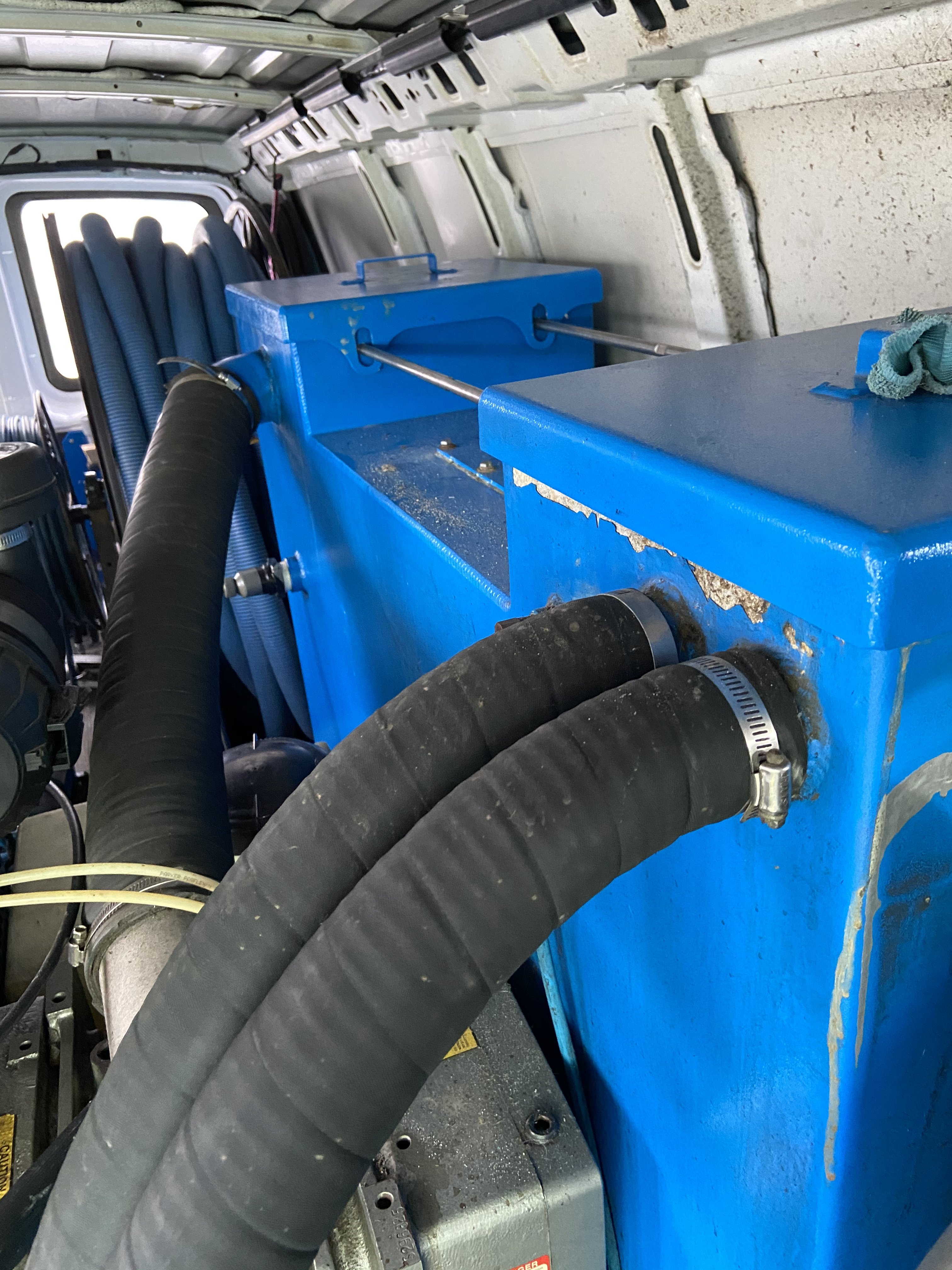

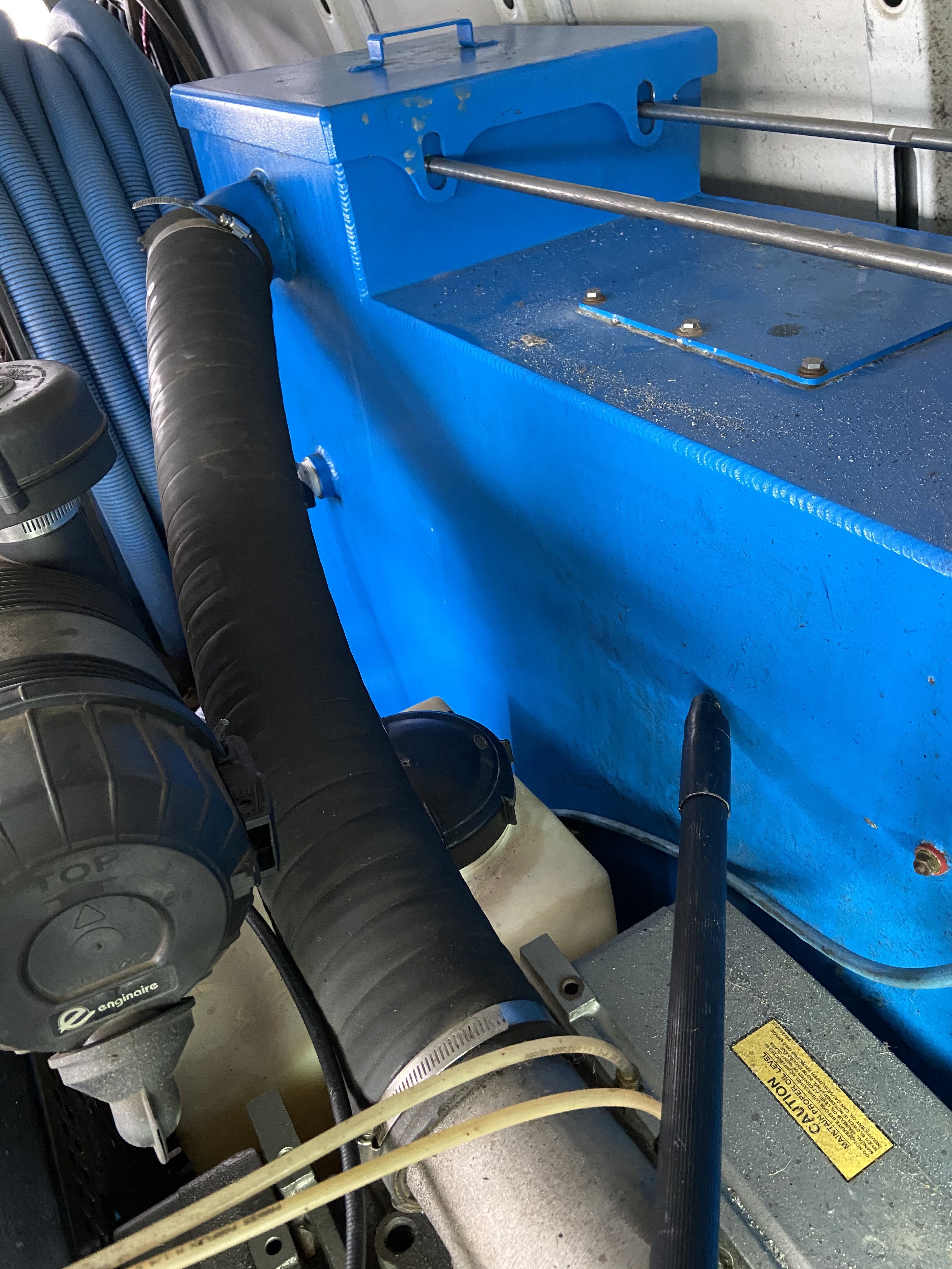

7A9AC04D-4C1B-45C5-B149-2C7A8F9512AA.jpeg 2B636595-AB1F-42E3-9F84-E10D0C3750F2.jpeg B7FC17D6-84DA-4113-828A-8BA07A6B179A.jpeg CCFB27B7-1ECC-4FDD-A3AE-0C82380F51F0.jpeg

Sounds like the extra airflow is pulling water either directly to your blower or pulling it off the bottom of waste tank. It would explain why you didn't experience better vacuum at the wand.

I noticed on your lint basket one end is perforated and the side is not. If the other side is not perforated turn your lint basket so that the solid side is facing the outlet side of the tank. That will force the air down instead of going towards your blower.
The difference in how the machine ran before and is running now is that you have more air movement. The more air is causing the problem, figure out why then you can solve the problem. So stop thinking about what it did before and focus on what it is doing now.
basket is solid on both ends. More air is being caused by higher rpm which is The correct rpm for the machine. Before it didn’t suck water through the blower at the wrong rpm and now it does.

27,878
You're going to have to look at some one else's similar machine and see what the difference is. Could be a simple as having a 90 degree elbow inside the tank redirecting the incoming flow.
