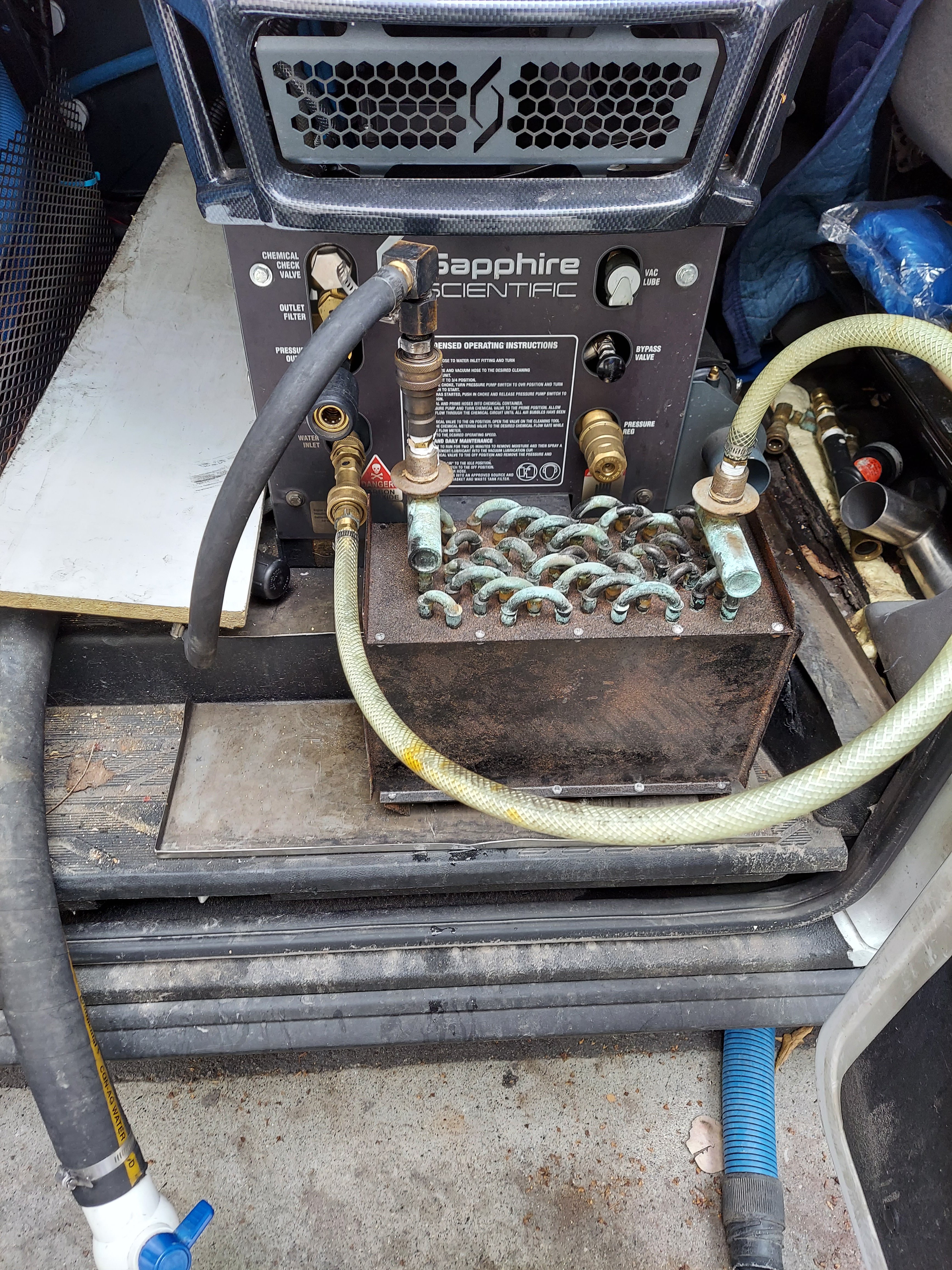

My rough draft idea for preheating water from plastic fresh water tank.
It uses the exhaust heat with a HX.
It takes water from transfer pump- to HX- out HX and into TM water inlet.
im using QCs for flexibility. as it would need to be moved to close the side door; I realize it will be hot.
I would not recommend this modification in hot weather or low flow water use. I like to use higher flow then my 370 is made for.
A future improvement would be to install it under the van with a custom exhaust system for the TM. and have manual diverter valves when hotter water isn't needed.

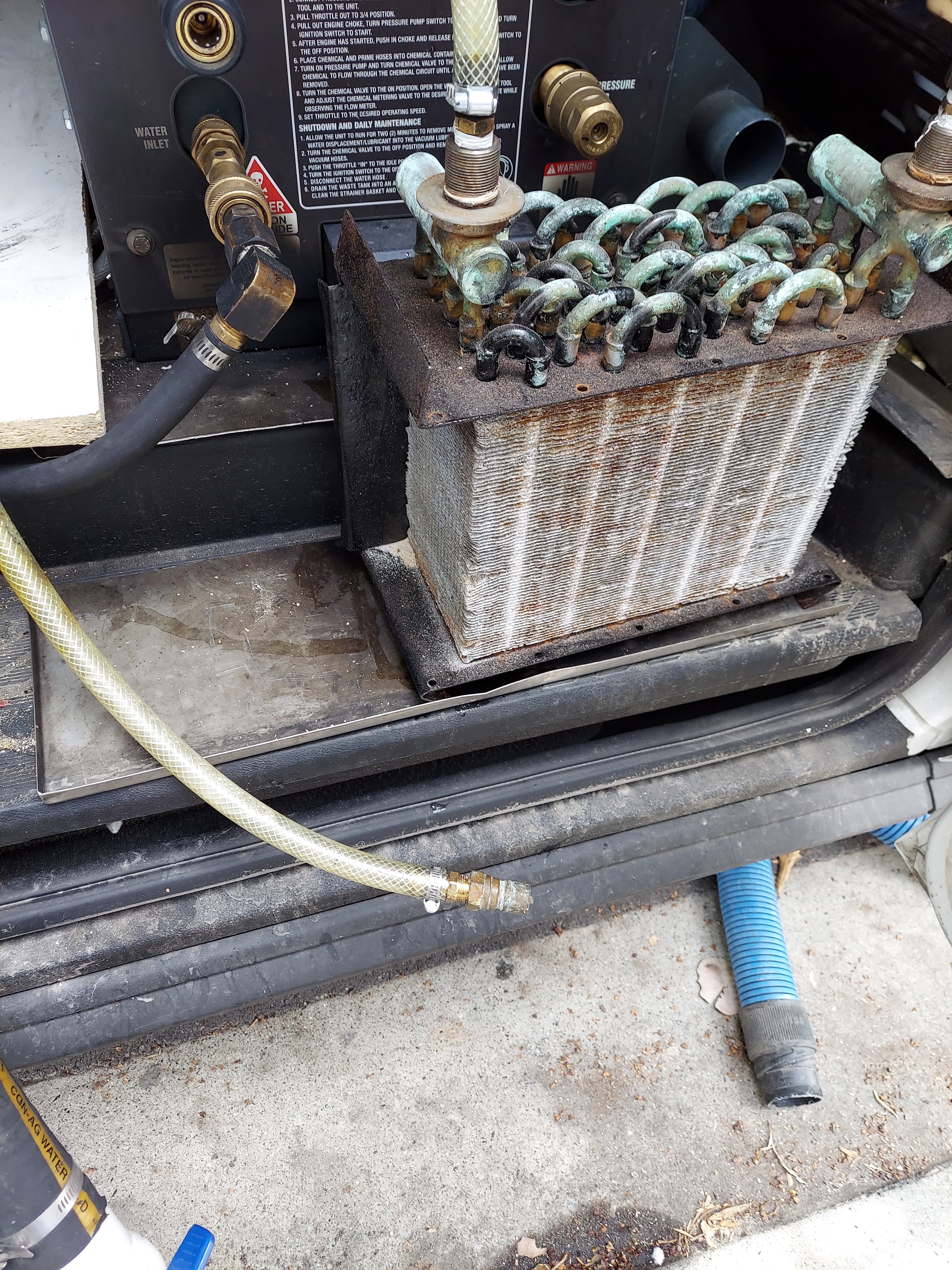

Are you planning on descaling that before you put it in use?

I'm using a higher flow then the 370 is designed for. I don't have an issue IF I used the TM as it is designed for. A larger water box might cause other issue.
I will admit my high flow usage causes my transfer pump sometimes overheat and stop working.
yes I do extra extraction passes, but that isn't enough "Off trigger time" to increase the water temp.

But back to your little added HX. Are you gonna descale that ugly thing or not?
