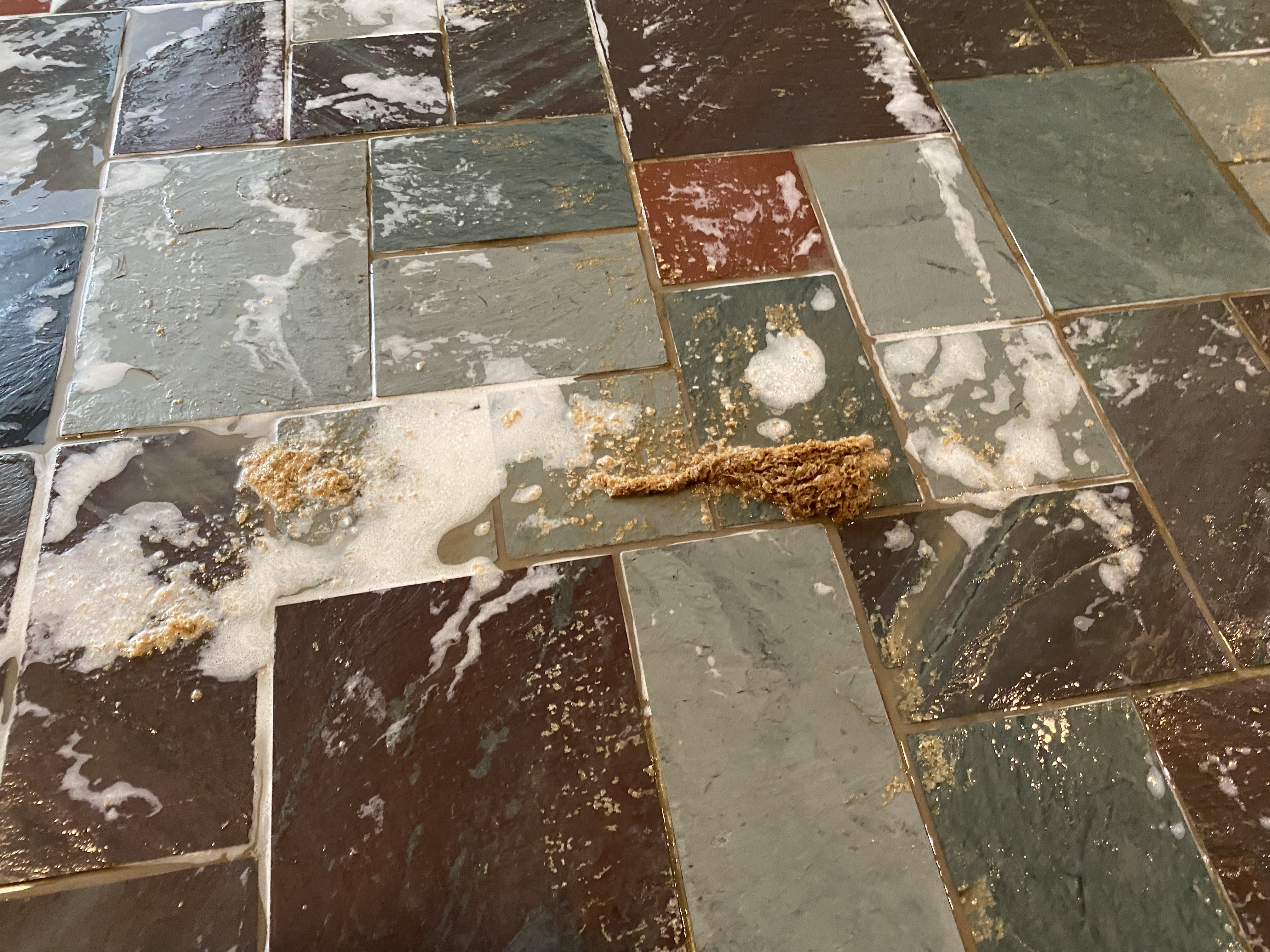

Just before I stuff my face with turkey. I figured I’d reach out to you guys and gals about this. The home floors has 10+ years of wax buildup. I got a great portion off.
What is a good way of removing embedded wax in the grout? Would a metal brush be the best option?
I stripped it twice with 30 minute dwell times. Some grout has some wax and it is yellow in various spots.
2DBED538-F368-4D41-ABE3-FDC2C8CF3851.jpeg 585562AD-8613-45EE-9FA2-B1128CEC7750.jpeg

Spray stripper REALLY STRONG on the grout. Dwell, then rip it off with the steel toothbrush. Slow and not much fun. Maybe colour seal.Great job on the tiles.
Thank you. I figured I was going to have to pull this out.
