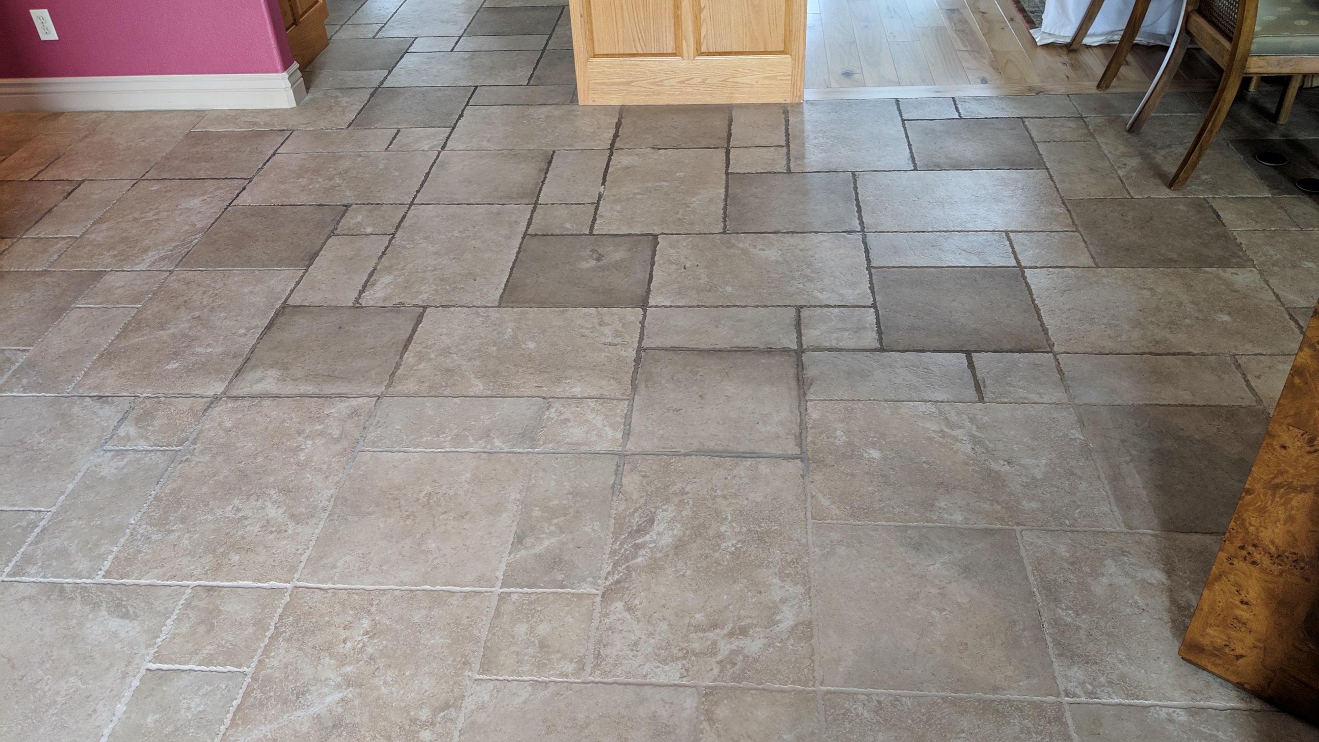

Feb 4, 2019 #1 Mikey P Administrator Joined Oct 6, 2006 Messages 115,966 Location The High Chapperal Some goober put siliconized grout all over this porcelain travertine... Reactions: Mark Saiger
Feb 4, 2019 #2 Cleanworks Moderator Joined Oct 22, 2012 Messages 27,863 Location New Westminster,BC Name Ron Marriott So whatcha gonna do about it?
Feb 4, 2019 #3 Mikey P Administrator Joined Oct 6, 2006 Messages 115,966 Location The High Chapperal Malish, stripper and reseal. Patch grout work SGA as needed Reactions: Stephen D. Gillett and Cleanworks
Feb 4, 2019 #4 hogjowl Idiot™ Joined Oct 7, 2006 Messages 49,300 Location Prattville, Alabama Which is which?
Feb 4, 2019 #5 Mikey P Administrator Joined Oct 6, 2006 Messages 115,966 Location The High Chapperal Foreground was under a rug
