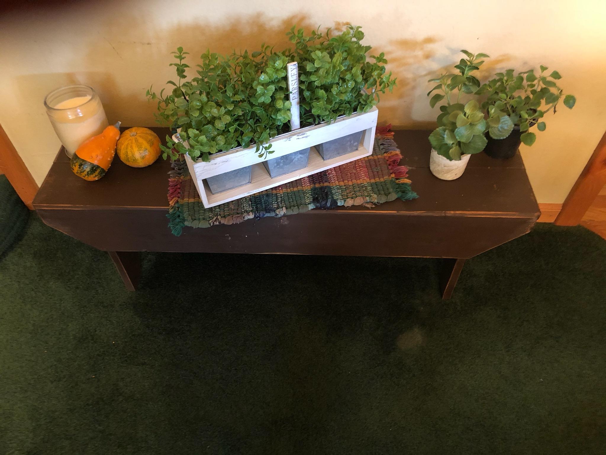

Had one not long ago. Called by a housekeeping service to one of their clients homes. Small spots, on a dark grey.
Had to clean a bunch surrounding it to not feel guilty, the repair went so quick.

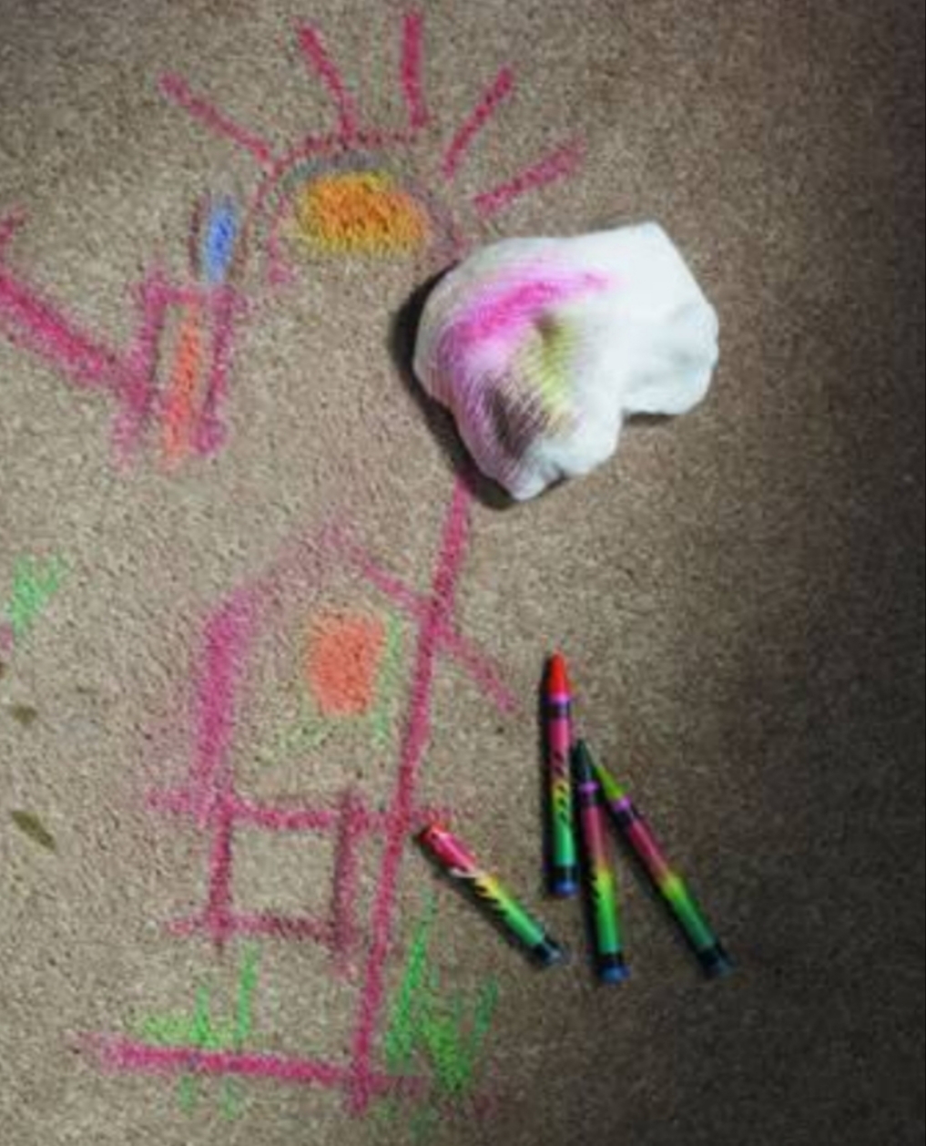

Wax crayons are better.
Use a hair dryer to melt the wax into the fiber.
It's permanent. 😉
If working on Sisal, use boot polish, you may need to mix different colors to obtain the correct color.
Some can even be done (rental vacates) using chalk. :icon_twisted:😱
It's permanent. 😉
🤔:yoda::very_drunk::arrrr:
I've watched Tony W demo that a few times, never trusted my mild colorblindness to attempt it.
I recall him using a clothes iron, not a hair dryer?
