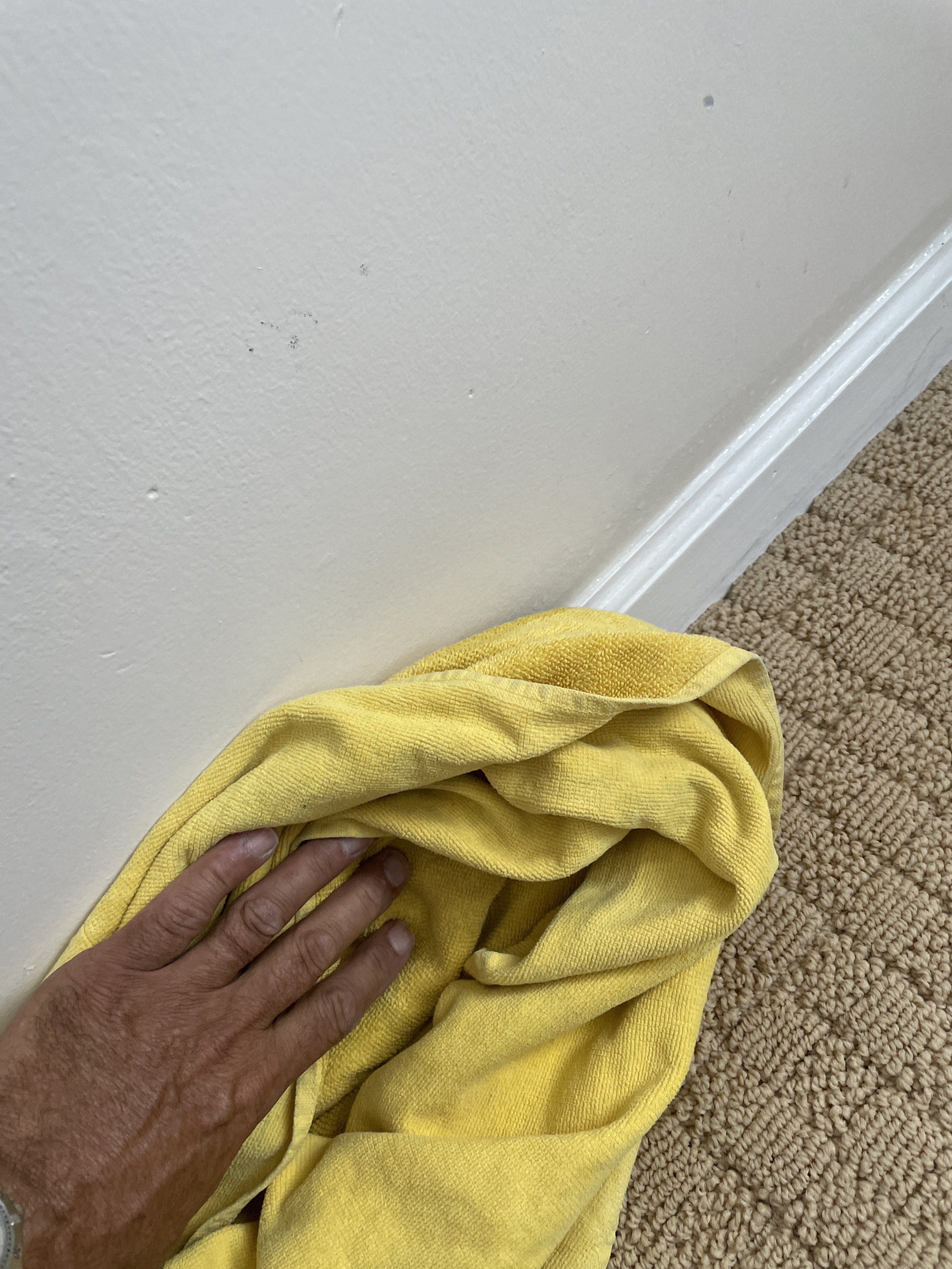

Baseboards

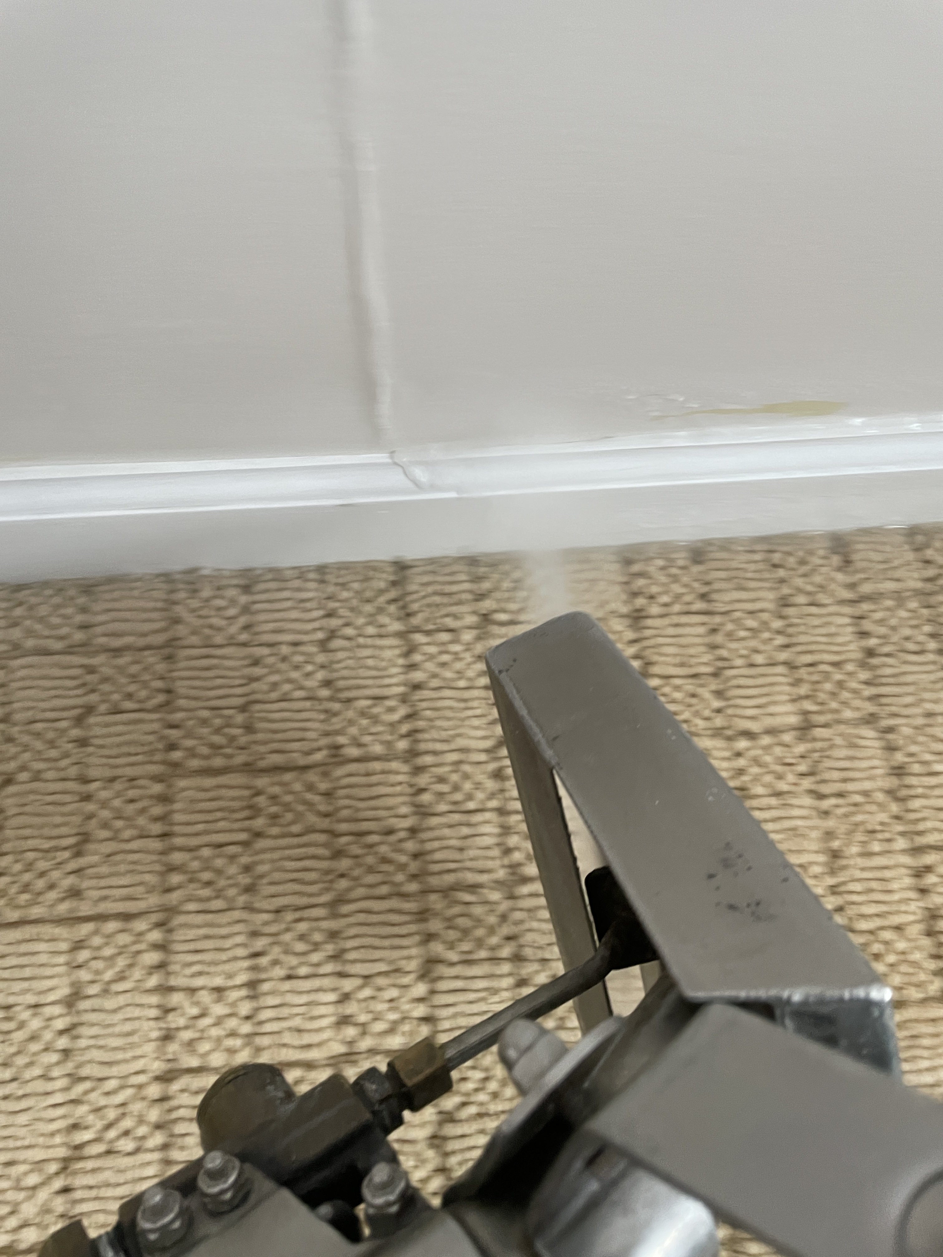

Baseboard makes a cleaner premium?
when baseboards are loaded with crusted dust throughout entire home, that’s their lazy problem. And no, wiping their preexisting dirty baseboards ain’t called ‘extra touch’
if I make the mess, I wipe.
Not the extra touch, I go the extra Mile. And baseboards do stand out when zinged clean. Also gets the crevice better than just dry vac when nailing it with a stair tool. That is premium.
The lazier they are, all the better. I am a cleaner, they are the customer with the $.
Been through burnout, slow times, anxiety over the future. Kept focused and nowI am at the "If you love your occupation, you never "work" a day in your life" stage.
And it keeps it fun. Since I have near 100% customer retention, when I am there the next year I look for dust I missed from the year before.
If they are not crusty or nasty, I just hit them with a Norwex Microfiber mop now as my PMF 1530 is edging properly.
