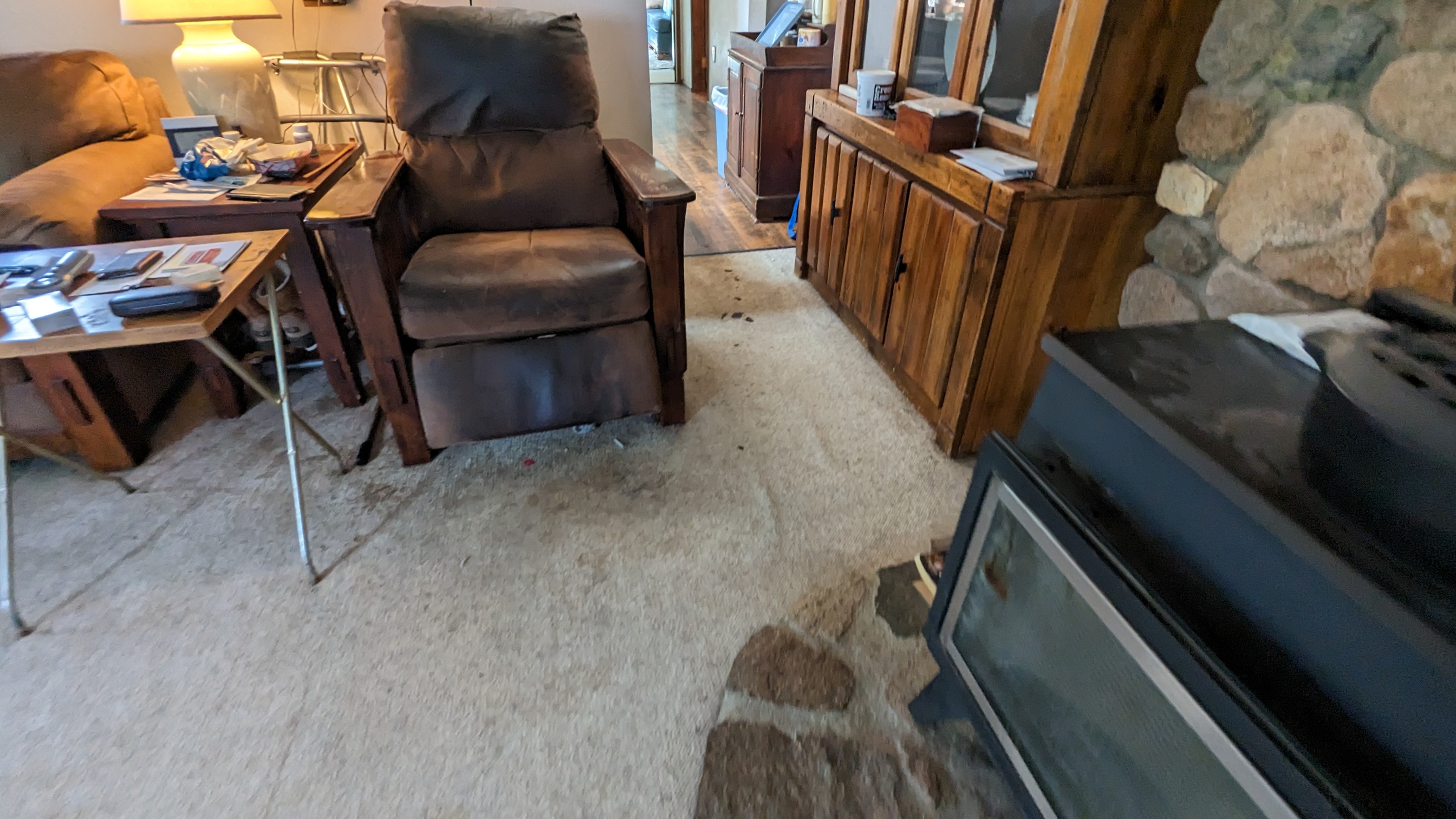

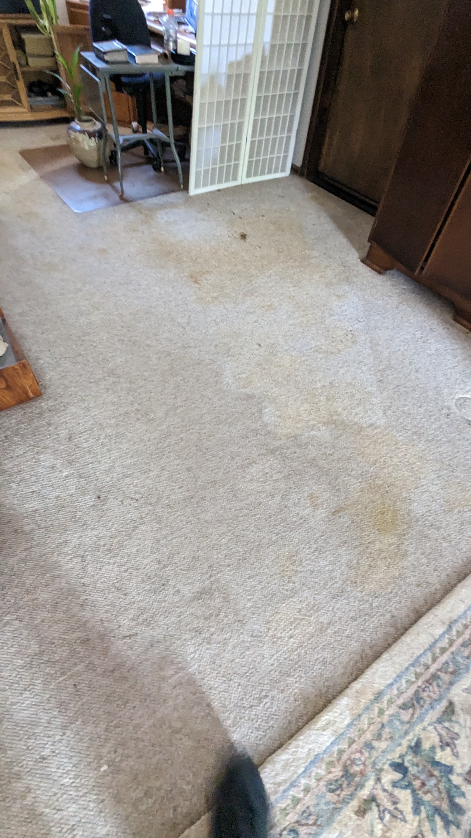

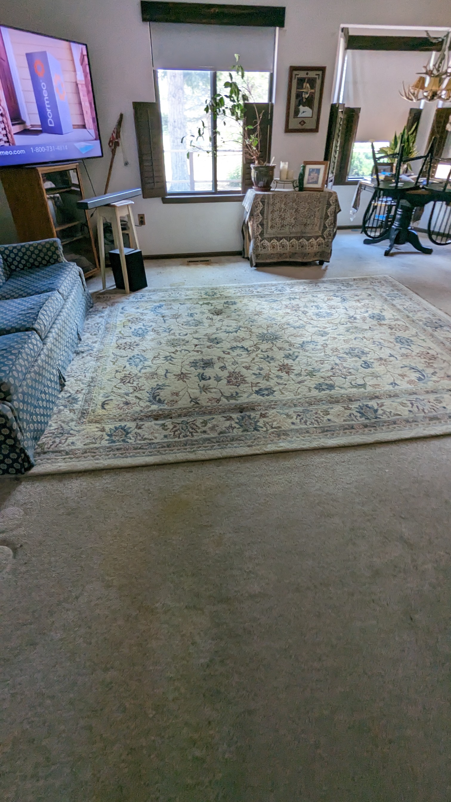

Im sure you hot water heros would have rotary extracted 30 years of large breed dog urine straight out of China here..
I walked.
Old gent needs to go into a home or with a relative and those subfloor needs to be removed PXL_20230608_202720438.jpgPXL_20230608_202728885.jpgPXL_20230608_202734365.jpg.
I walked.
Old gent needs to go into a home or with a relative and those subfloor needs to be removedView attachment 122928View attachment 122929View attachment 122930.
You walked? pansie
Dude, the old dude couldn't afford to replace. so it's either, leave the shit and piss there or clean it and make it better if he has to walk bare foot on it. Don't give me this, "there's bacteria breeding when it gets wet", bullshit. It's currently wet now with his piss.

I'm there to clean the carpet, it's up to the customer to get it dry. I do as many dry strokes as possible. I explain drying options for them, then it's on them.
115,925
Why did you walk?
Severely impacted with 30 plus years of dry soil.
Severely flooded with urine and chems
Poor ventilation
Dried piles of diarrhea all over.
I would have had to charge $1000 to make it worth cleaning all my tools and tank, and the finished results might have been worth $100.
