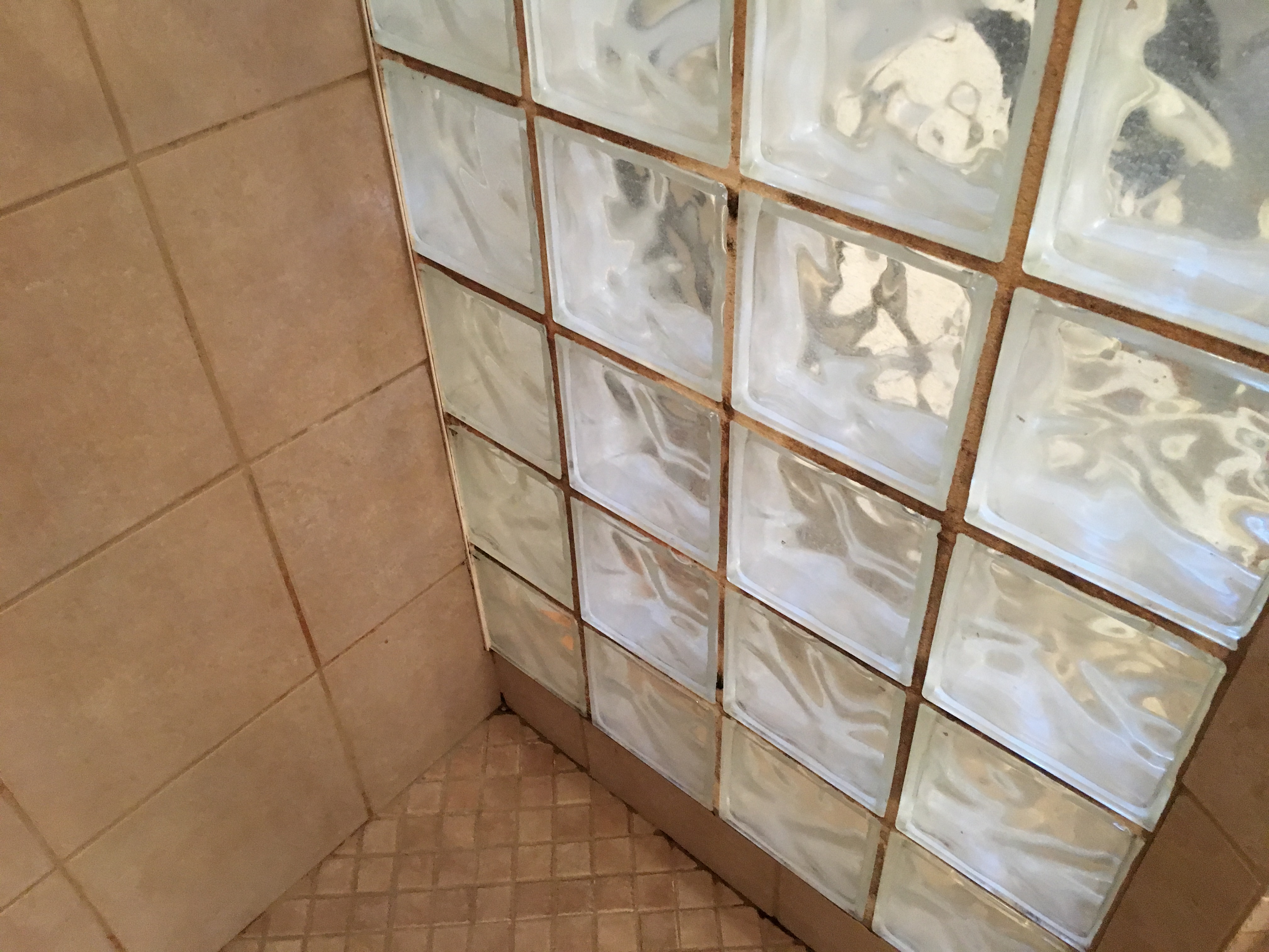

Sometimes the glass blocks aren't glass. There are plastic glass blocks...for some reason. Quick check before you throw acid on it.

I've just placed the order of the water stain remover and the steel wool. I scheduled this job for the 10th of January, so I'll let you know how it goes. I don't know if you saw that tile also... This tile is 7years old and has never been sealed. So I"m gonna have some major mildew stain problems also
