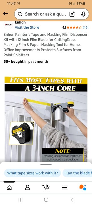

Got turned on to this painters film for masking off appliances early on and ive had a tool like pictured below i used/use when masking off vehicles for paint. Ive been searching (although not very hard) for something like waxed paper ( more water resistant than vehicle masking paper)to apply with this tool for larger areas like cabinets and walls. I have blades for paper up to 18". For now ive been applying prespray at extremely low pressure away from cabinets and baseboards and moving it with a deck brush

I have used stuff like that.
I just find its easier to pour it right where I need it.
When im done I dont have to walk back over it or haul away all that stuff.
Why atomize it at all?
So much less stuff to keep in the van and maintain too. Keep it simple.
But I realize I might be the only one doing it this way. Ive mentioned this several times and nobody seems to get it. Everyone wants to spray tile products i guess.
