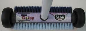

Commerical jobs I have 1 person using the Cimex (weight is like 100pds??) with fiber plus pads gravity feeding the prespray down. For residential, I use a windsor dri-matic weight is like10pds? (aka Sebo). They work for me. I used to prespray comm. then 175 it with a shampoo brush or a white pad. Cimex works better and easier to use.
