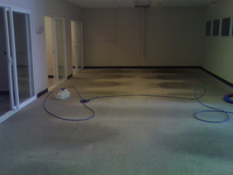

We've replaced 1 carpet, our tech usedd a strong oxidizer that interacted with makeup htat was all over this persons master bedroom and bath.
The meanest I've ever been to a carpet yeilded little results. The photo is the best we could do, sadly it looked like this when we started.
Sometimes there's nothing left to do
It was our 2nd attempt on 1500ft of white gcd olie Berber. After our techs failed the day before, I decided to take 2 guys and lots of determination. We dueled it at 1000psi and used 380 gallons after many scrubs and chemical baths.
I used:
2.5 gallons of stripper, 4 gallons of purple power, 3 gallons of 127 volume peroxide, 2-3 lbs of powdered oxidizer, 4-5 lbs of Attack, 2 gallons of Ultrapac renovate, 1 quart of pigout, and 2 gallons of Hotknife, 2 red pads, tried a stripping brush, and 7 bonnets
I used:
There is only one thing you forgot to do when it was all done and dry... You should have painted it white!!!
