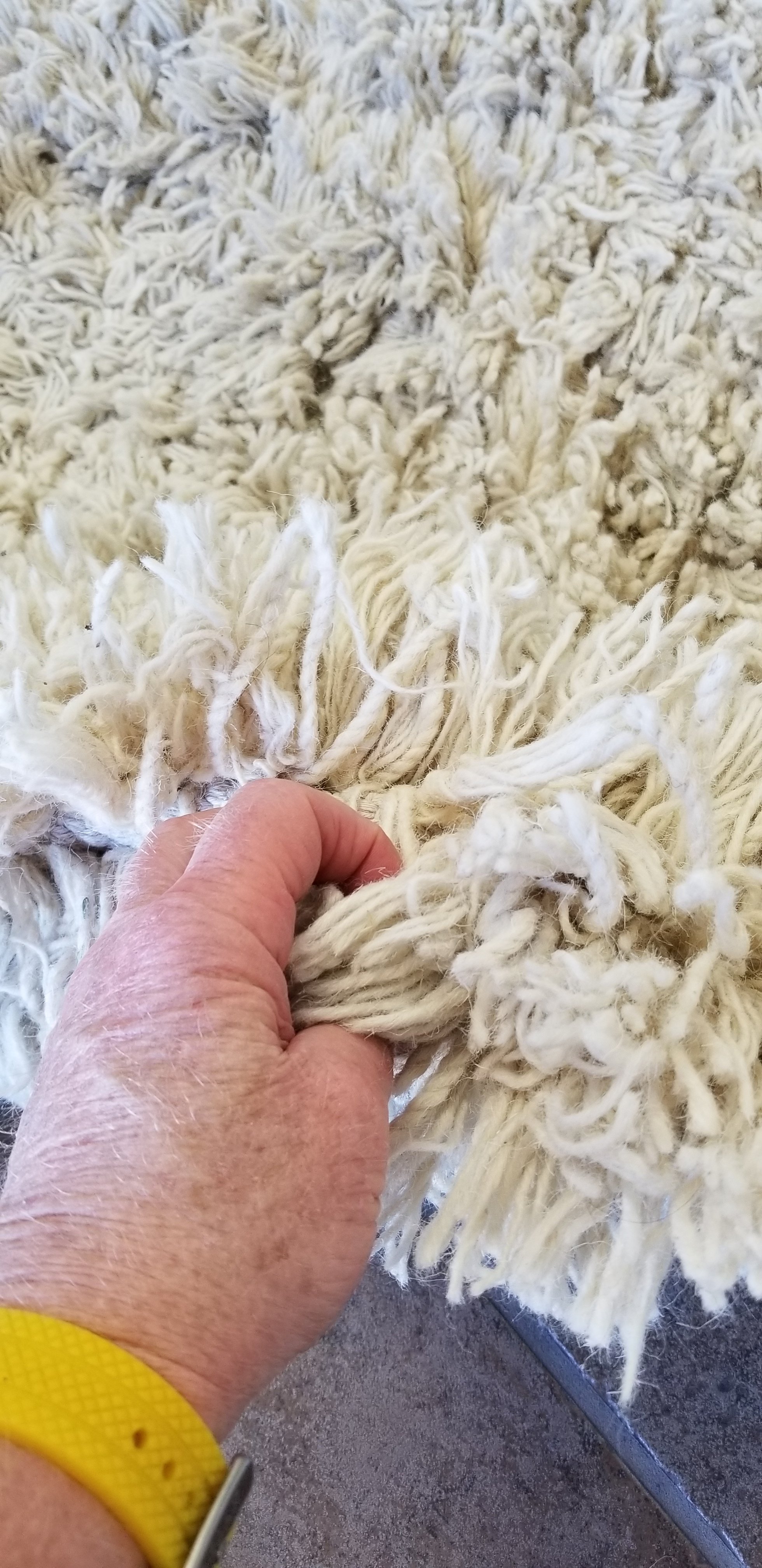

Whats your method for these 2?

The other is rayon, that's vicose rug?

Easy: dust, wash, rinse, spin, dry. We've washed a few of this style with good results and no damage to the rugs themselves. Not as difficult as they look really.

Getting the water removed and drying rapidly will minimize the lions share of problems when cleaning any rug. Especially those thick noodle type rugs.

The viscose rug, inform her that the texture may change and may have a different appearance after cleaning. Clean at their risk. The noodle rug is a pain but is washable.

Jordan King is right. These are not as easy as a good quality knotted wool rug, but they are not that difficult either. The real issue is that they are everywhere. We see a couple a day and there's no end in sight. Restoration Hardware, and their competition, are taking over the rug world.

First critical step is getting them dusted well and safely. Especially the "shag" or "noodle" one. On the later, in my opinion, the Tumble Duster is the most effective way to do so. (Not every plant has one or sadly even dusts at all) However, we do and see its benefit. Our little boutique-ish shop does these types effectively. Yes, our horizontal centrifuge is an essential element in processing rugs of this sort too. Lastly, off to the hot drying room.
