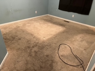

I've never used a RE
I like to use more heat, psi, and flow with a big ass vacuum motor making certain the water is being pulled out. After almost 20years of doing this, I don't see a need for one
You should see the dirt they pull out of the carpet.
