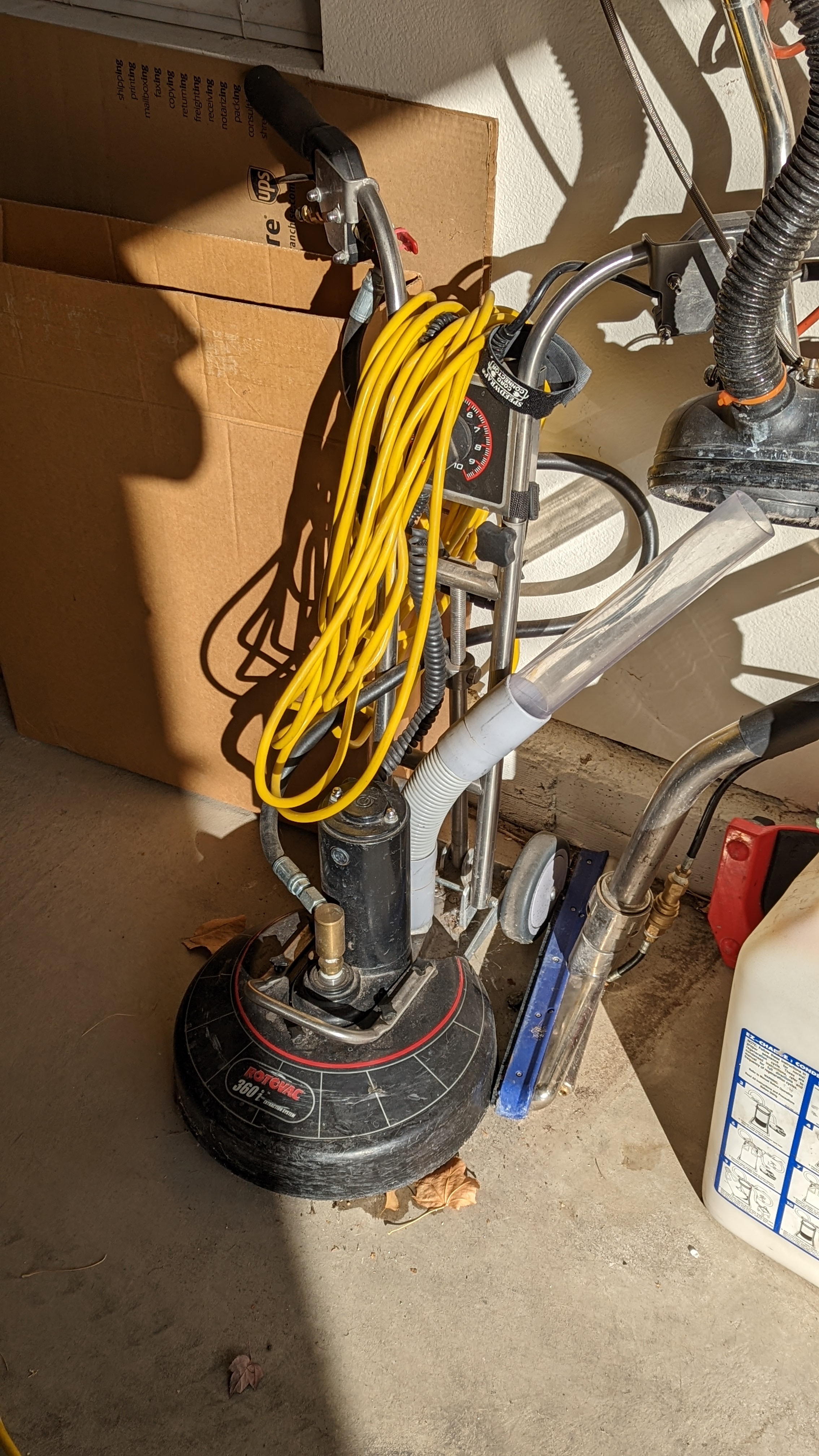

When was the last time you used your rotary extractor?
Trip Moses
IMOL

With the advent of high performance wands, CRBs, and better chemistry, I think these things are going to go the way of the dodo bird..

The negatives are it's slower cleaning and can leave the carpet damper if dry passes are not used. It's also a heavy tank of a tool to unload however it's going to be difficult to out clean it.
I believe that company uses smaller jets and fewer to achieve a drier product.

The company you referenced cleaned that way exclusively 20-30 years ago but even they moved to HWE.

One of my supervisors was visiting his daughter in Fort Worth a couple of years ago. They used a porty with that tool on her apartment and he was very impressed with the results.
He said it looked fantastic and dried really fast. 😲
It helped solidify the use of a Zipper Spinner or 360xl on our carpet trucks.
