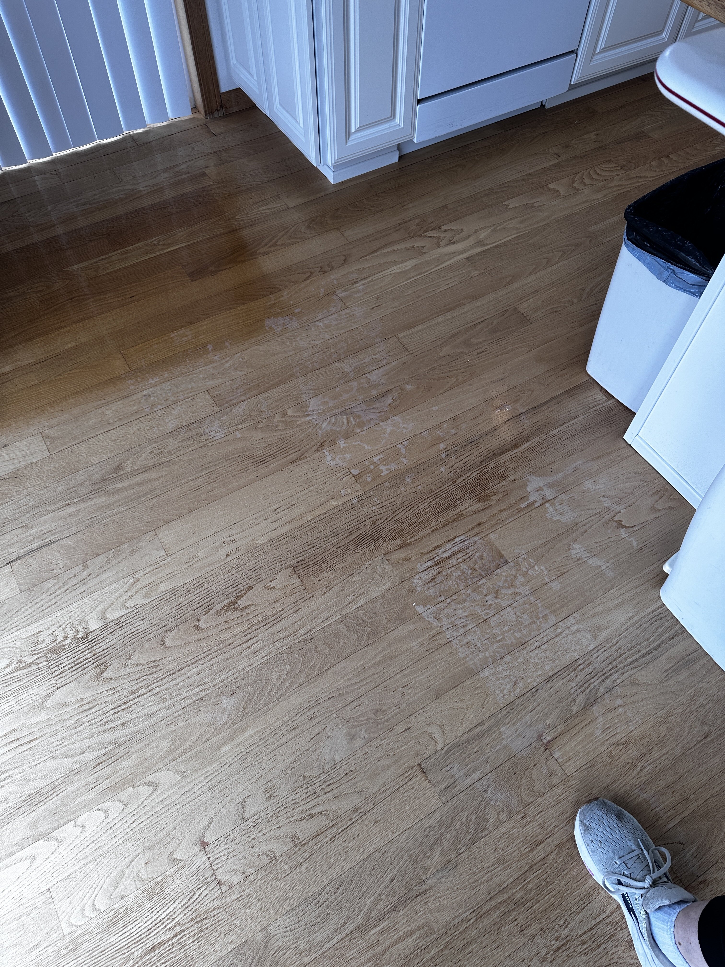

Got a call today from a cleaner who just bought one of my multi-surface wands..
He cleaned a wood floor…
and ended up with white blotchy spots all over it.
After a few questions, here’s what we had:
No prespray
No agitation
Straight wanding with high heat (Everest 870)
Hooked to customer’s hard water
No softener
No idea what had been used on the floor before
And the key detail…
The spots felt sticky as they dried.
What Happened
This floor had a topical coating buildup (Mop & Glo, Rejuvenate, etc.).
He hit it with:
high heat
plain water
no chemistry
no agitation
So instead of cleaning it…
He partially melted and redistributed the coating,
and it dried back as white haze and blotching.

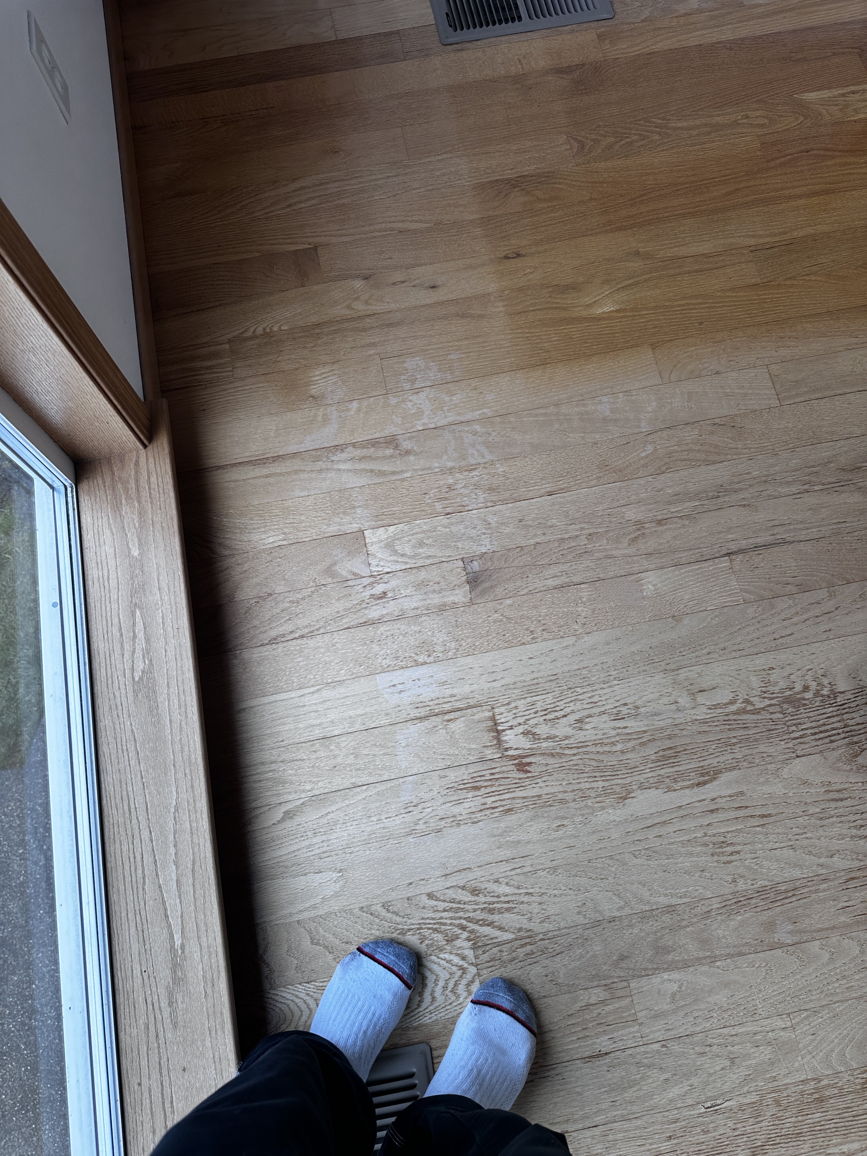

I was cleaning carpet for one of our repeat customers a few days ago, she asked me "can you clean this wood floor? It used to look good but just doesn't clean up well anymore..."
I scratched it and felt a tiny smoosh under my finger nail and saw my nail leave a scratch mark across the surface of the wood, then I saw the random haziness scattered in the glare of the light hitting the floor. Then we had a chat about her evil box store topical "restore" products, and I told her that she needs someone who specializes in wood floors to come and strip the coating off and clean it, and it is a specialty service that we do not offer.
She said "but can't you just steam clean it?" I told her I wish I could, but heat will not be helpful, and I'd only be cleaning the wax coating on top which will create a lot more hazy weirdness. And to remove the wax coating I'd need to use stripper, and I don't know how to do that without causing moisture damage to the wood, but I do know that anything I do will most likely cause problems.
You need to call someone that specializes in wood floor cleaning and refinishing M'am.

Wise move Bryce, THAT floor is nothing but trouble.
117,283
That being said I would love to take an OP machine neutral cleaner and a magic eraser pad and run it over it to see what that would accomplish..
It's entirely likely it's just a collection of foot oils, dog hair oils, cooking oils and "make it shine like new" added polymers...
No prespray
No agitation
No softener
And the key detail…
What Happened
He hit it with:
high heat
plain water
no chemistry
no agitation

View attachment 134624View attachment 134625
