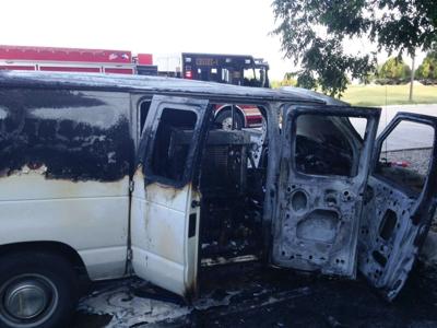

Hottest...at some point before 911 got there.
