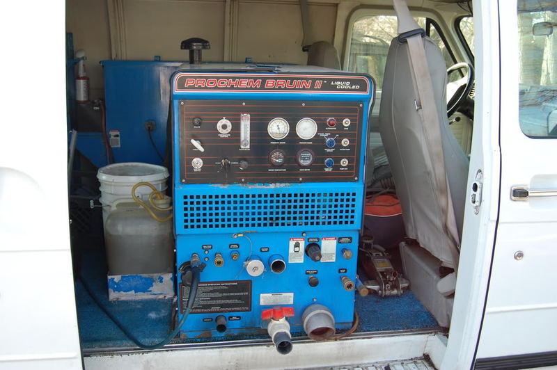

I sold my trailer mount and am looking at these two truckmounts. I am not really familiar with either so any input would be appreciated. Thanks!
89 GMC S30 van with Hydramaster 4.7 CDS Truckmount carpet cleaning machine.Van has new carburator, recent tune up,very good tires, new battery,and good interior.This carpet cleaning van is an ex-state vehicle professionally maintained by U.N.R. $4000
I have a 1995 chevy g30 1 ton van set up with a prochem bruin2 liquid cooled 3 cylinder duel wand capable,ready to work carpet cleaning unit, the van is in good condition,runs very well and has been well maintained, the unit inside only has 3500 hours on it(which is nothing for this unit)and also has been well maintained and runs great. the set up comes with 2 wands,1 upholstery/stair tool,enough chemicls to work for a month before needing more,2 prespray bottles,and 300 feet of vaccum and solution hoses, also comes with water hose $5500

I would not buy that Prochem Bruin II
If you look at the picture carefully you will see that pressure gauge has been sprung which is telling me that the machine has FREEZE DAMAGE.
Good Catch Steve..
So that's a good sign of prior freeze issues up here in cold country?
Good to know...
