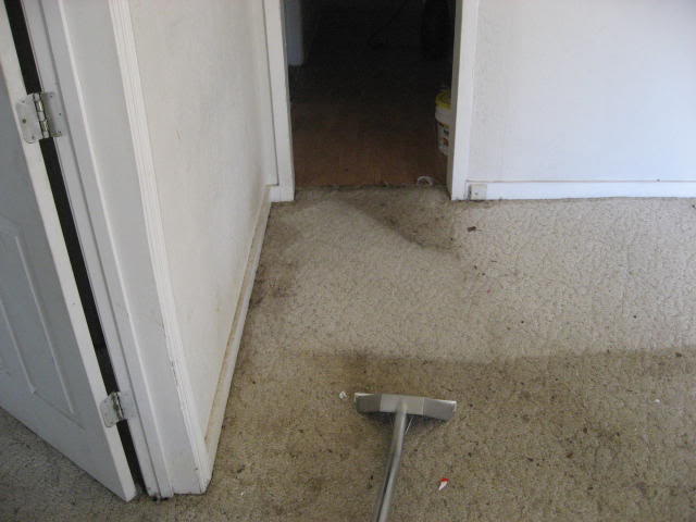

who's afraid of dirt....
a typical empty in a student rental town
no big deal, just a normal dose of PowerBurst at appx 300sf pr RTU gal will get it cleaned to the level they're willing to pay
heat helps..
this one is for you vEEgs..
Normal duty cycle with our 09 flow Ti.
BTW, "normal" duty cycle for us in "empties" is 15-20 seconds on, 2-4 off.
In res we do slow dry strokes, but not in empty rentals

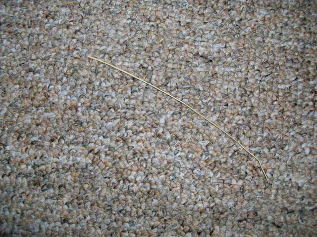

Look what I found...
49,731
Now, imagine running across that piece of straw every 4 or 5 feet, in ever room, of every apartment. Your vac won't pick it up. It clogs up your wand. All you can do it cuff it up.
PITA
Vancouver
PITA
Rake. And if it clogs up the wand with that V blower, you may try attaching the vacuum hose to the machine. It should be in the owners manual instructions.
49,731
Well, in your own left handed, down under way, you have hit a point. My bad memories in relation to the straw are all associated with a 36 blower. I haven't gone through the rental turnover season with my new V yet. The 6008 blower might just make a difference, if I weren't using a glided wand. No way that straw is going up a hole in the hole glide.

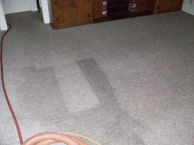

MeAt, do you clean dirty rentals too? :lol:
I've done many that were worse than that in a month or two. Gotta love cheap olefin crap.. :roll:
This one was 3 months old:
Fon Johnson
Oct 15, 2006
1,066
Larry B said:
OMG Fon must be a hack
He didnt vacuum :lol:
No, I was not going to use my vacuum to suck up all of the crap (not stuff but CRAP, mostly rat) and then use it in another home. I went over ALL of the carpet with the cuff after cleaning, and it was vacuumed later.

OK, I'll go over this one more time. This was a NASTY rental house. I had my Clarke combivac and a bissell. I opted to clean it, and then spend 15 minutes vacuuming with the open cuff to get the large debris. Rat turds were everywhere. I could not use either vac in that house and then use it anywhere else again. I did not want to throw either one away. It obviously had never been vacuumed, and it was amazing how filthy this 3 month old carpet was. It was cleaned up with the open cuff, and vacuumed after it was dry. There was no wick back either. There was grey in a few areas from wear, and this carpet was not a bottom line berber either (just olefin.)
I could not with a clear conscience put a vacuum on that floor and then use it in another house. It was tough on my back to vacuum the large stuff with the cuff, but oh well.
