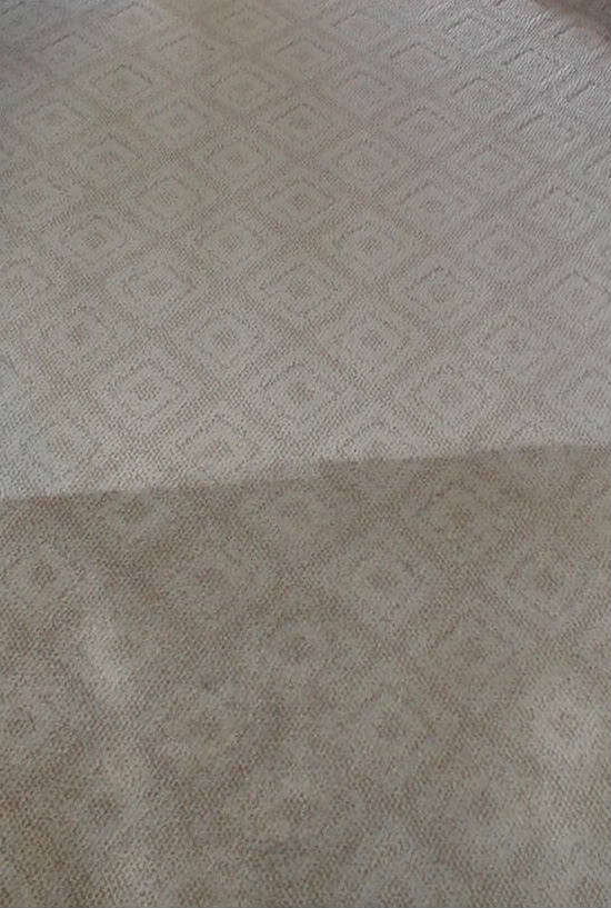

i use to hate it to...
use to being the key word....
hummm i should get those pics and post them from a friends house...
Did encap and cimex on it first....just after i got the cimex...no real difference...
year or so later...it was nasty, wife told her it would be her x-mas present...hit it hard with a spray combo and ran the rinse...and BAM fookin ridiculas result...she did it 6 mths later and moved other furniture...i teased her about seeing the dif even with stuff on the edges...
no prescrub nor post pad, was dry in 5 hrs easy...and i hit it hard
did one today pretty nasty threw a blend at it and a little rinse, cranked the heat. spots gone, traffic areas still there....duh but lightened....he was askin about dry to but stuff back, told him by the night for sure...bent over to feel it... holy shit was almost dry
love berbers now, throw what ever the funk you want at it, rinse the hell out of it with the heat cranked, and a dry pass... and bam
