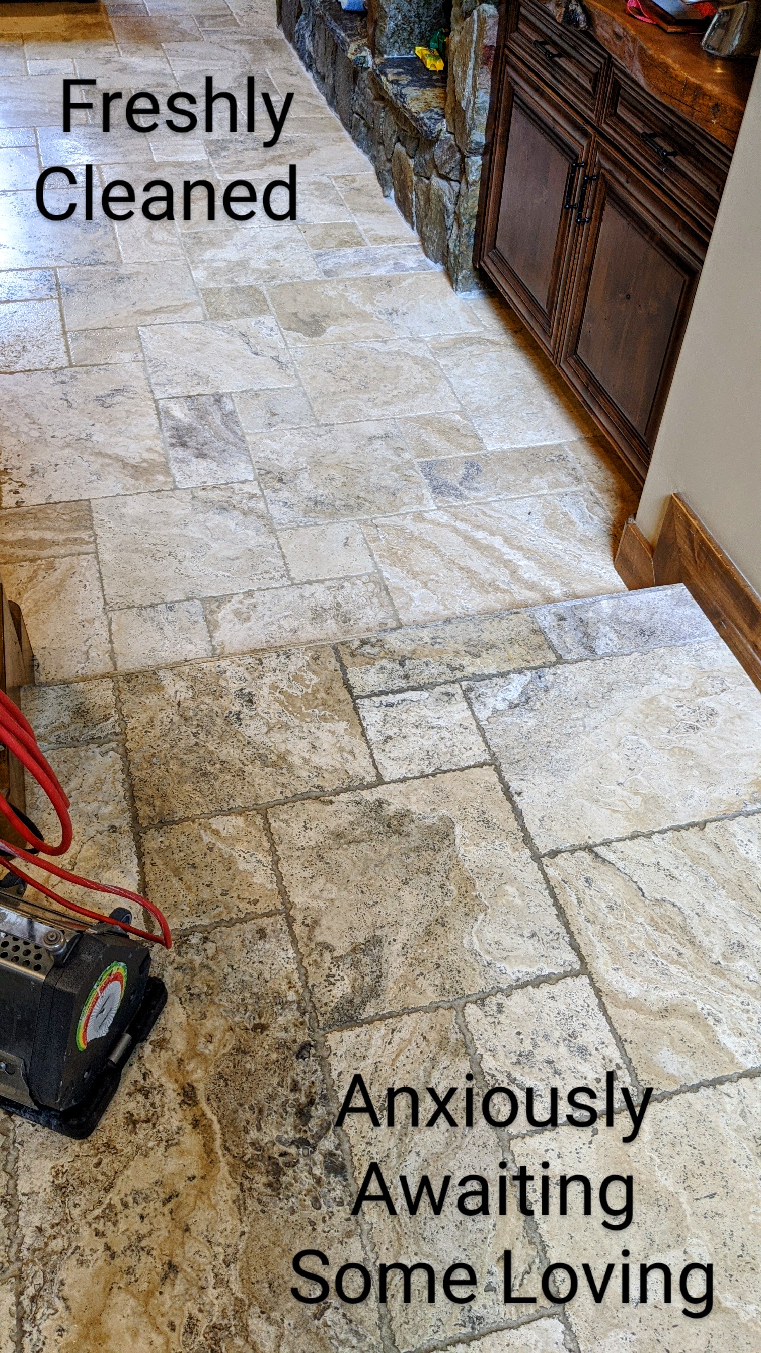

I might have 1000 sf of travertine coming up. Lotta holes to fill, missing grout 1/16" all over the kitchen, deep cleaning and wants it to have sheen again. It might be a painful job.

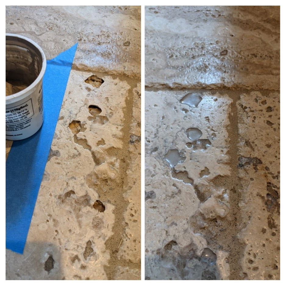

dont sell or promise them on level filling...
Over filling and grinding the holes flat is a pita and you need to charge big bucks.
Most normal humans will be thrilled with a 90% fill with SGA, which take minutes
116,004
If your that deep you might want to shove a bit of back or rod or wadded up paper towel deep down to keep your fill material from falling further

Pretty sure it's compromised mortar all over. She needs a new floor.
