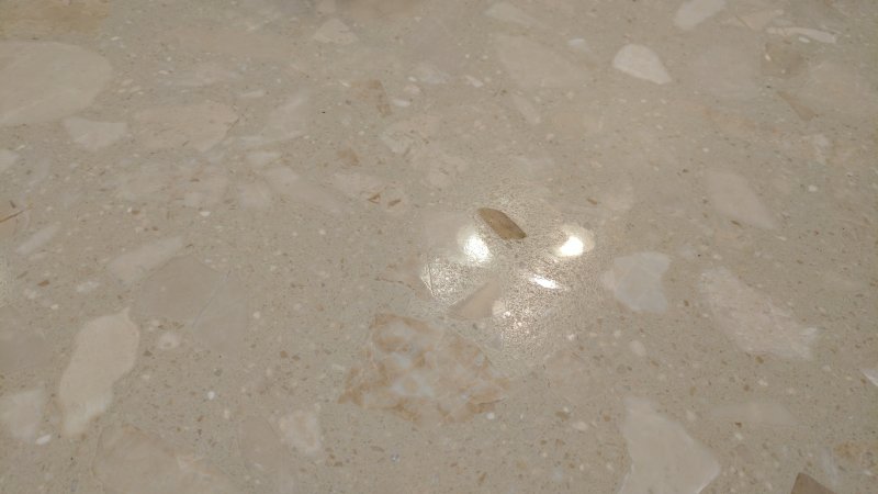

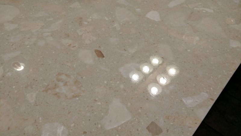

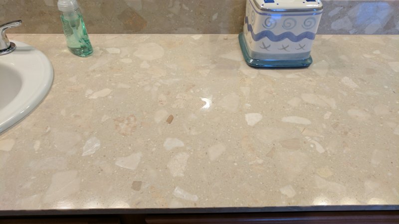

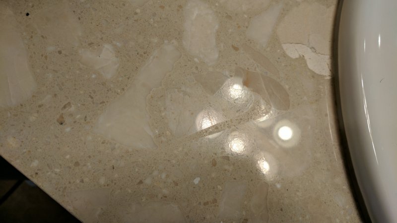

Track house master bath counter..
Owner etched it real bad with Muriatic..
He was able to hand polish some shine back to the large marble chunks but the the surrounding what ever the hell it is..

What's the fix?

The chips I would use glazier from bonstone
The marble, use a rigid driver to minimize any dishing and start with mb22
