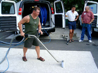

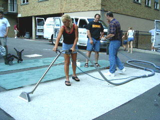

Goop works! Back around '98 we have a Green Guide on two of our Rotovacs. The only thing that held those on was Goop.
GG started in 2004
speaking of which I was cleaning off the greenglides.com folder and kept these two pics in case you want them for the history page
