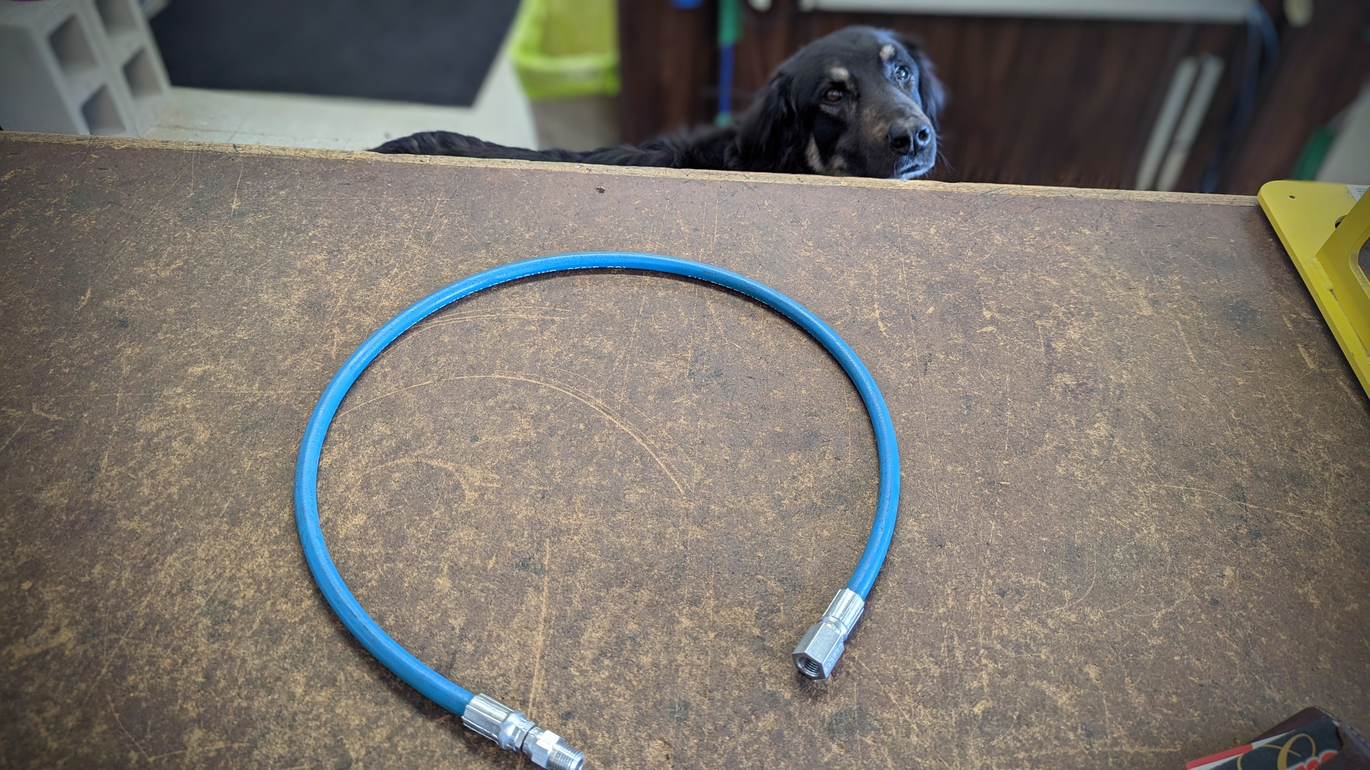

I don't know how a carpet cleaner would ever get by without a Parker fitting store in their neighborhood.

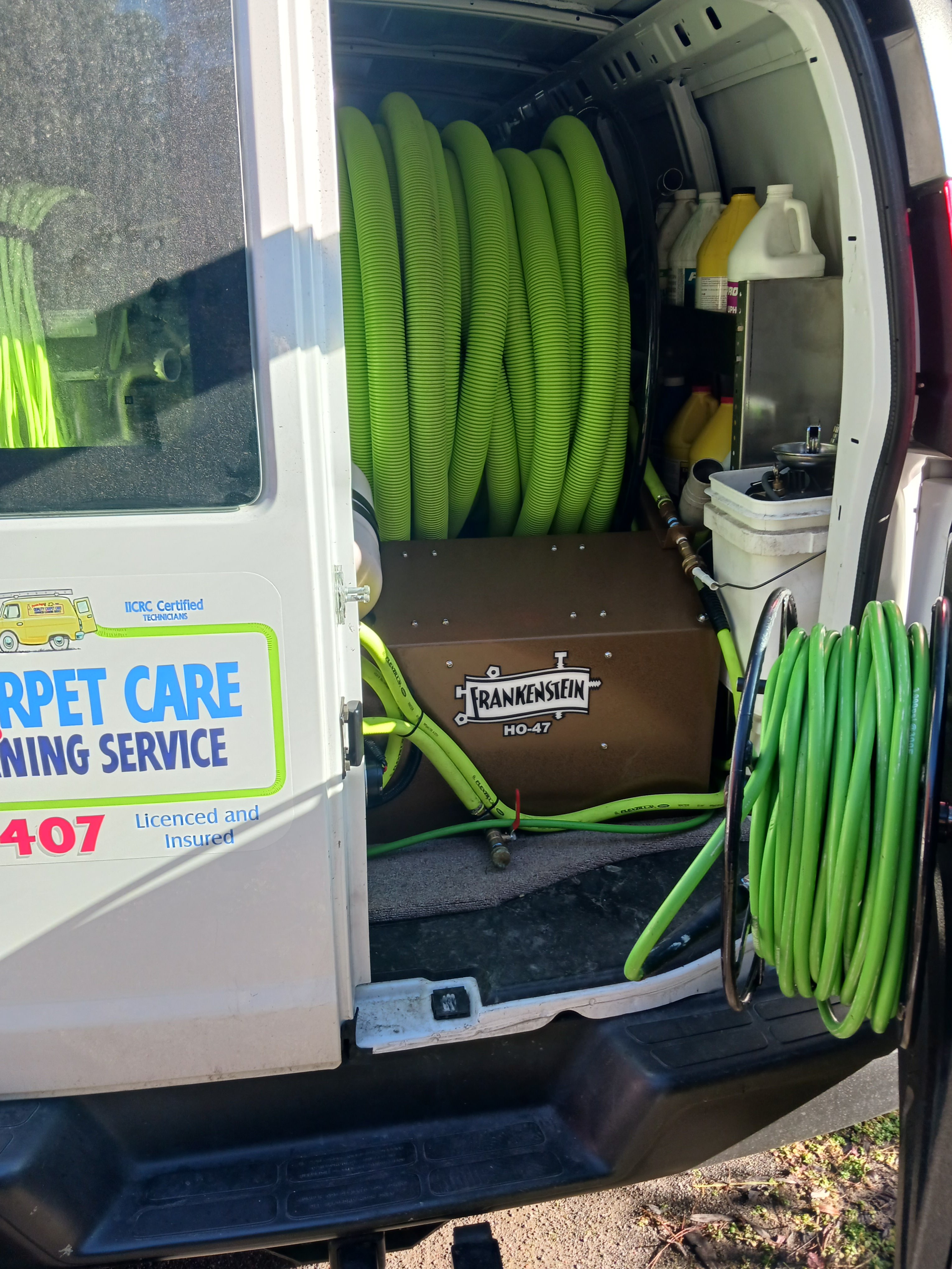

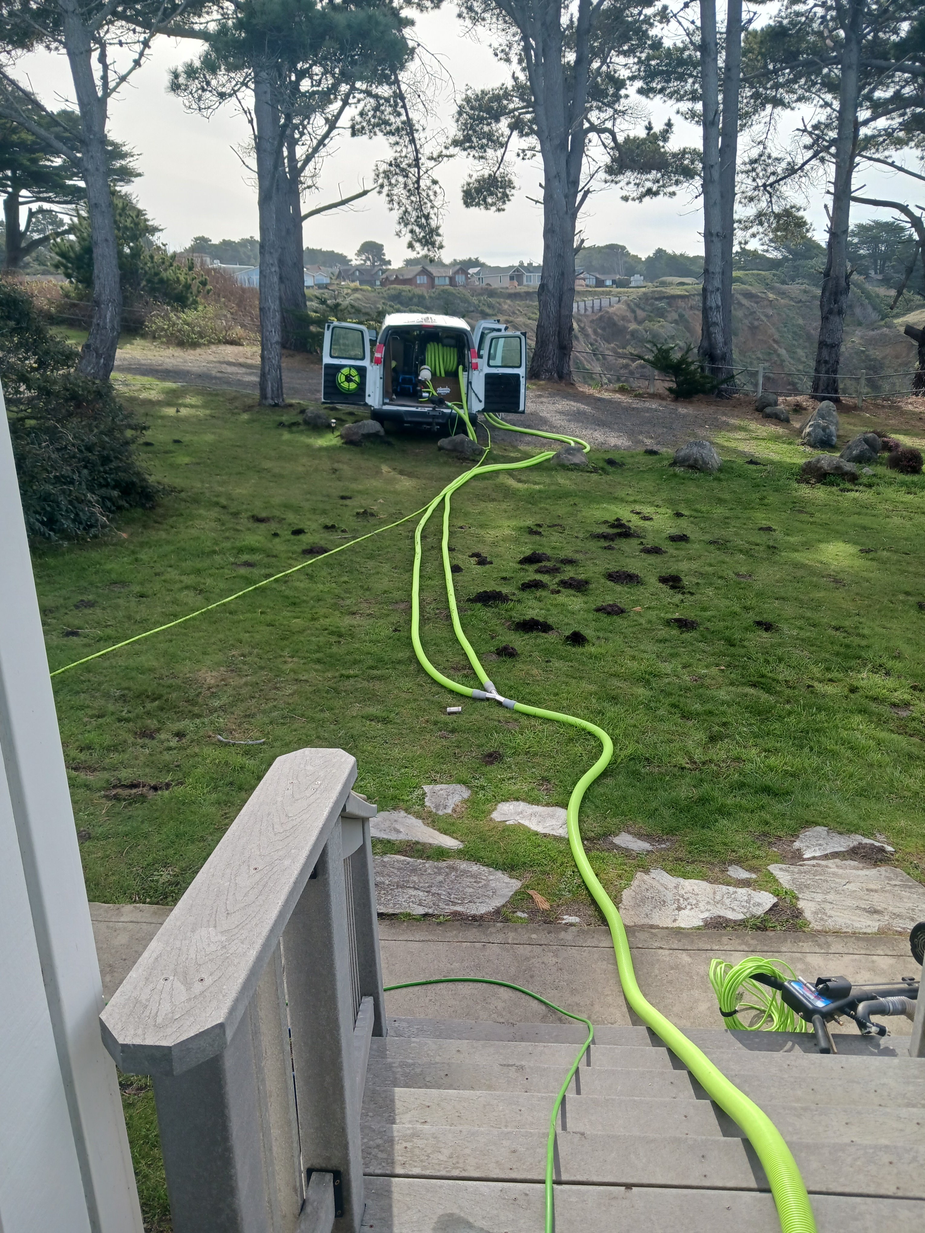

No i had it custom made by Amflex Plastics in oceanside calif you can get the same hose and color from wanders with 1 main difference wanders hose is made by Amflex also but it has black between the ribs of the hose my hose is all green no black (if you look at the blue hose you have now you'll see what im talking about)

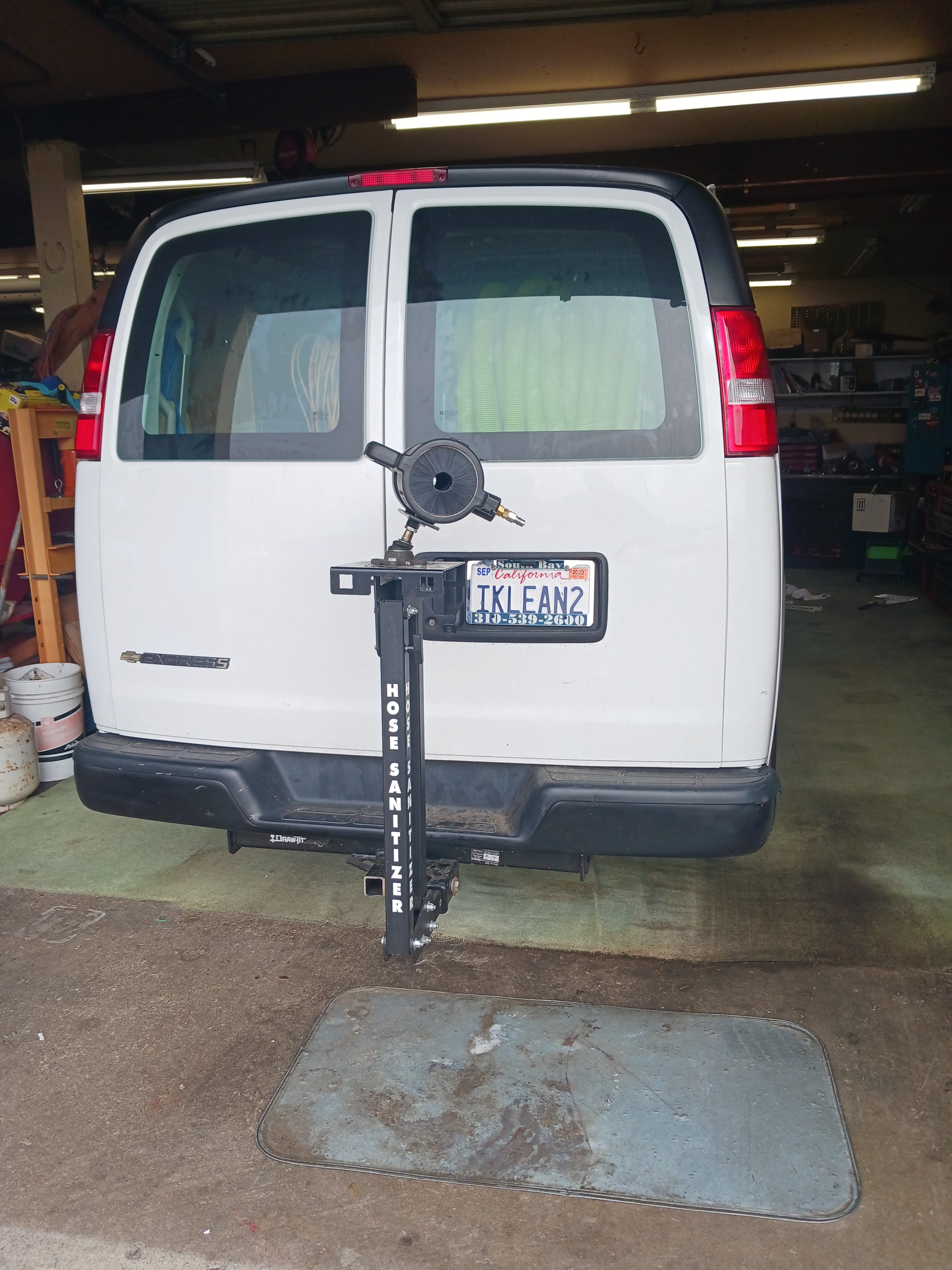

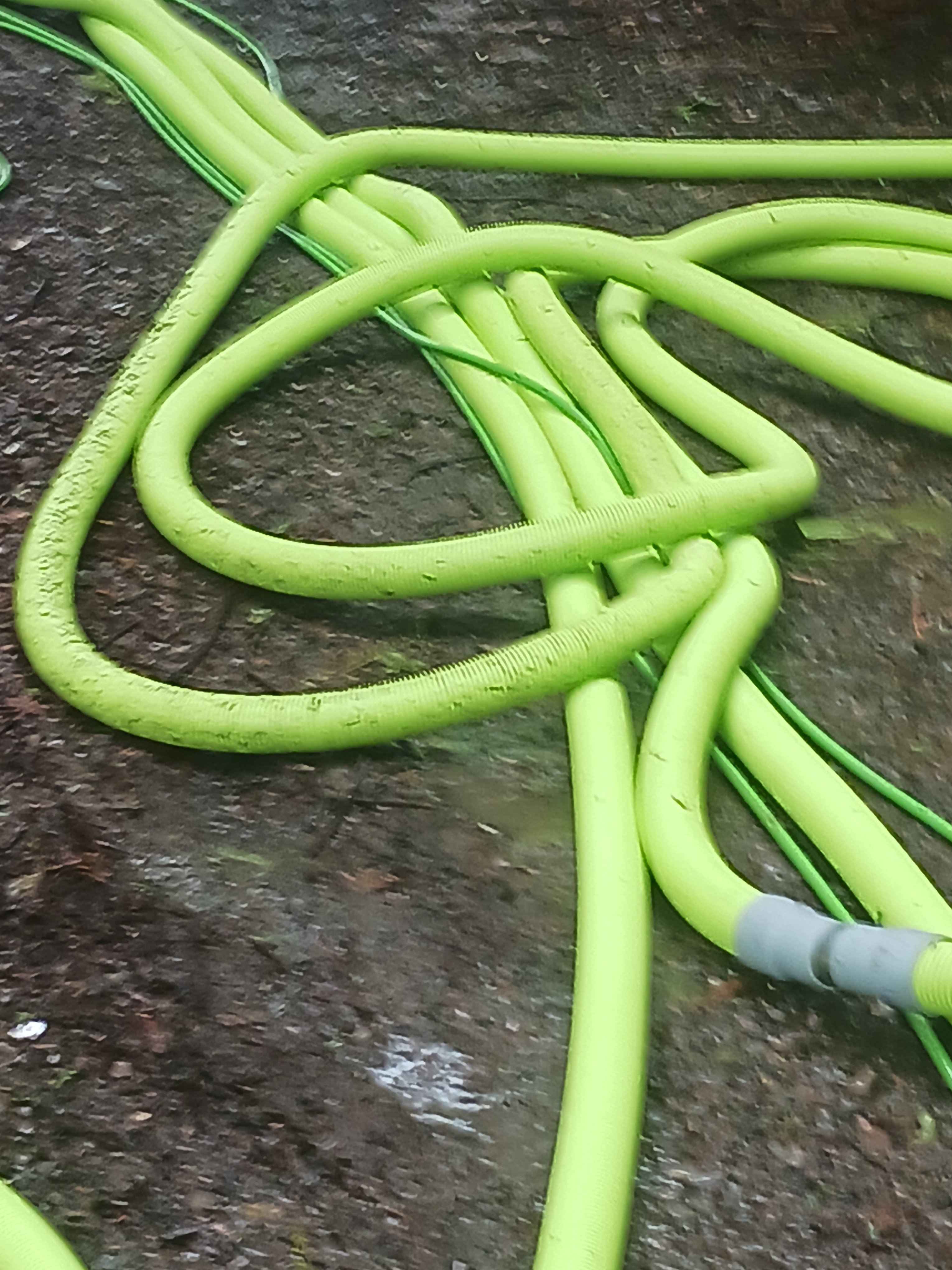

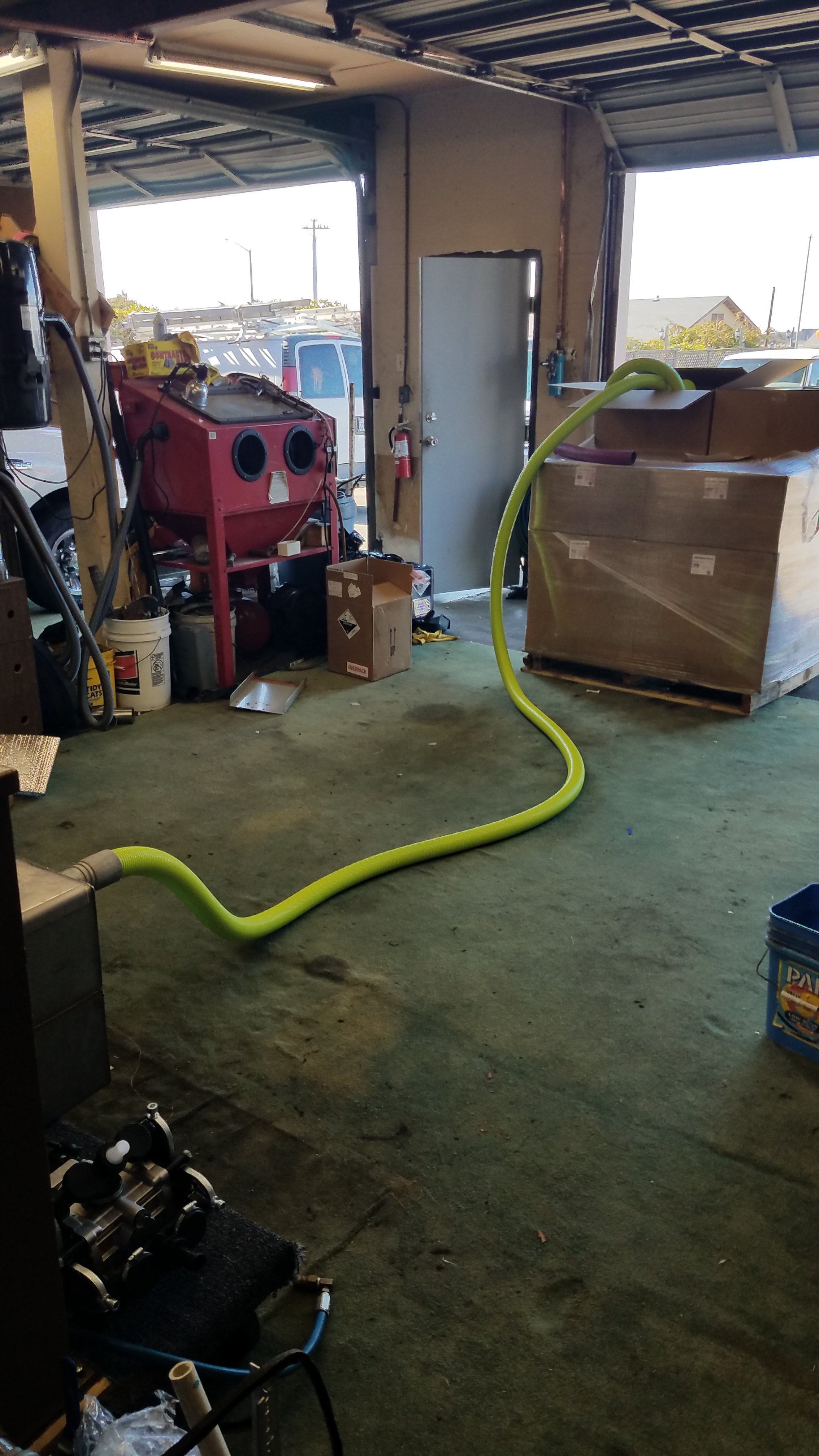

This is whst im talking about when i say no black in my hose all standard hose has it
Dwain Ray
Jul 22, 2020
143
I'm going to have my van wrapped within two weeks and neon green is going to prevail. Is that Joe B's Lil better vacuum hose?

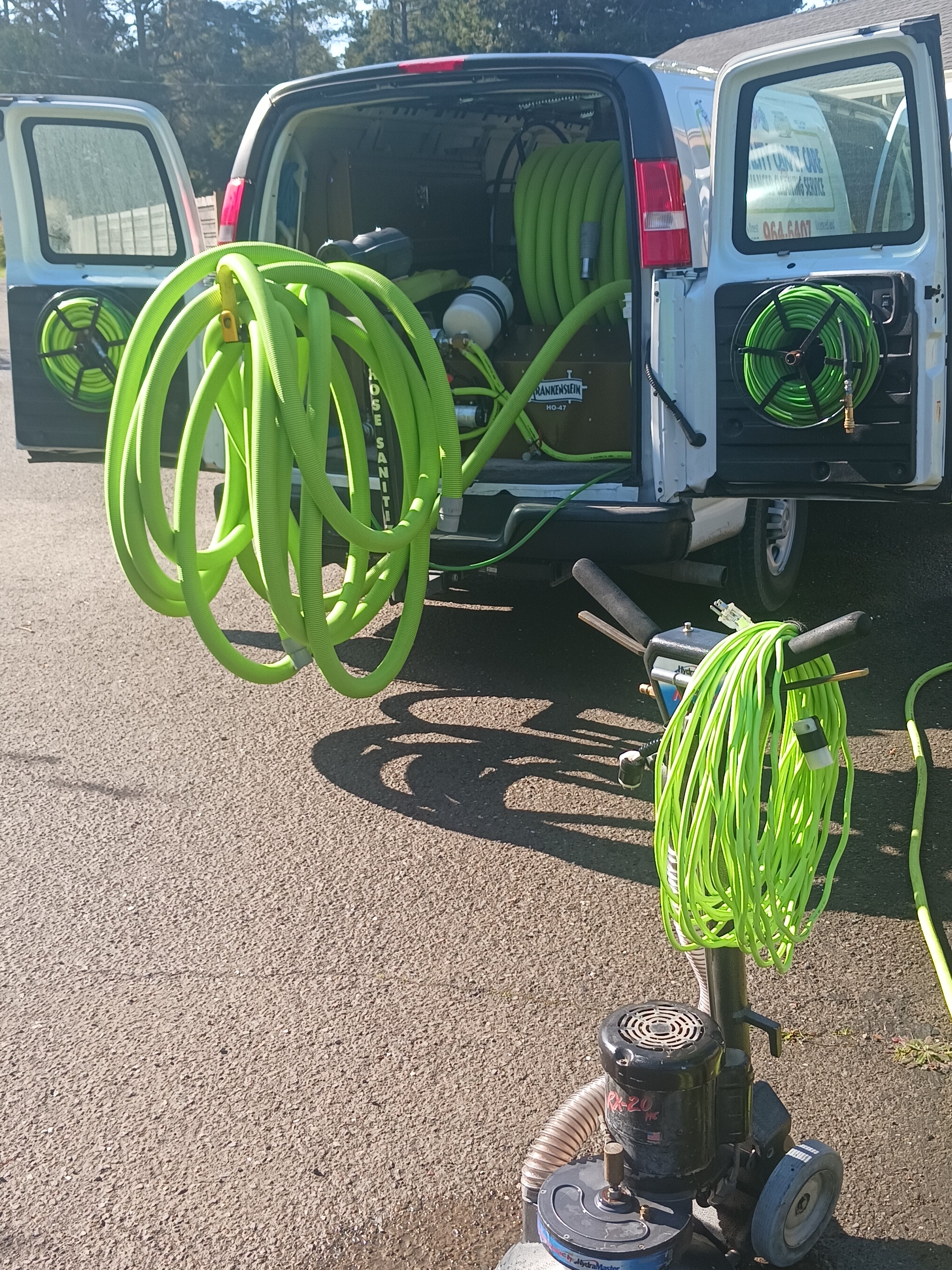

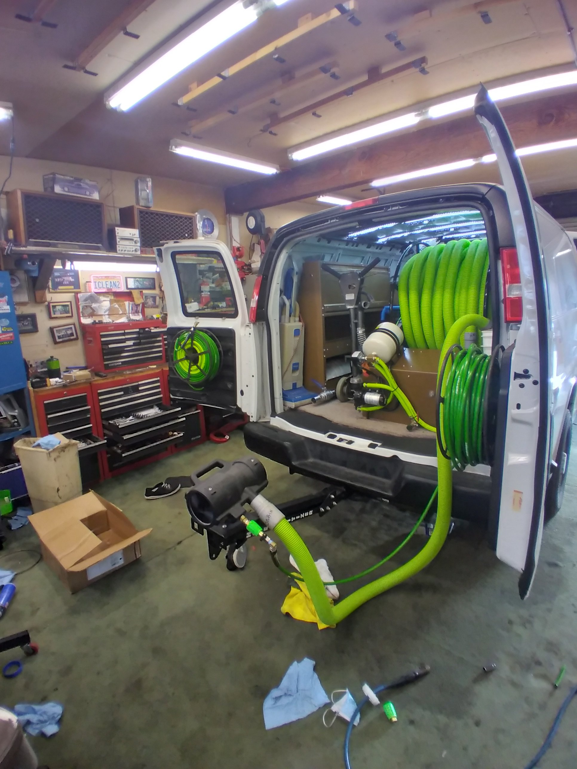

I strongly suggest that if you're going to get neon green hoses invest in a hose washer, one that is easy to use or your new hoses will soon look like sh%$. I clean my hoses with each use,power reeling them thru a hoser@800psi works most of the time,but if they get drug thru mud hand reeling them in slow works great, on rare occasions ive washed while power reeling in then clean while pulling them out real slow and power reeling back in, i work in the country even quite a few multi million dollar homes have dirt driveways its a must for me
20230216_114123.jpg 20230314_123734.jpg 20230303_101526.jpg 20220725_181713.jpg 20220928_162042.jpg

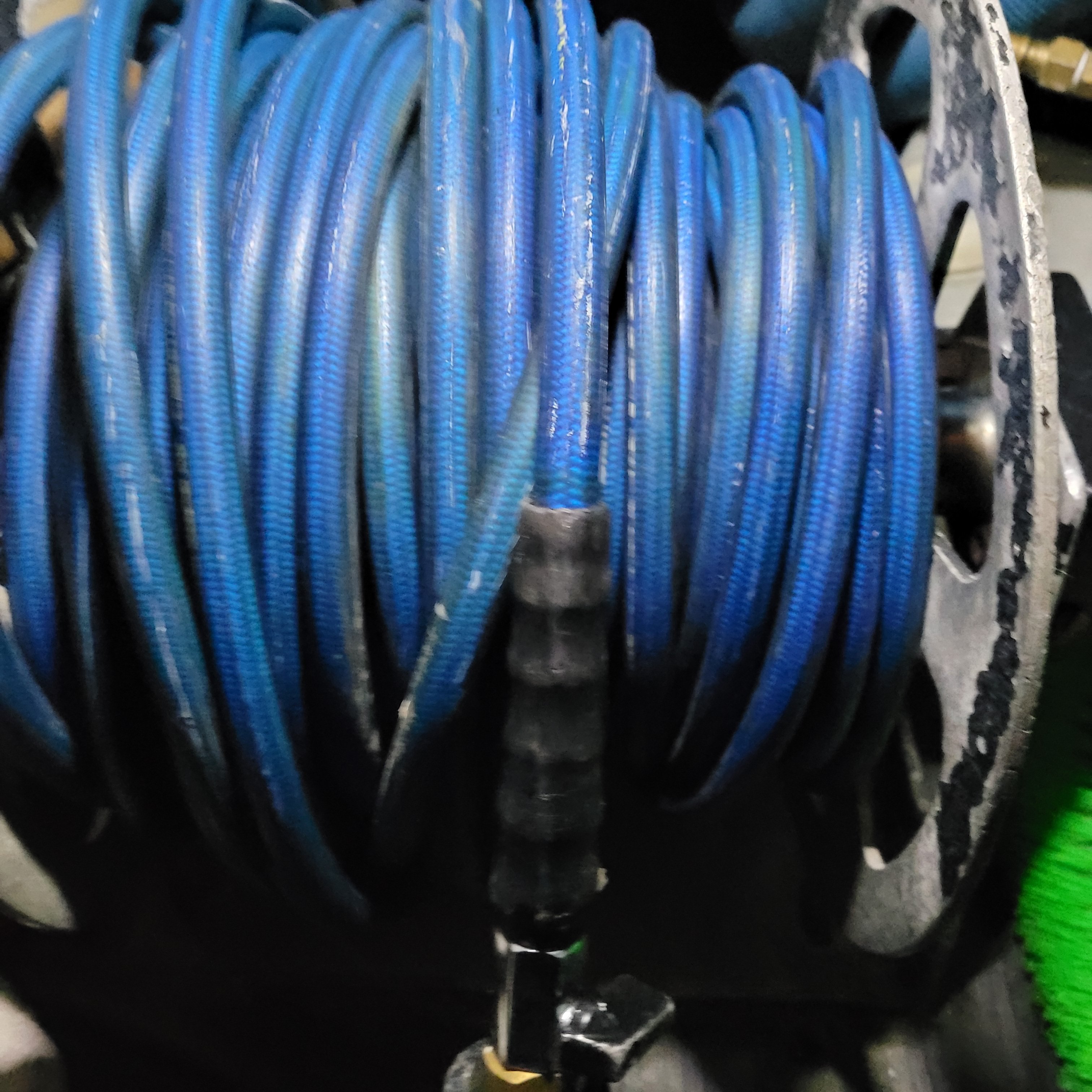

View attachment 121567 View attachment 121568 View attachment 121569 View attachment 121570 View attachment 121571
Thanks for thoroughly explaining the differences between the two types of hoses.
Yes, I remember seeing those pictures before and have read about your method of keeping them clean .I avoided purchasing hoser for a long time, but maybe it's time to invest in
" presentation." Dragging dirty hoses through the customer's house is nothing to be proud of.
I have blue Amflex hoses with a black inlay; just like you said, they're still smooth on the inside, except that debris is being caught on the edges of the cuffs( I should switch from Mytee plastic cuffs to vinyl or go with better quality like a Cool cuff.
Thanks again !
