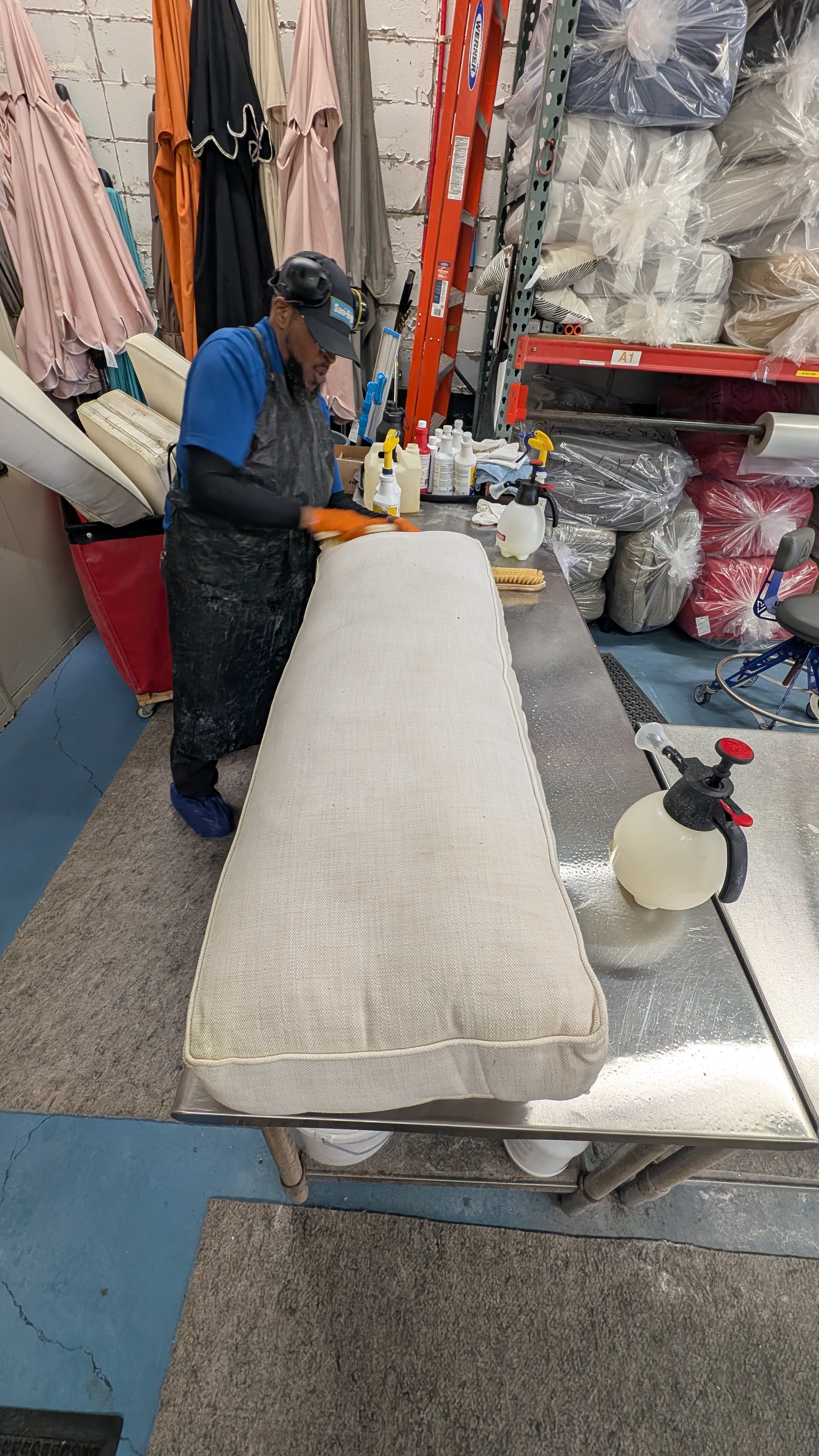

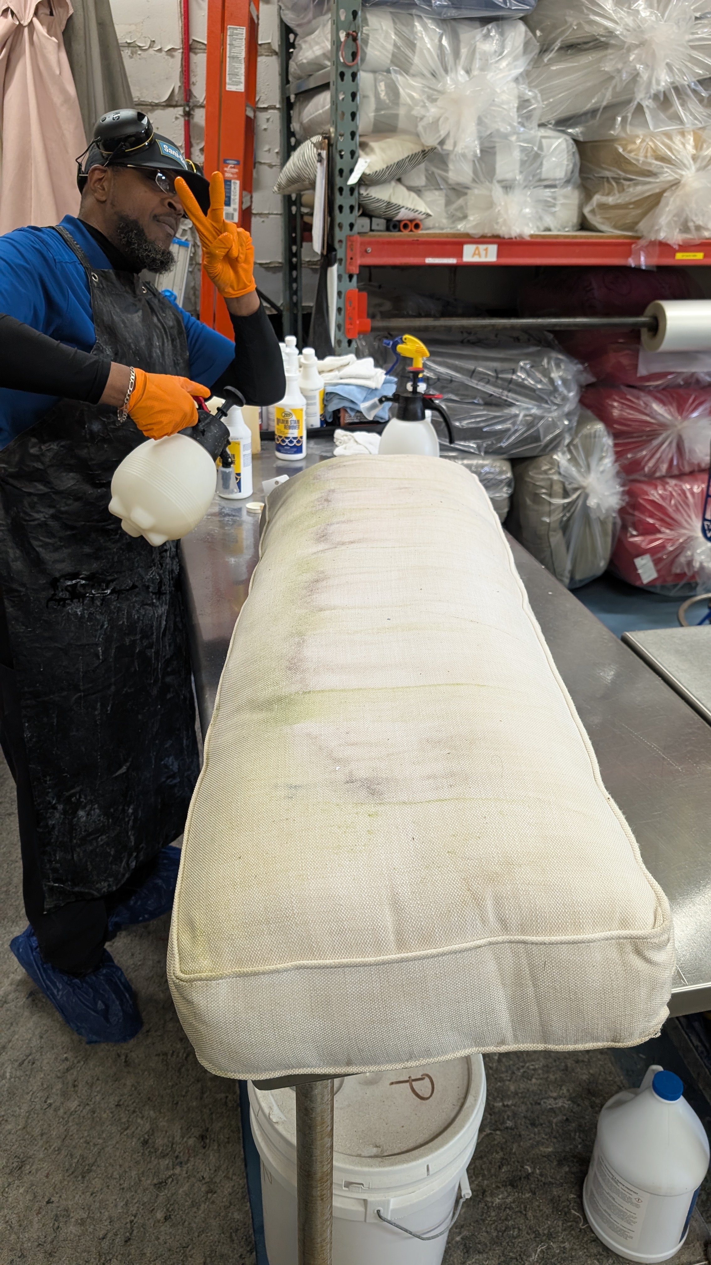

Zep mildew stain remover. Miracle in a can
115,920
Pre vacuum
Pre rinse
Apply enzyme cleaner
Rinse
Apply Zep
scrub
Dwell
Rinse
Repeat Zep if needed
Rinse
Dry

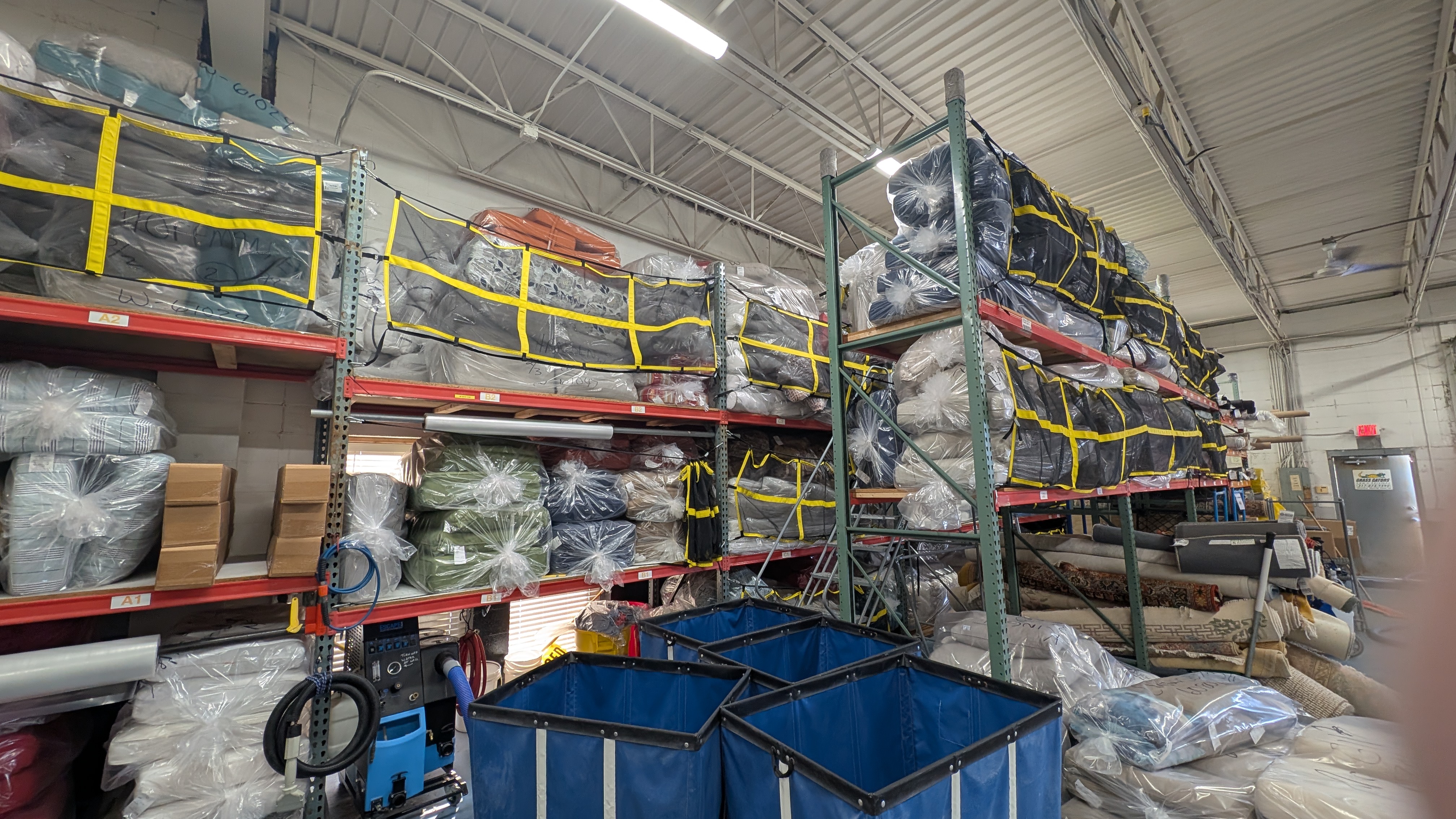

Sani-Bright does a ton of patio furniture
12,558
This is a growing field, and it seems a number of plants are embracing this.
I'm not surprised to see Sani-Bright at the head of this in their region. I'm really glad the King family has been doing so much to help out with the RMHC event in Indianapolis too. Jordan and Tom are good people.

Oxy encap here for the win , spray on use a hanD bonnet and extract
Nope. I’ve used straight peroxide (a very high concentration; 20%), and used straight DS2, no dilution. First used an upholstery bonnet, then to a stiff scrub brush….
It was used in that fashion, because I was desperate to see an acceptable end result. It did not work.
Diluted oxy-encap would not take care of moderate to severe mildew….
I finally got good results after using ammonia and Fels of all things, scrubbed with a stiff brush.
